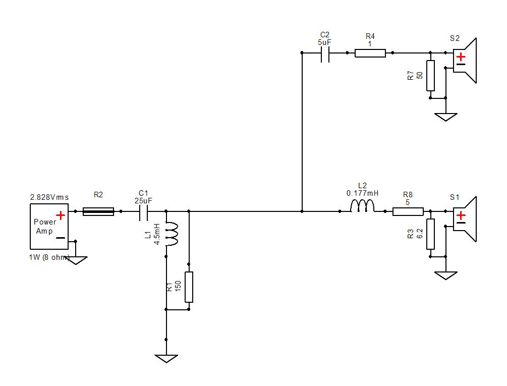

After inserting the series resistor to both drivers and removing the parallel choke on the T500 I notice my SIT1 running MUCH cooler.
I have to assume I was making the amp oscillate?

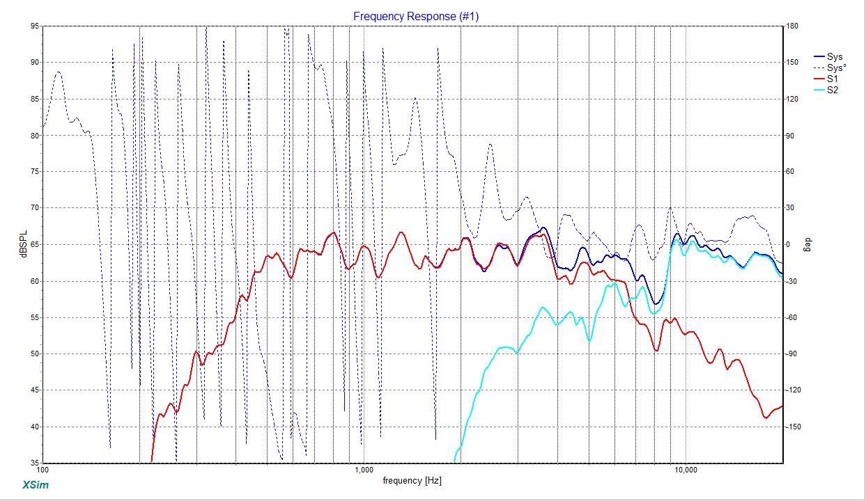

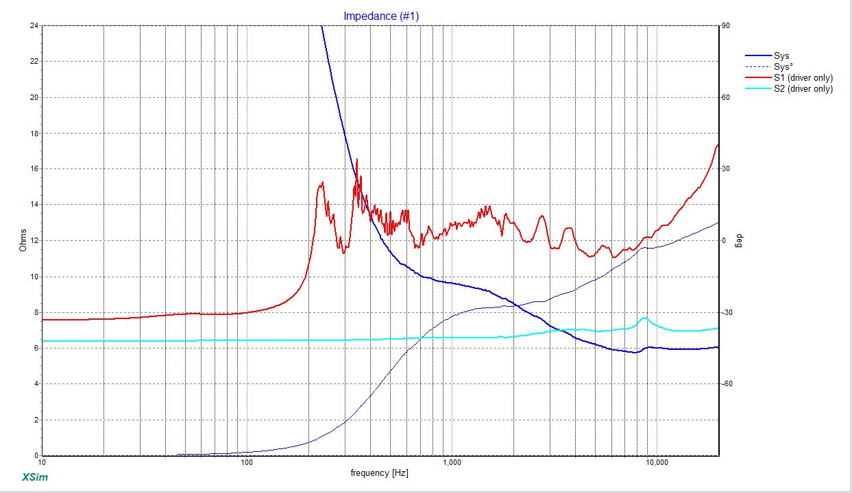

Here is where I am with it today!
i figure the high frequency dip is more of a room anomaly since it appears in both drivers.
