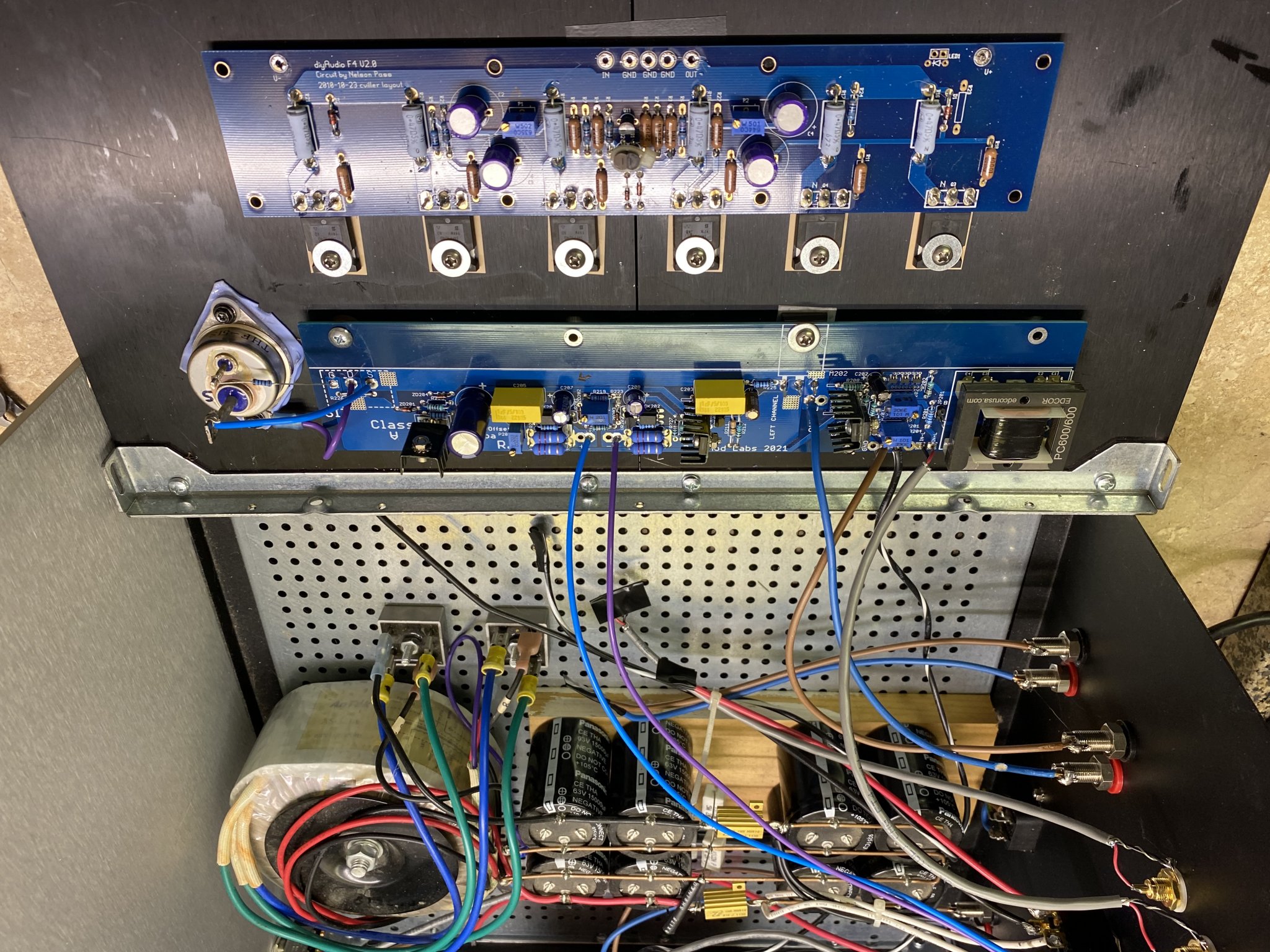

I know I am late to the party but I finely got the kit together and in the case. It fired up up perfectly the first time, it just took a looong time for the current to start to come up but once it did everything is right in. I am a bit leery about the blue silicone pads I used to mount the SIT. They are awful squishy and I was afraid to compress it too much, might look for something better. But as it sits with the current up to about 180ma the temp at the case is about 72c. I am a tube guy so I am not sure how hot is too hot.

if it's 72C on SIT case, then you really need to find some other thing to put as isolator
it'll endure that, but it's really pity to torture it that way
Conrad.de is having Keratherm 86/82 sheets, Boyz did found some special made Alumina oxide pads, and there must be (somewhere) mica sheets
heck, even gray squishy pads are better than that bluish thing
I finely got some better insulators for the SIT and now my temp is about 47c, a very dramatic improvement. I will not waste my time with the blue stuff again.
