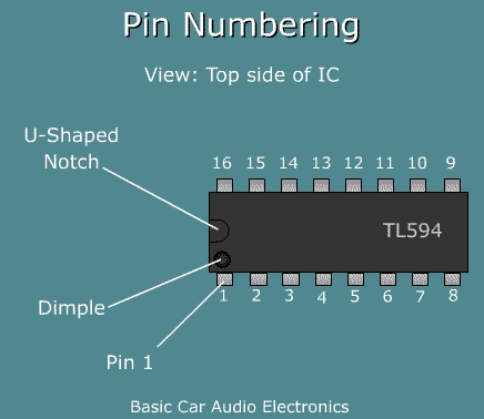

Is the amp completely dead or going into protect? If it's completely dead, post the DC voltages on the driver IC (TL494?).

Does it produce rail voltage?
If not, post the DC voltage on the TL494 (594) power supply IC.

he also wanted voltage, compared to gnd, of every pin of TL, check schematic, I think you can see were led is connected to

I will measure TL 494 for you all 16 pins🙂
