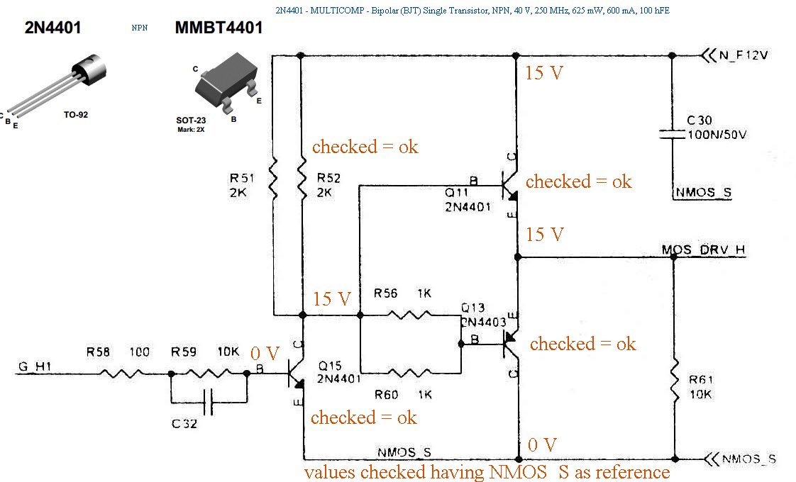

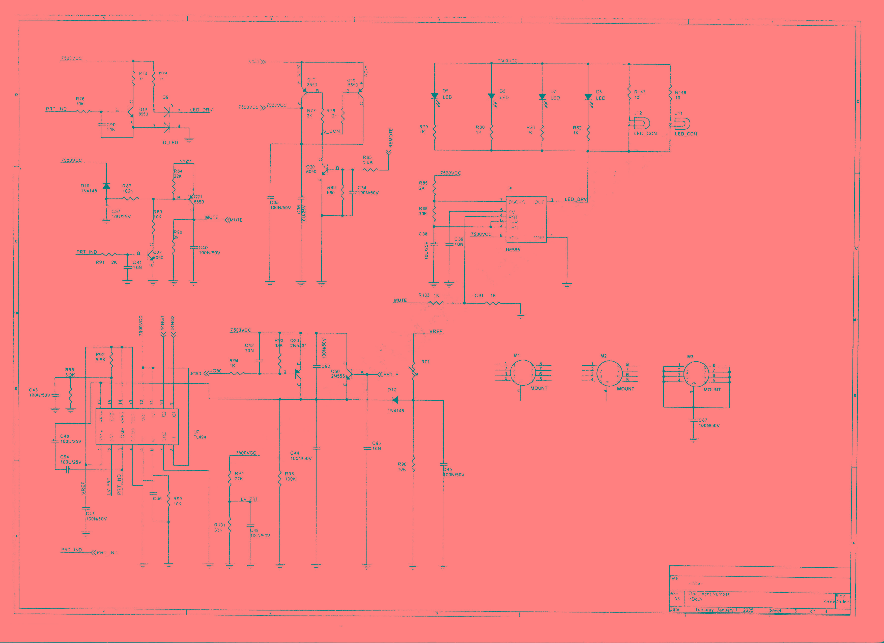

Hello ! Pls help regarding a SL-A1500 driver "paradox" , all IRF 640 are ok, all gate resistors are ok but on power I have + 70 V on speaker output (no protection on red LED , blue LED switched on after initial checkings !) due
Q11,Q13,Q15 act strange (all checked = ok) on attached diagram I have 15 V on "MOS_DRV_H" , I've suspected Q11 but Q11 is ok.
If Q11 is out, still have 7.5 V on "MOS_DRV_H" (from where ???)
I think it's a pure DC situation here, somehow 15V comes from "nowhere" ... Checked all diagrams and saw that there is no other way to have a 15V DC on MOS_DRV_H point but through Q11 (or R51,R52 - but resistors are ok). And Q11 is ok. It is something I missed ?

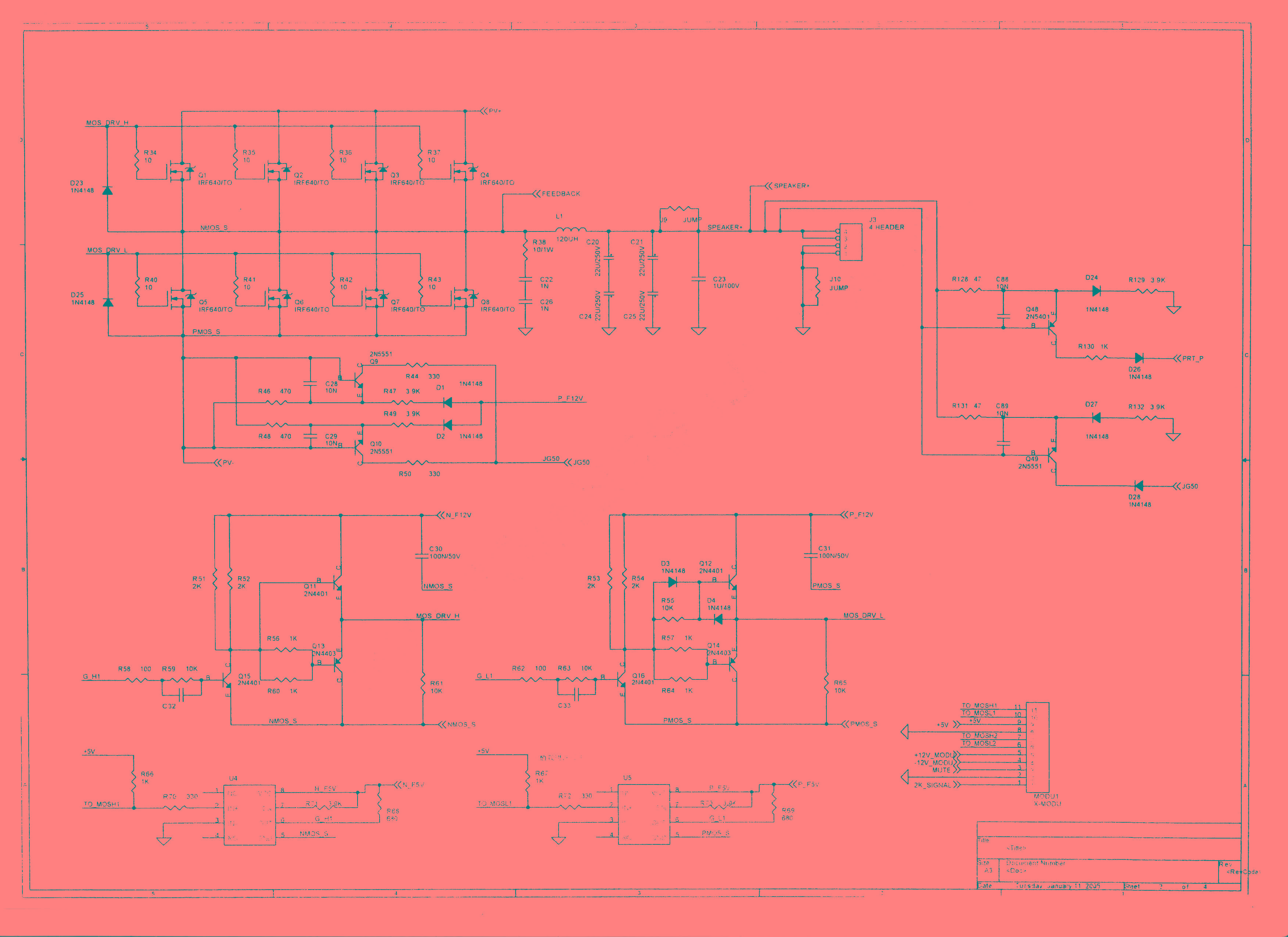

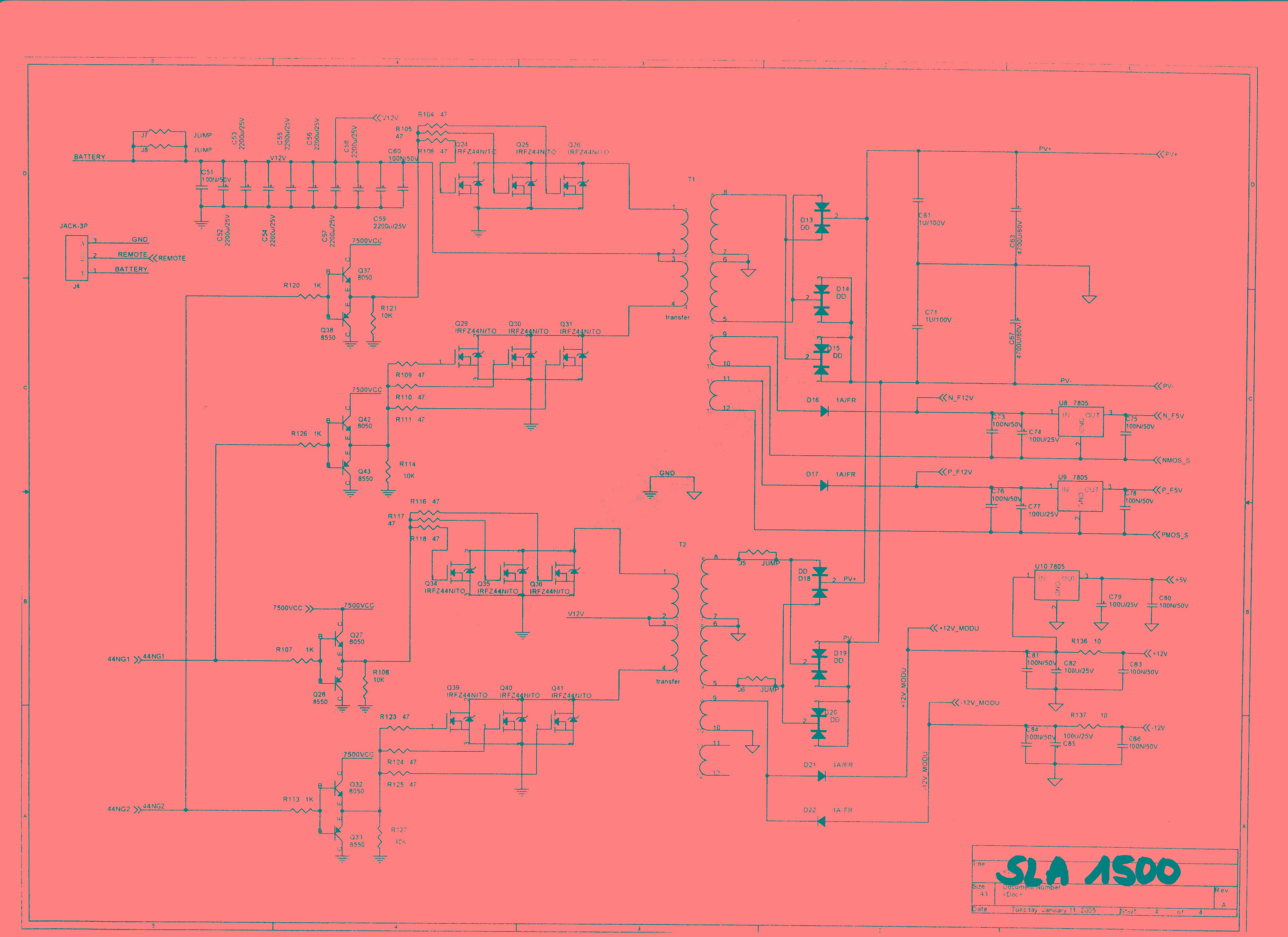

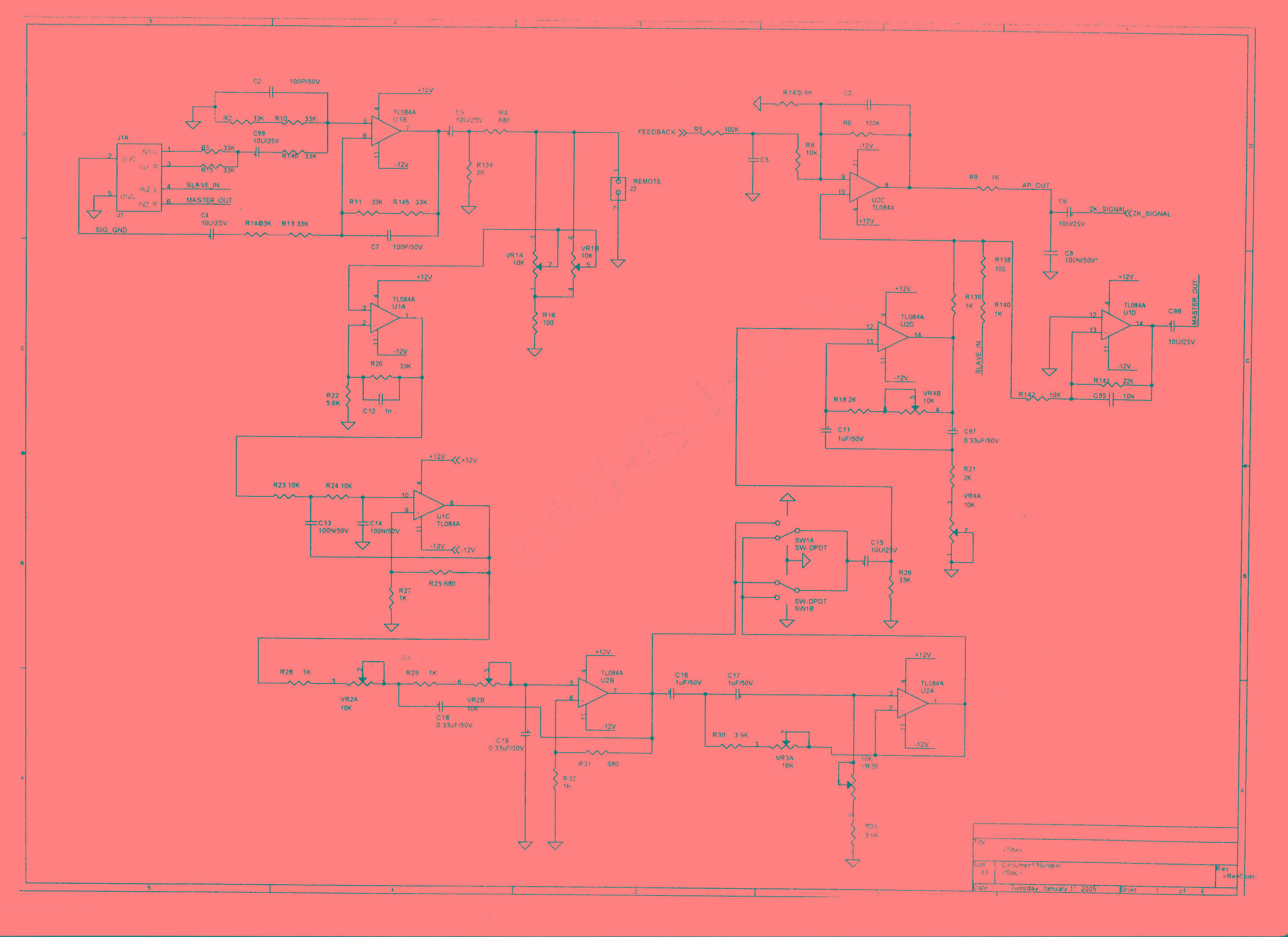

I will borrow an USB- PC based scope. Altough , for my kindly understanding , if after rectifiers I have correct DC voltages , as per diagram , AND incorrect DC voltages on driver output (15 V DC as explained above) , shouldn't I dirrect my attention on a DC problem (like - by example - a defective polarisation on driver's transistors or smooth defective transistor - unlikely to be easy detected) ? I only wonder where from the 15 V DC can appear on one of driver's outputs (the MOS_DRV_L is ok = 0 V, only MOS_DRV_P is defective = 15 V continuously) - on page 4. I will attach the 4 pages of service manual.

Correction : the MOS_DRV_L is ok = 0 V, only MOS_DRV_H is defective = 15 V continuously.
Pls be more specific , if all rectifiers will be removed and rail capacitors discharged it would become a passive circuit, wich signals exactly to be traced , from where to where ?
Update status:
_all 8 IRF 640 disconnected (all are in good condition)
Problem 01: _unfortunatelly , when powered , no signal passing the drivers - so I have also a problem with preamplifiers / drivers - I will work on it and revert with details concerning input
Problem 02: (the old problem) MOS_DRV_H = 15 V DC continuously - strange because Q11,Q13,Q15 are in good condition - here I am stuck

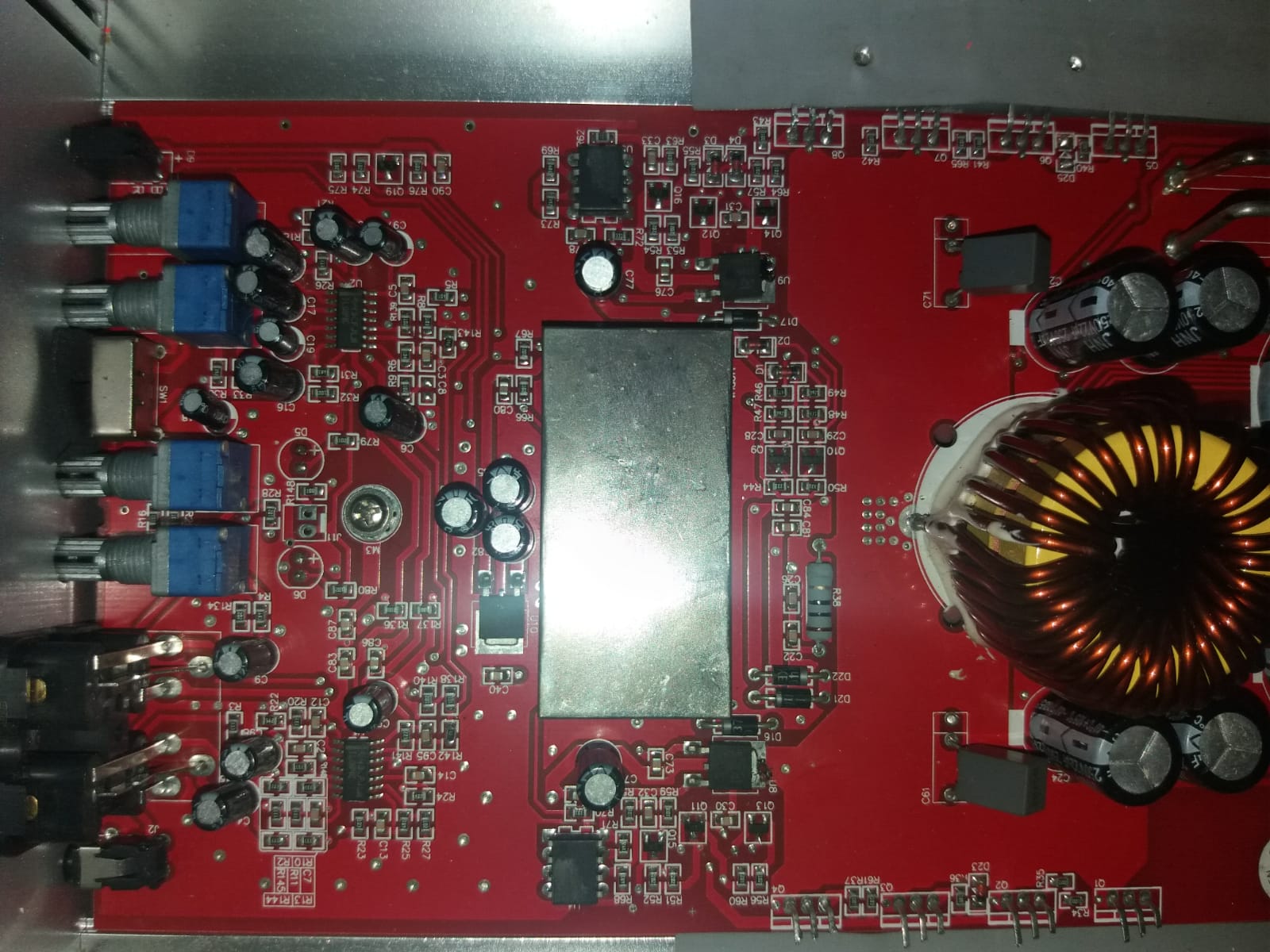

also , pls help with U4,U5 ...
U1-TL84C:GENERAL PURPOSE J-FET QUAD OPERATIONAL AMPLIFIERS U2-TL84C:GENERAL PURPOSE J-FET QUAD OPERATIONAL AMPLIFIERS U3-can not find , maybe in shielded box MODU1 U4-integrated circuit is factory (?) polished, no mark on them … can’t find a datasheet … U5-integrated circuit is factory (?) polished, no mark on them … can’t find a datasheet … U6-NE555:Single Precision Timer U7-TL494 : SWITCHMODE PULSE WIDTH MODULATION CONTROL CIRCUIT U8-7805 U9-7805

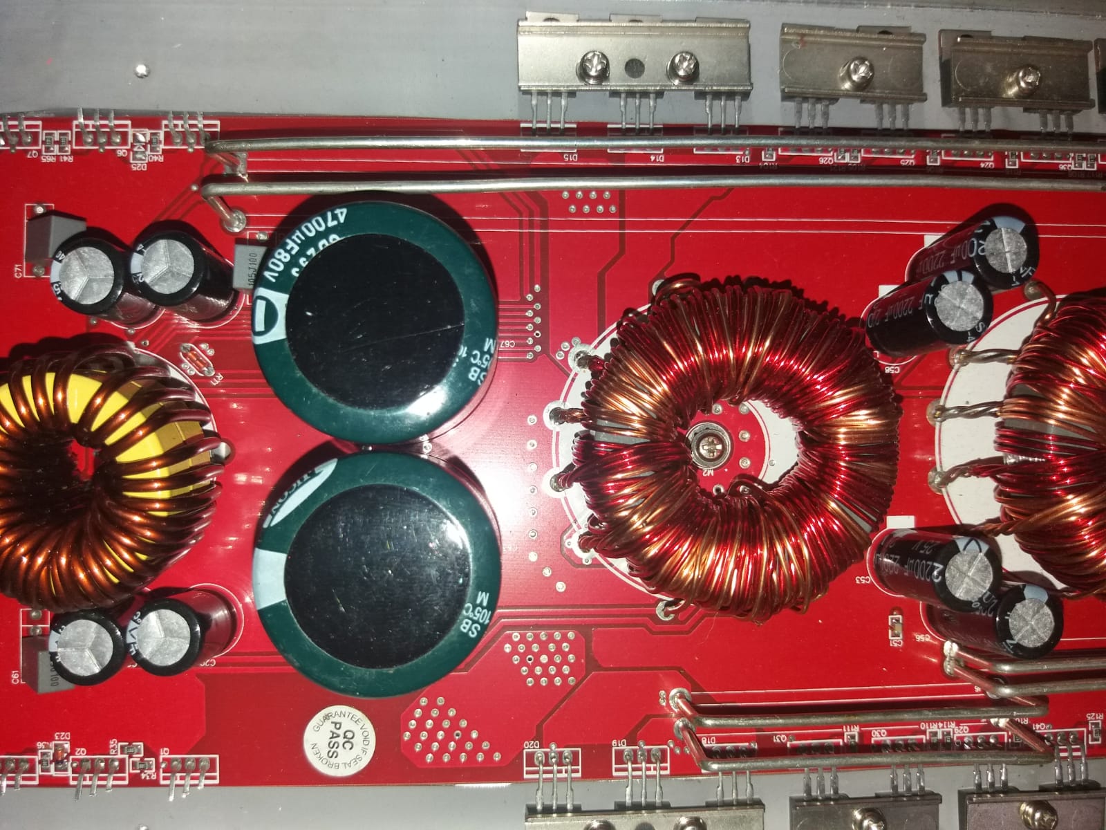

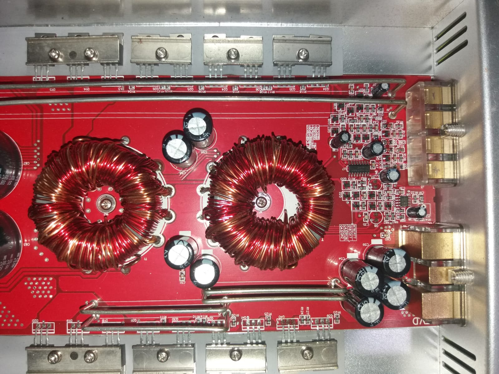

No problem on my switching power supply, I have sharp ± 80 V on capacitors. If rectifiers will be removed, nothing to be checked on active amplifier part - where the problem is. Audio driver board is shielded - not as I saw on same internet sinuslive model. See attached photos.

Did you try pulling the cover from the driver board?
Did you confirm that the driver board has all of the required supply voltages?

# try pulling the cover from the driver board - not yet, neither considered at this moment
# driver board has all of the required supply voltages - ± 12 V , confirmed
