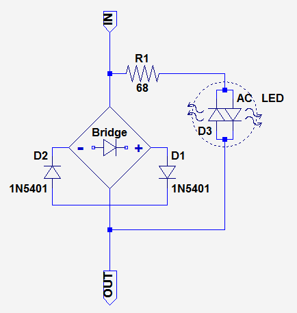

In order to cover a wide range of currents, a non-linear element is required, in practice two or more back-to-back diodes.
The dumbest of current sensor built according to these principles would look like this:
attachment.php
It will work, but its main drawback is its voltage drop, around 3V, translating into 2V rms: that is ~1% of the voltage in a 230V system, barely tolerable, and 2% for 120V: really problematic, and if the load takes a number of amperes, the dissipation will become an issue.
One of the 1N5401 could be omitted, but the control of the current in the LED would become acrobatic.

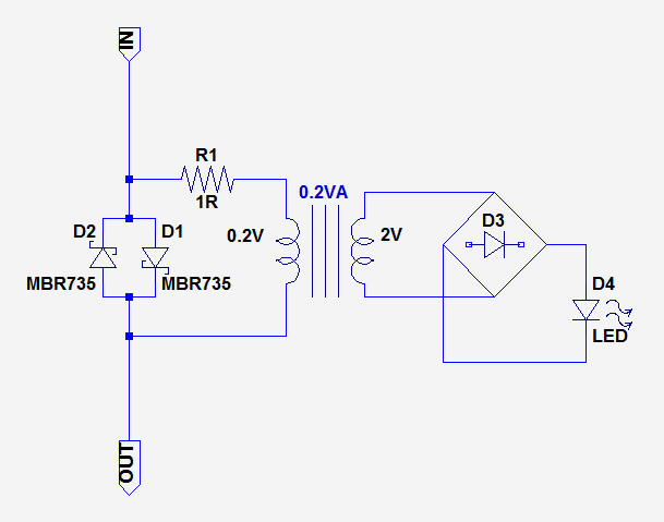

The circuit could be improved by adding a small transformer: in this case, a single pair of diodes is sufficient, and they can even be schottky's:
attachment.php
This solution neatly addresses the losses issue, but where are you going to find a 0.2V to 2V, 0.2VA transformer?
It will be a custom part, and a relatively bulky one: not very attractive.

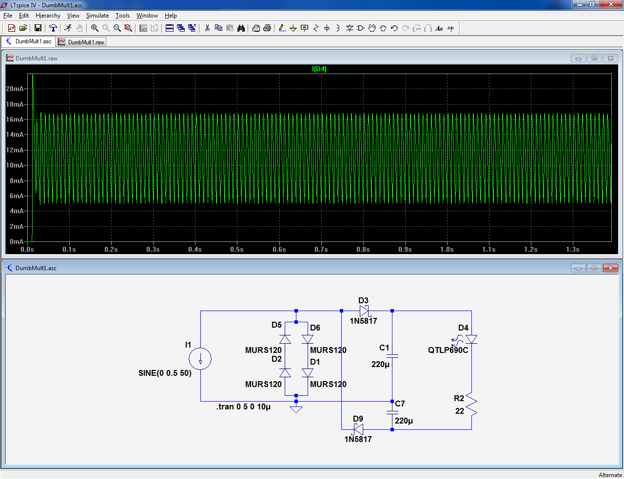

A more attractive option is to resort to voltage multipliers: you can use the threshold voltage difference between ordinary and schottky diodes to obtain a sufficient yield:
attachment.php
It is a reasonable tradeoff between complexity and losses: typically less than 1V rms, and the components are off-the-shelf commodities, it is thus a possible and realistic option.

What if two diode drops in each direction is too much?
You could use just two diodes back-to-back, followed by many stages of voltage multipliers to drive the LED, but that's an uphill struggle: to begin with, the threshold difference between schottky and ordinary diodes is not huge, and each multiplier stage adds its own loss.
This means you end up with half a dozen schottky's and half a dozen big caps for a miserable result.

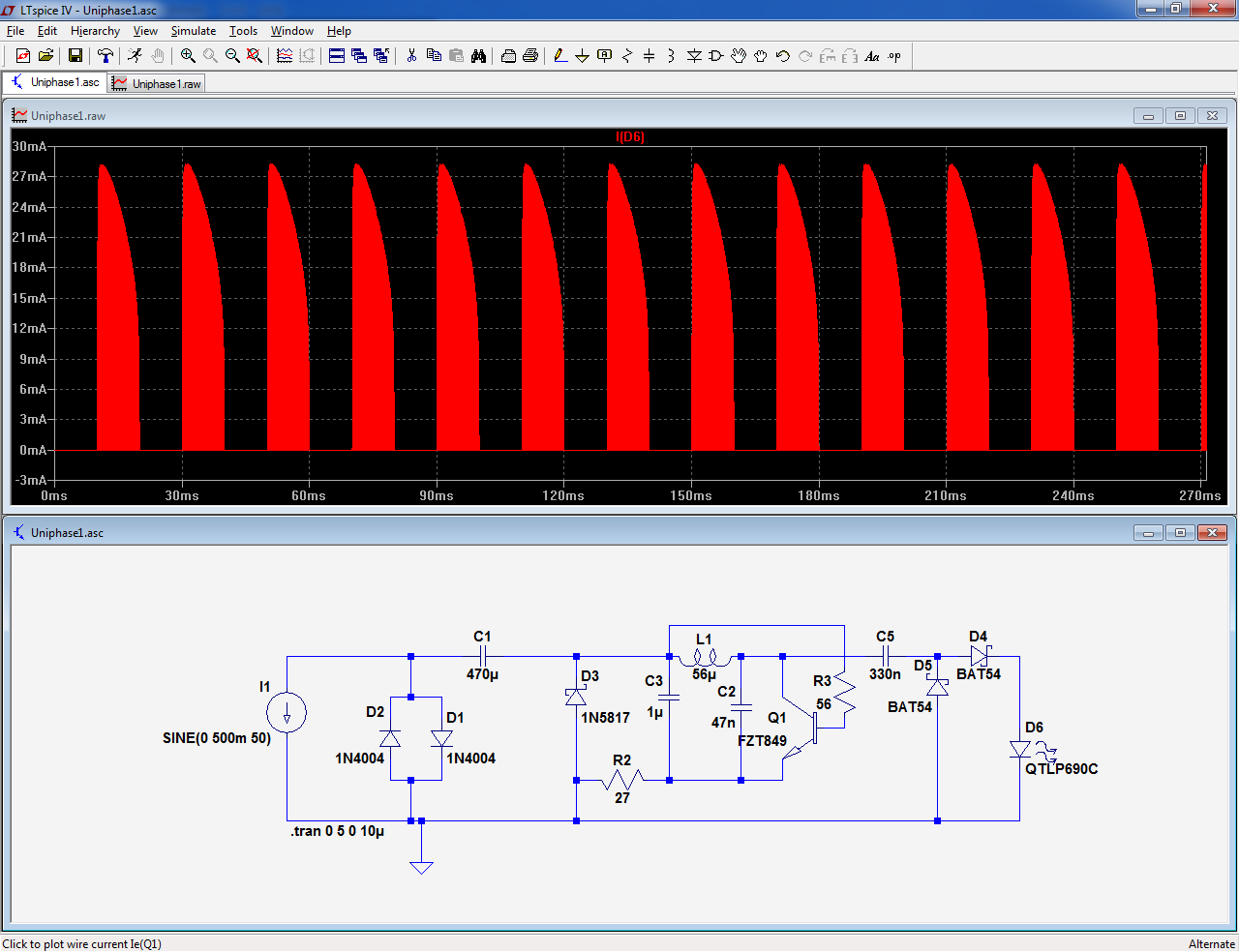

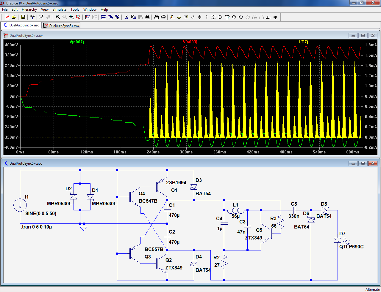

Fortunately, there are better options: converters. Unfortunately, true converters are either inductively coupled (Hartley type, think Joules thief) or driven (two stage, etc).
Using a custom wound component, Joule's thief style, or multiple transistors or a dedicated IC is not appealing, so what's the alternative?
It is possible to make a converter's substitute using an overdriven Colpitts oscillator.
It doesn't come near the alternatives regarding the boost ratio, efficiency or current output, but with high efficiency LEDs, it is quite sufficient, and requires only ordinary, off the shelf components.
Here is an example of pilot using such an oscillator:
attachment.php
The transistor shown is a FZT or ZTX849, and a superbeta transistor does indeed work better, but alternatives like 2N6702 or 2SD571 are perfectly sufficient

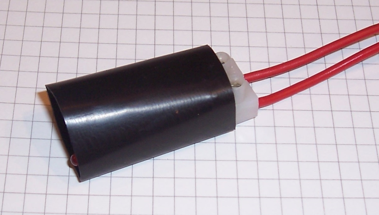

When I began developing the concept, several years ago, it was driven by my attic lighting: the switch had no pilot light, meaning the light would regularly be forgotten, and burn needlessly, sometimes for weeks before someone realizes.
The wiring inside the switch-box had no provision for hooking up a regular neon pilot, meaning I would have to lay a specific wire, pulled from another location.
I thought it was more elegant and less intrusive to keep everything in the condition, and add this small pilot in series with the switch.
It worked like charm, and this gave me the idea of applying the principle to other problems: you can for instance monitor the activity of such a pump:
Or it can let you know when one of your PIR-activated light has "seen" something or someone:
Motion-Sensor-LED-Solaire-led-d-inondation-lumi-re-60-Led-En-Plein-Air-clairage-PIR.jpg_640x640.jpg
etc, etc.
In fact, it is so convenient that I sometimes use it even when a regular wiring is possible. Why? It is simpler and faster.
Note that it is not limited to indication only: the LED can be an optocoupler and drive some management/control system.
Back to the subject.

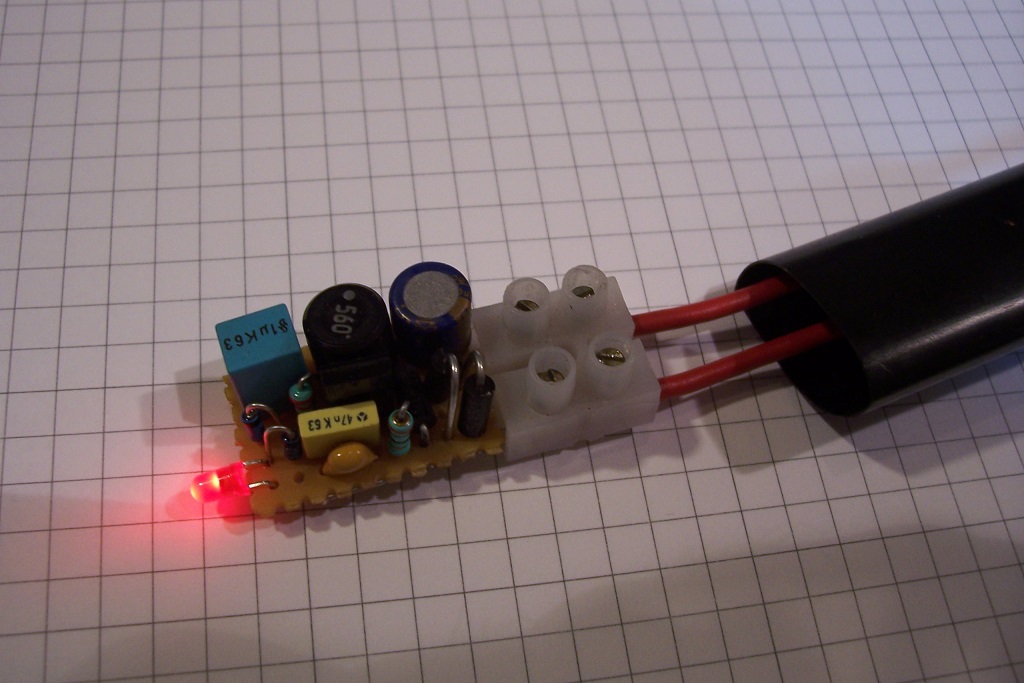

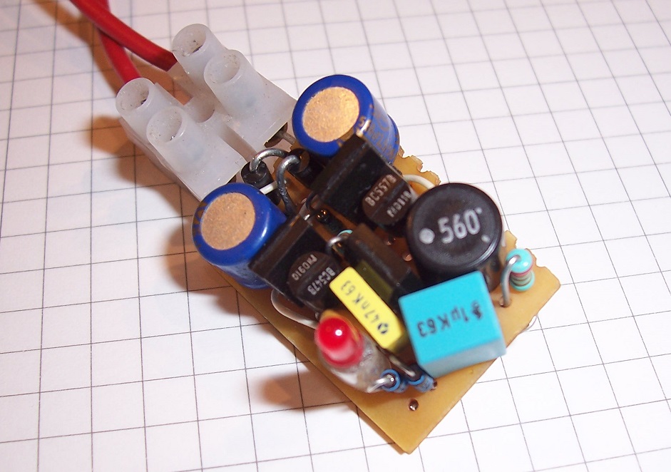

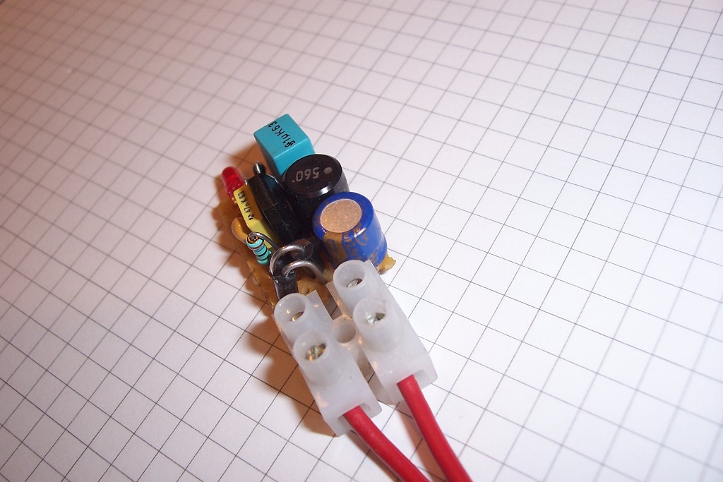

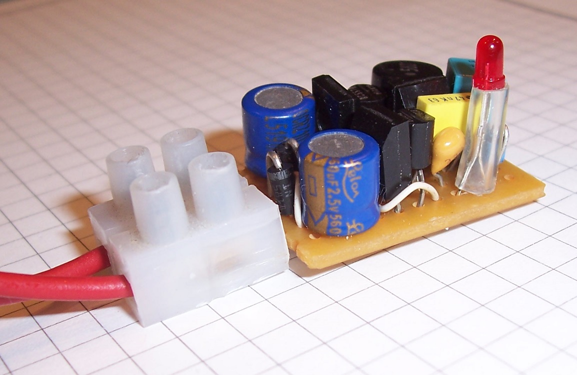

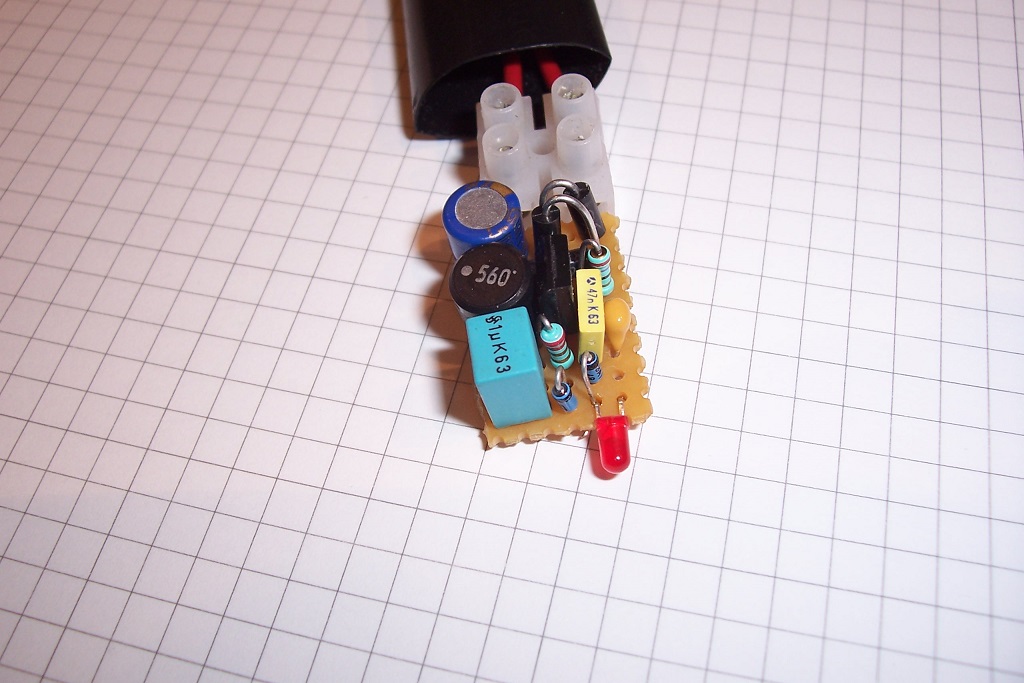

Here is an implementation example of the last circuit.
The LED color is preferably red, for forward voltage reasons. However, standard green or yellow remains possible, but not blue, white, etc.
PS: you will note that there is no "mission critical" in sight: it is just comfort and convenience

If you are thinking about a small transformer, why no use a small current transformer?
Or the smallest toroid you can find?
This was my 1st thought too..
Current transformers have volt*second constraints so the secondary voltage must remain small due to small core and low mains frequencies. Something reasonably sized for cost will have voltages perhaps less than a forward drop of PN junction diode. Although there is no requirement to keep the transformer linear so it might be 2-3 times higher Volts*sec than spec.
PRR
Joined 2003
The $3 parts from Triad are rated 4V on the secondary, at power frequency. Ratios from 1:17 (1A) to 1:500 (30A). Some thought needed to match a V-limited current output to a steady-V max-current load, but I think an answer is in reach.

Very nice find indeed, compact and inexpensive, and the 1:16.6 one is practically the same as the one I indicated here:
651809d1513619900-single-wire-pilot-lights-isens1-png
0.25VA and a ratio a bit larger, but it's not critical at all.
Since the secondary is isolated, the LED could be located remotely using low voltage wiring.
I had looked for such a part years ago, but the size and cost were horrendous.

The previous variant contented itself with one diode drop in each direction, but the diodes had to be ordinary silicon, to allow the indicating oscillator to start.
Schottky diodes would reduce the losses further, but how could they be compatible with a silicon-based oscillator?
This circuit generates two polarities, and uses the opposite polarity to generate the drive to synchronous rectifiers.
Once the circuit has started, its operation is obviously possible, but how can it start?
attachment.php
Small schottky's D3 and D4 "prime" the circuit, by allowing a small voltage to appear across the filter capacitors, then a regenerative process begins, with each output voltage gaining more and more strength at each cycle, until full lock-in happens (red and green traces).
The Vbe is a purely fictitious notion, and can become arbitrary low for very currents, which is illustrated here.
All the detectors described will operate from a few tens of mA up to twice the If max of the diodes used as a shunt.
If a threshold is desired, to make the distinction between the active and standby conditions for example, the diodes should be shunted by a suitable resistor

One last word of caution: if any of the above circuits is used for mains applications, you need to observe all the relevant precautions: good construction practices, proper insulation and distances, etc.
This also applies to the transformer based one: all of the primary side will be live, and without precautions, the secondary also has to be treated as such, even if the transformer has the required certifications.
Note that LEDs do not provide safety insulation: they cannot be inserted directly into a metal front-panel, there has to be some kind of additional insulation; the best technique is indirect lighting, through translucency.
The light output with high efficiency LEDs is sufficient for that.
