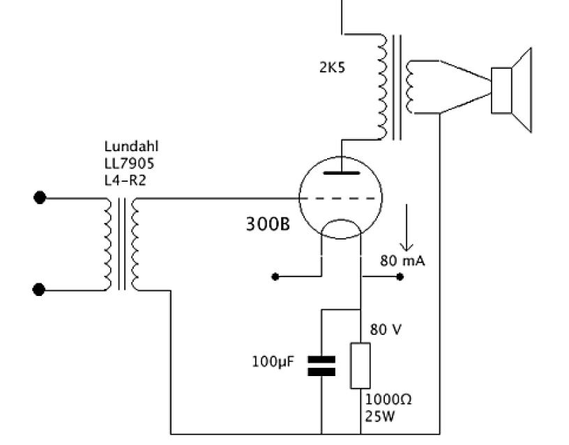

the idea was one tube and one tube only
I like this 🙂
better 20a/30a for dht driver .....
send me mail I have nice pdf with lundhal at input 300b one tube

Here you need a PP input transformer, what you have drawn will not work with unbalanced RCA inputs.
Note that you will have one heck of a time driving the miller capacitance with a transformer.
You would need something like a 1:10+10 or 600:60K+60K to drive this, and this would most likely have to be a custom.
All I can say is buy a couple of these tubes and (carefully) build something!
Were it me I would choose a JJ 300B or a PX25 over this tube for an amp any day, however the mu of these types is too low to use a transformer step up.
This would be great as a driver with a choke, CCS or resistive load with a bigger power tube like the 845 or GM70..

I recently had this amp build for me based on this tube using a step up transformer using the Lundahl LL7903 mic step up transformer. Ok, this was not a tried and tested proven formula but the idea intrigued me and I went ahead with it.
Anyone going for this build should not attempt so if using an input transformer for driver duties. Kevin was right that due to the Miller Capacitance of this tube, using so of this topology introduces nothing but severe distortion not to mention lack of any drive or decent volume to begin with. Not to mention introduction of more veiling to the sound. This is the first time I have had an implementation of an input transformer for any amp I had, maybe its the wrong tranny, what Kevin suggested of a 600:60k + 60k configuration that Sowter in UK offers but even then so can this even work in the first place?
He offered to help look at the circuit to correct it and while waiting and from ideas that he hinted here as well, I decided to put an active tube driver stage at the front and incorporated JEL's 76 DC 6SN7 CC driver stage in front of it to drive the grids of the EML 20B directly, not using any input tranny for any step up.
Remarkably this yielded a very decent sound with significant drive and one of the most airy and natural highs I have heard from many different DHT out there. The clipping distortion that I had earlier has disappeared completely with this implementation!
The tube is currently catahode biased but am expecting news from Kevin for further suggestions to make this better but he is right, using a tube stage in front of it is a much CORRECT method to drive this tube in particular.
Not a lot of bass from this tube not sure if its anything to do with the circuit topology I have adapted for it but am on the Hashimoto H20 14U OPT using the 14k primary impedance for this highish Rp tube, but am surprised how remarkable the high frequency response is on this configuration. But low bass response is not a trademark of this tube or this amp I have now, am currently using an REL 12 inch sub to fill in the lows, am seeing a severe lacking in anything below 80Hz.
Its funny how I had to profusely look at the whole thing and modify this to correct this in particular. Only thing good about this amp is that its remarkably quiet, perhaps the quietest I ever heard of any tube amps, absolutely no background noise, not even a hiss! Perhaps its because of the use of Rob Coleman's DHT heater modules that he configured for this project, using a CLC configuration before that using individual heater trannies may have something to do with it but else the voltage is to 2 decimal points stable when measured on my DMM.

This sort of circuit works well if you use the right tube to achieve the result. The E55L is an excellent candidate ( I have built one with an input choke using step up of 1:2). The choice of valve you have made seems far from ideal.
I also agree that an input choke will only work with a very meaty preamp - mine works with a 5687 in PP driving a step down transformer but it also works well with a SLCF preamp.
Basically, asking an input inductor to do your voltage gain is asking for trouble unless you have designed your whole system around the concept.

Shoog is correct.
You need a real high gm tube (I'm talking about 30mA/V and more) to get sufficent anode currents for speaker driving. Second, use a pentode ! I tried it with several paralled trioded PFL200 which resultet in an input capacity of about 2.3n thanks to miller effect. Sounds nasty. Next try is to use an input transformer, pentode mode and some pos+neg feedback to get the high output capacity down again. If everything fails, I will use triodes again and use a little sourcefollower direct coupled to the grid.
Depends.
Grid-anode-capacity times amplification yields miller capacity per tube. This capacity tells you the 3db rolloff.
If you use a transformer in front of that you can get ringing etc.
Try it out, send a square wave through it and see how it behaves.
But the biggest problem is oscillation due to the gigantic gm you get. With values over 100mA/V you have to use ferrites and little unbypassed cathode resistors. Just a one inch wire on the grid and you built a powerful >100Mhz oscillator.
