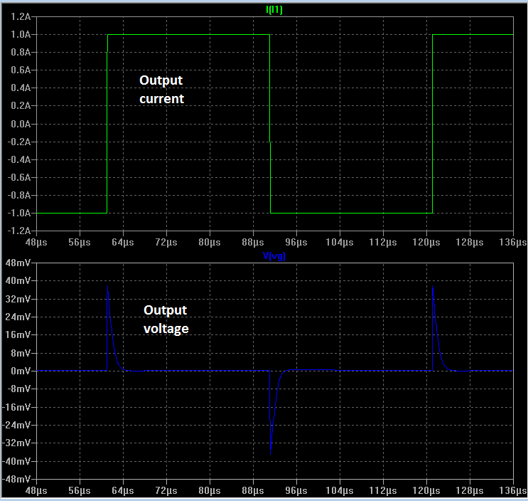

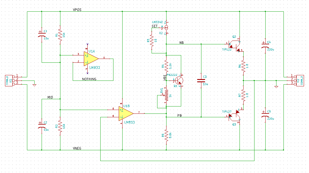

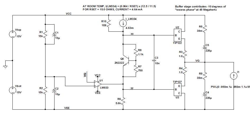

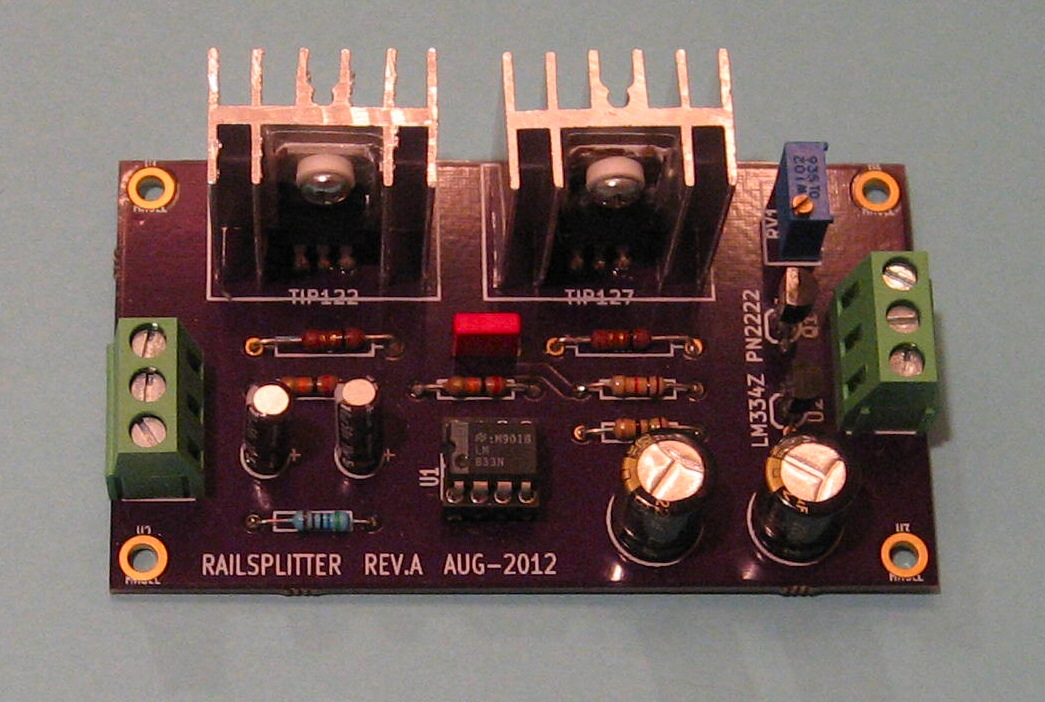

I built a virtual ground generator / "rail splitter" last year. Mine used TIP122 / TIP127 complementary Darlingtons in the output stage, and is designed to deliver ± 1 amp load current to or from the virtual ground. Schematics and LTSPICE simulation are attached; you'll see that I used the LM833 opamp, whose GBW product is 10 MHz.
I ordered several boards and many sets of parts, so, as it happens, I've got an extra unit, fully assembled and tested, which I'd be glad to give you for free. PM me with your (North America only, sorry) mailing address and I'll send you the board. Then you can try it out to see how well you like it in real life, with your music and your other equipment.
