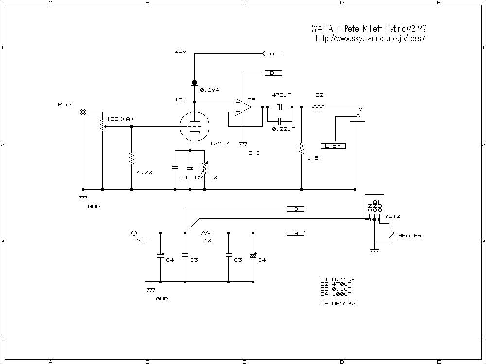

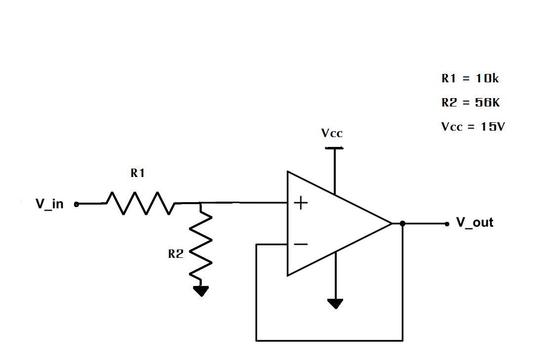

Hello, I'm trying to design an output stage through an opamp as voltage follower. Since I tried some simulation with LTspice too, I wondered which of these was better. The first one seems rather atypical (though it works), while the second is the classical single PSU for an opamp, with the half Vcc superimposed to AC signal.

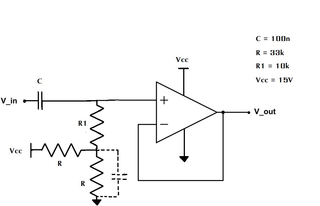

Anyway, the question raised because I got ideas from this h.a. schematic. The opamp figures as not for a single supply operation, in some way is directly biased from the VAC of the tube, but I can't say if this schematic is a simplistic form.
