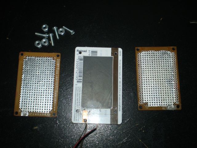

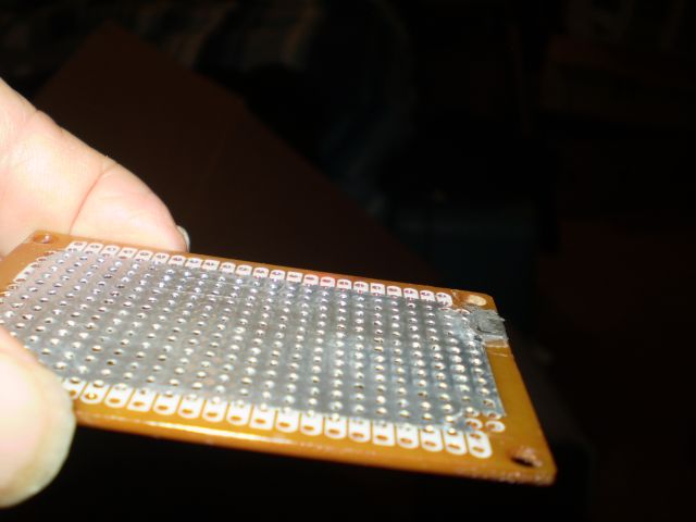

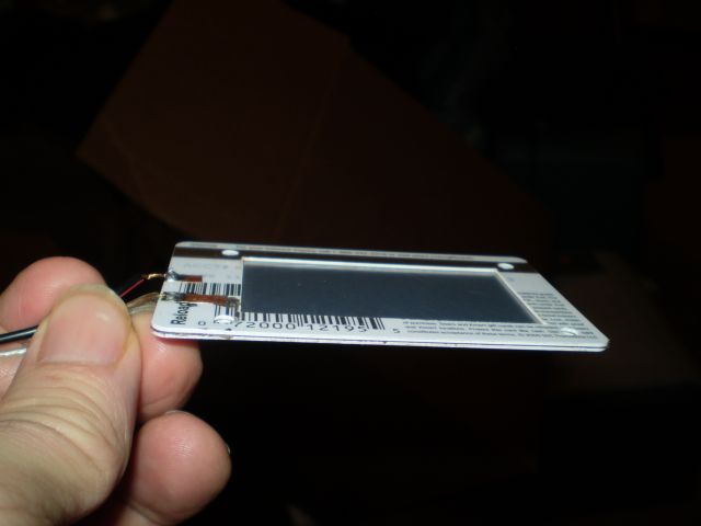

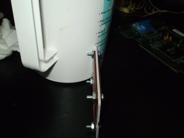

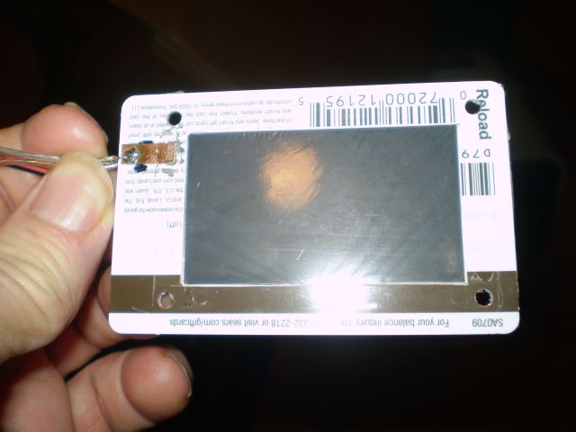

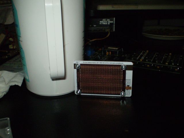

Yes I used some Gift Card credit cards for the frame.
The diaphragm size is 59mm X 44mm and the D/S is .0325"
The diaphragm material is some .1 mil mylar that I got from Chemplex Cat.No: 100 .
I also have some .06mil stuff from them as well but i haven't tried it yet, Chemplex Cat.No: 090 .
For the coating I used Licron this was before I had gotten the Crystal formula which is more clear and much much thinner than the regular Licron.
I ran about a 500v bias on it from a tube amp chassis that I had laying around and I used the transformer in it to drive it as well.
I don't know off hand what the turns ratio was but it was a OPT for a pair of EL34's.
I didn't mess with it for very long and I only made the one.
I ended up taking it apart for the pictures But I still have it and it can be reassembled at anytime.
The sound was very good and clean and it got to a nice comfortable volume.
I didn't have a SPL meter at the time.
I was amazed that when there was bass there was bass and was not boomy at all.
At first I thought that it lacked some high end but it was the Youtube video I was listening to that was poor in quality.
I had found other material that was much better and I had not noticed this before until I was listening to this driver.
Getting back into this hobby after 7 years it was the first driver I had running and then I finally got my little ESL panels going about a month later.
Yes when you are right on the diaphragm it will have a flat response.
As you back away from it you will get a rising response at about 6db per octave.
This true for any dipole driver.
