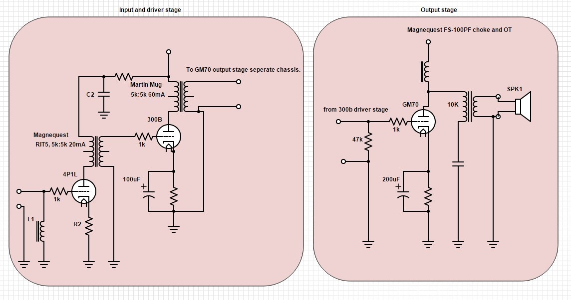

Now that it seems feasible to build the output stage separately, as I was imagining, then I'll probably be trying higher voltages on the 845 sooner rather than later. It was the idea of adjusting the values of the input/driver stage components every time sizeable increases in B+ was made was what was making me weary.

Hi,I'm in the UK as well, and I think it's a brilliant idea. Keep all the high voltage in one chassis and once it's built, forget about it. Mind - two things:
1) There are alternatives to 845 like 813 and 814 - look up that one on Ale's site, he's very pleased with it.
Bartola Valves | All about electronic valves and hi-fi
2) You can use less than 1,000v depending what output you want - there are plenty of designs using "low voltage" tubes like 845, running around 650v. You have the option to experiment as the output stage is in one chassis.
I did exactly this with my 4P1L PSE amp. I put the output stage and PSU in one chassis and the input stage with its own PSU in another chassis. Works fine. My input stage was 4P1L in filament bias into a LL1660 transformer in 4:4.5 to keep the gain. Short interconnect, since the chassis were next to each other. You can locate the sockets on each chassis so they could end up just six inches or so apart on your shelf. The good thing about the input stage was I could use an AZ1 mesh rectifier, love those. You could put two stages in the input section - whatever your circuit needs.
In terms of gain, you're better off with 813 or 814. Or 211 if you want to go that way. It could enable you to use a DHT input section like a 4P1L. That's a great tube - gain around 10.

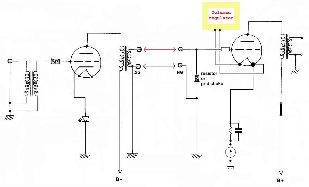

For some time now, I too have been thinking of building an amplifier with two separate stages, each with its own power supply. The first stage with the driver tube ends with the secondary of the interstage transformer. The second stage with the power tube starts with the grid connection of the 845 (or other tube) and ends with the speaker outputs.
However, I have a number of questions.
1 - can the first stage (but also the second stage) be damaged if the connection between the two fails when in operation?
- the second stage is connected to the first stage probably with a 2-pin cable (ground and signal): would a normal cable with rca pins (like the ones we normally use to connect the cd to an amplifier) be OK? and if so, of what length? (friends advise me against this design precisely because of this, as the connection between the interstage and the power amp grid had better be as short as possible)
- for the second stage the signal I think necessarily needs a reference to ground consisting of a resistor (of what value??) or a grid inductance, when - if everything were in one chassis - there would be no need for this as the interstage transformer (if carefully chosen) does not need any load resistance on its secondary before entering the grid of the power amp.
That's a very old post! I never did build an 845 amp. I use a 2a3 output stage. I do have a driver stage in another chassis, though, like you say. I don't use an interstage, just cap coupled so it's just an ordinary RCA lead. You can put 1M or 2M on the output of the driver stage and then 100K on the input of the power stage, the 2a3 in my case. So just 2 DHT stages. It needs a step-up transformer in front of the driver stage, which is a 10Y. I use a Hammond 1140LN-C in 1:4. Maybe someone else can advise on using an interstage.

In the connection between the interstage transformer (which is in the first chassis) and the power valve grid (which is in the second chassis) no voltage passes, only the signal. Thus - of the two cables (see diagram #29) connecting the two chassis, one is the cable that joins the grounds of the 2 chassis, while the other only lets the audio signal pass between the secondary of the interstage and the grid of the power tube. The power supplies of the two chassis are each independent in their own chassis and there is no passage of dangerous voltage between one and the other.Using an RCA connector for voltage is just asking for deadly trouble! An uninformed, well meaning idiot could plug anything that has an RCA on it into high voltage! This might end in death of both the amp and the idiot! Always use dome sort of locking connector that is not used anywhere else to avoid mistakes. Companies like Cimch make great mil spec connectors with as many pins as you need. Get the ones with screw rings to avoid accidental disconnections. Orient them so the female has the voltage on it so you cant accidentally touch a hot pin. Always plan for the worst possible event to happen and design to avoid it! It’s hard to find very high voltage wire in the audio world so make sure you have wire that is rated for it. Neon sign wire can work. Don’t cut corners because nothing is worse than someone dying because you saved a dollar unless you really don’t like them.
I fail to see where you see the danger.
Special connectors capable of carrying high voltages between separate chassis are normally used when - for reasons of space - the amplifier is built with the power supply on one side and the valves and interstage and output transformers on the other.
But this is not the case here.
Of course you don't use an RCA connector for voltage but that isn't what I said or would ever say. The RCA connector just connects the signal, as it's always done. You would use a power connector for voltage.Using an RCA connector for voltage is just asking for deadly trouble!
It seems logical to me that an approach of the kind shown here has as its only advantage the modularity of the amplifier.
Having the driver and power tube in separate chassis makes it possible to try different drivers on the same preferred power tube. Or use the same driver on several other power tubes to listen for sonic differences.
Having 2 separate power supplies is uneconomical and would make little sense: unless it also makes the amplifier perform better electrically and sonically.
At least that's how I see the prospect of this possibility.
Yes - that's how I see it. Smaller chassis linked up. One power supply, one output stage, one driver stage with SUT if needed like 1:4. There is your amp. I did it that way to try several different driver tubes plus some outputs. The other reason was ease of handling. Each chassis was lighter and easy to move around and work on, given that they were constantly going from the bench into the audio system. The filament supplies are in each chassis with their DHT tubes, in filament bias where possible. You could put the outputs and the PSU together in a larger chassis. That works too. Filament supplies for DHTs are quite large, plus heatsinks and Rod Coleman regs, so you would run out of space on one chassis.Having the driver and power tube in separate chassis makes it possible to try different drivers on the same preferred power tube. Or use the same driver on several other power tubes to listen for sonic differences. Having 2 separate power supplies is uneconomical and would make little sense: unless it also makes the amplifier perform better electrically and sonically.
