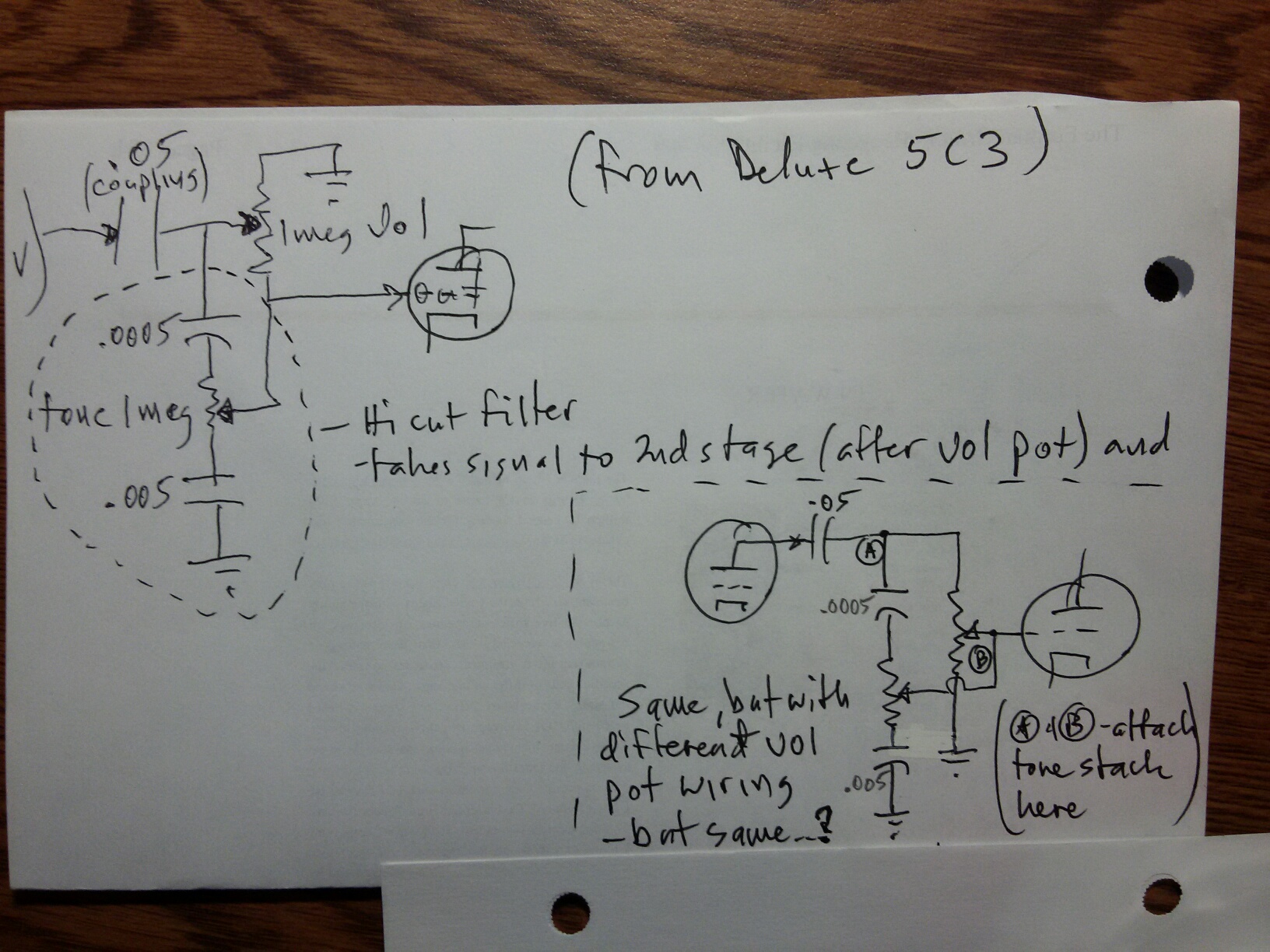

Attached is the Deluxe 5C3/5E3 preamp schematic, and a drawing of it with different vol pot wirings. The lower right dwg shows the vol pot in my Champ (wiper to grid), and the upper left dwg shows how one vol pot of the Deluxe is wired. Am thinking the two are NOT the same, as the wiper of the tone pot see different resistance from the vol pot as it is changed on one dwg but NOT the other. I have read that Deluxe controls all affect each other, even the vol pot of the UNUSED channel... This is where it gets too complicated for me.... I have a decent Jensen spkr in the amp, and have played with the NFB, had a pot on it, now a switch (opens for dirty, or 47K for clean). Amp has plenty of treble, no hi rollof components in the circuit, so I just want one pot to do it when I need some. Thanks again!

I changed the tweed TC (as well as everything else) on my peavey Royal 8 to the bitmo tone control mod. This removes the interaction with the volume. Very happy with the change. Google is your friend for schematics.

The bitmo mod adds one resistor and a wiring change to make the tone control independent of the vol pot setting.

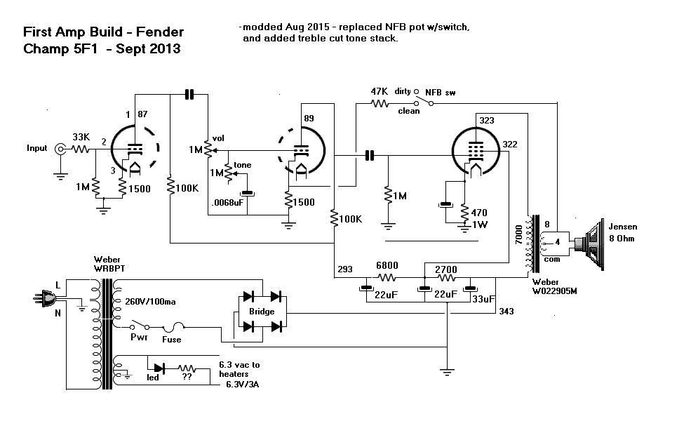

Well, I decided to keep it simple, added just a pot and a cap (ala guitar), to keep insertion loss low. I did build a Big Muff style stack (got it from another thread), but will be using it on my 2nd build - never put tone controls in it either - a Princeton clone with tremelo. My Champ is done (for now), also now with a switch on the NFB for clean/dirty. Finally drew up the schematic - menial labor but still useful down the road. Thanks for all the help!
