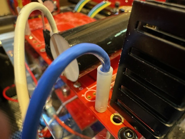

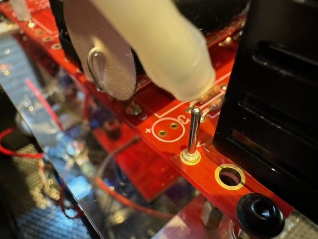

I'm looking for something like the connectors in this picture. I have boards with a single hole for a wire, so I couldn't install a two-leg connector, but I still want the ability to disconnect without desoldering.

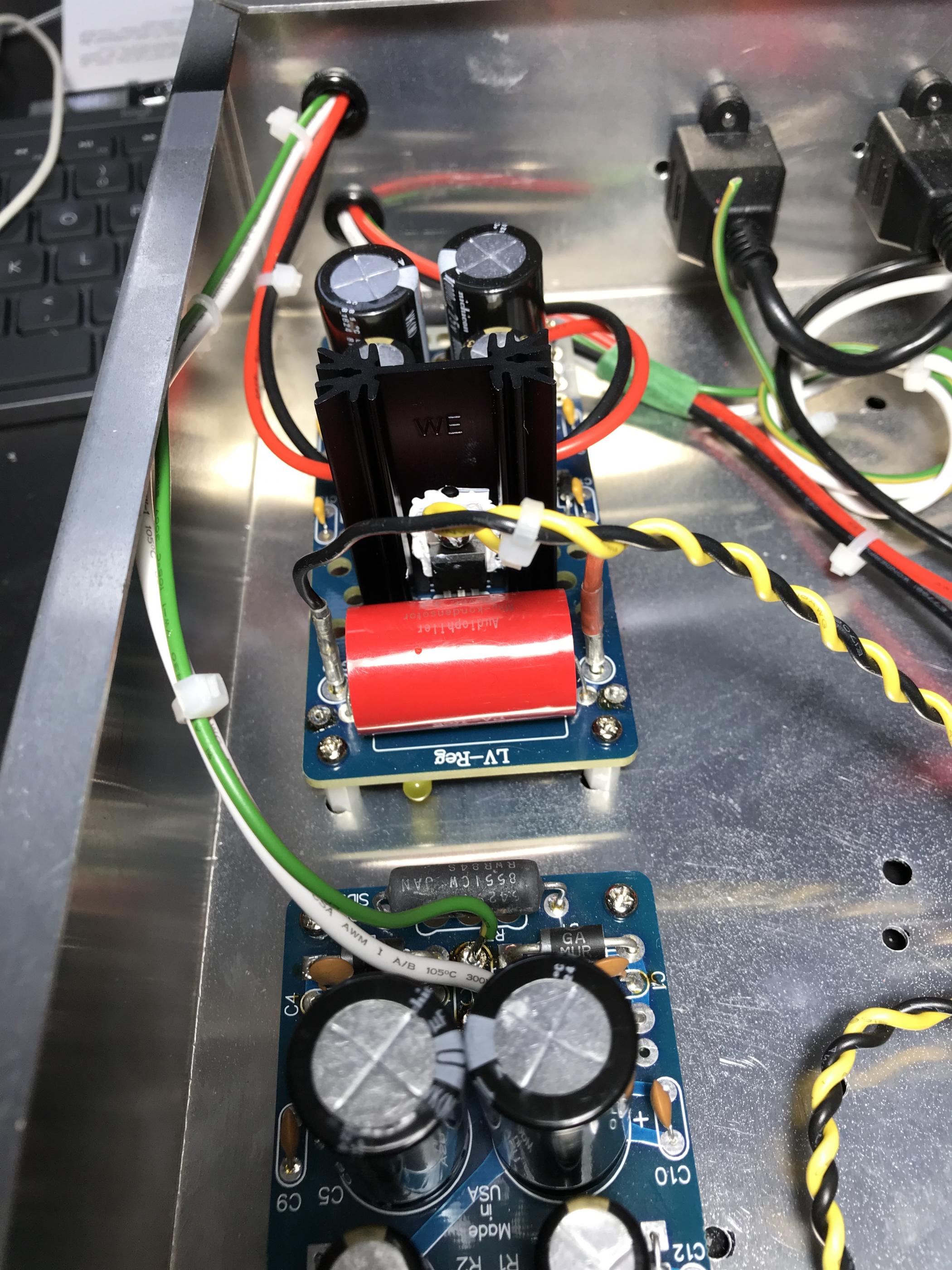

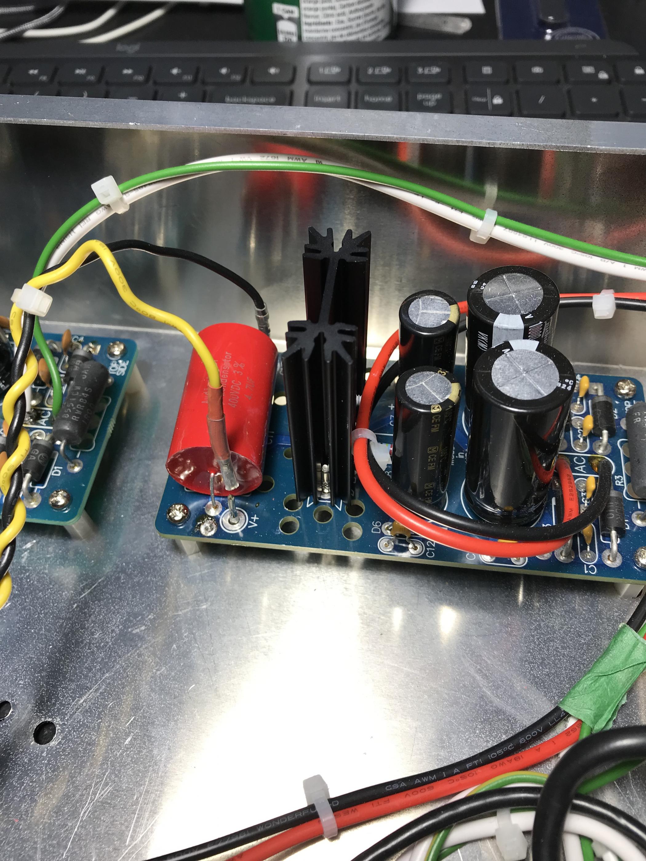

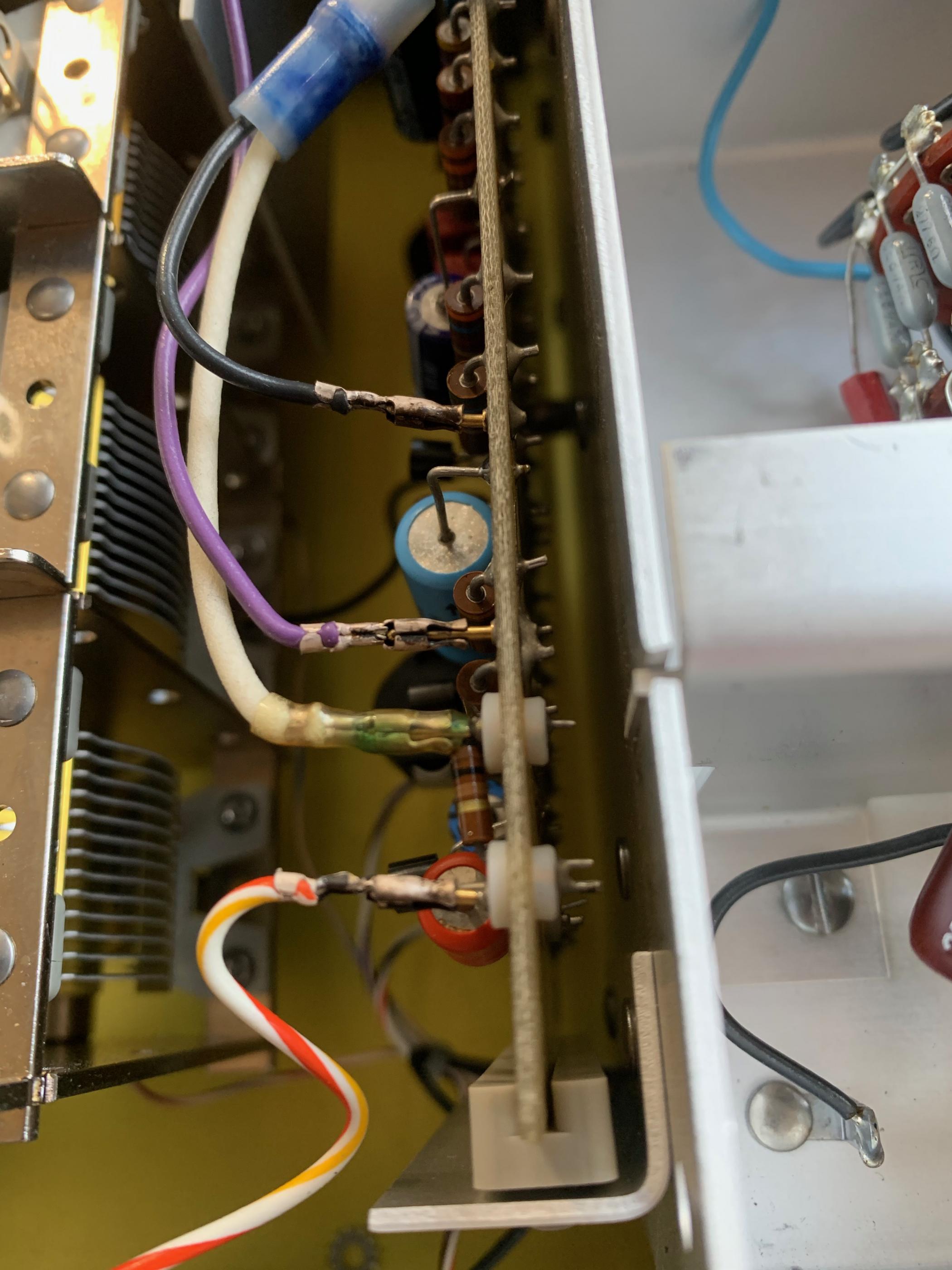

I use single pin molex terminals for a quick disconnect function for DC power for my boards.
Made by Molex, Mouser part 538-150180-1016 for male terminals and 538-150181-1016 for the female terminal.

Those were popular in the 80´s, then fell out of favour, because either multiple cables were used or, at "high power" connections such as power transformer to power supply PCB they went to 2 leg flat pins which are stronger.

The top one in your picture
996055d1636396163-single-pin-disconnects-img_3215-jpg
is probably:
Pinball Life: Molex .093" Female Connector Pins 18-22awg
but looks like a kludge to me, it is not even insulated.
It should at lest be heatshrinked, but much better inside its own rigid housing:
