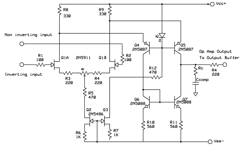

I have been working on a DIY Headphone Amp using a similar Folded Cascode topology and I find mine has a lot in common with this
A lot of researching reveals also that this is a popular implementation of Folded Cascode Amplifiers I see similarities in these circuits to early Solid state Luxman Amps, however As expected each designers implementation of this idea while generically similar are unique in individual details. One classic variation is if a Diff amp is included in some designs such as the design I just cited, while others dispense with this additional diif amp in the second stage as is done in this Implementation,
in addition other subtitle variations include to current source actively or passively along with other housekeeping duties. Feedback and compensation are also critical. This brings me to my question Referring Back to the first design the Load Resistors for the vas stage design the 47k to ground from the Collector and emitter of the VBE multiplier. This appears to be the most popular method however I was thinking of returning them to the inverting input sum node along with the Overall loop feedback loop. ( Again I cite this design)
I would like your views on these two methods as I hope to be able to make my design stable without any compensation capacitors and yet retain a comfortable Amount of overall feedback. The second method appears to have the advantage of using the vas second stage load resistors as an additional local feedback loop around just the Voltage gain section and thus not have to deal with the excessive phase shift of the output stage. I understand a simple solution is a cap from the collector of the Vbe multiplier to the inverting input nd in effect rolling off the bandwidth of the vas stage to a point the output stage can deal with. In my version I am using a three stage Darling connected complementary output so stability is an issue with my wish list however I want to add to that list no frequency compensation capacitors be required.

Hi, PPI,
I've got (bad) experience with folded cascode. If your output stage is classA or having error correction scheme, you can use folded cascode and have good result.
I made low biased classAB without error correction, and the front end is folded cascode, it's just not working. OL gain is lack too much, the sound is like all treble to the music.
It is right that folded cascode (ie : low OL gain) can dispense stability caps like miller cap, and with folded cascode usually stabilizing is done by 5pf-20pf cap from collector of folded cascode to the inverting input, or even no cap at all, but the main problem is how many OL gain minimum is required to fix all the bad things in the whole amp? Sometimes folded cascode just don't provide enough OL gain to be burned for good CL gain performance.
Other method to linearize OL curve (beside putting R from collector of VAS to ground) is to put 220k in the place of miller cap (base-collector of VAS) and this works good too 😀 But my experience, load to ground or 220k in VAS local loop does not affect stability much, the best way to stabilize an amp is still put caps.

Where's the folded casocode? Connection of Q3-Q4 to Q5-Q6 seems to be double differential? This one has huge OL gain, folded cacode has very low gain

Hi Ppl,
I am looking for the folded cascode, but I cannot see it.
Have you posted the correct schematic?

Well if taken from a academic point of view the addition of Q5 and Q6 changed the topology from the folded Cascode to a Jfet/BJT Cascode Input Diff amp cascaded to a BJT Cascode Diff amp loaded by a Current Mirror, however that’s too long of a file name after this design is stable without compensation capacitors I can do a PCB up and its then fit to release to the DIY headphone community the name can then be changed to something totally non technical. Attached is what this project started out as and as you can see it is technically a folded Cascode, it actually works for such a simple circuit but not real stellar THD and noise. After looking real close at the schematic to the OPA627/OPA637 IC monolithic Op-Amp’s on the cover of it’s data sheet I saw the pathway to lots of OLG. http://focus.ti.com/lit/ds/symlink/opa627.pdf
Folded Cascode Circuit

Actually I had very good results with it sonically. You can improve on the current mirror. Cascode the FETs. See my KISS amp:

You current circuit similar to the OPA627 schematic I started with....
ppl said:...... Attached is what this project started out as and as you can see it is technically a folded Cascode, it actually works for such a simple circuit but not real stellar THD and noise.

Hi ppl,
Am I seeing double on 1st Easter day as I see a 5-transistor current mirror?
Of course you can use it. I found it in a book: Electronische Implementatiekunde by Gerard C. M. Meyer, Delftse Universitaire Pers. (page 138). I only replaced the diode-connected transistor by a green LED. You will find it also in ICs where transistors are used at abundance. Old Harris data-books are full of them. It's a cascoded current mirror to counteract the Early effect

Hi, Elso Kwak,
In the KISS schematic, the differential is CCS'ed by BC550C running at 80? This BC550C works OK with 80V?

Hi lumanauw,
There are some fatal errors in the schematic!
You spotted one of them.
