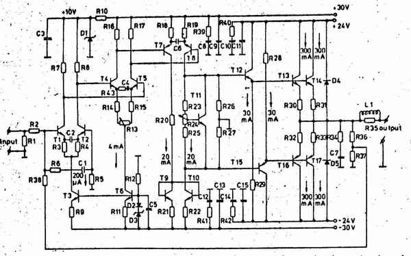

OK, what about this ?
There are 2 differential, T1 and T2 is differential, again differentiated by T4 and T5. T7 and T8 are VAS, T9 and T10 are current mirror.
This is dual differential, right?
There is also more complex design, Complementari differential + dual differential, where T1+T2 has its PNP friends, T3+T4 and T7+T8 also have their PNP friends. This design has 4 differential and 2 VAS pairs, like this attachment mirrored vertically.
AKSA, could you tell a little, why you never find it right with complementary differential? J Curl insisted on complementary differential, but he always uses Jfets+stacked self-biasing. Never tell about bipolar complementary differential+ordinary ccs.
