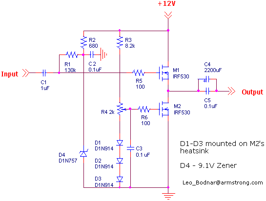

Leo Bodnar improved GSzekeres IRF HEXFET MOSFET HPA Buffer

An original Greg Szekeres HeadPhone Amplifier Buffer using MUSFET, can look like this
( szekeres own schematic )
Leo Bodnar has suggested & built an improved GSzekeres HPA Buffer.
See my attachment.
