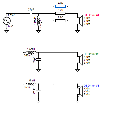

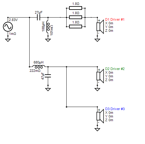

Single Highpass for 2 identical drivers. Bad idea? Or good cost saving?
I have a solid response curve that I am happy with in a 2 way MTM design using 2x DA RS180 8ohm in parallel, and 1 DA RST28F 4ohm. I initially had each woofer set with its own Highpass filter (2nd order) to obtain the identical FR. However, I was able to a nearly identical FR with both drivers using a shared 2nd order Highpass. Doing this will save close to $20-40 per speaker (assuming using mid grade components) just by eliminating that one Highpass, and I intend to make 3 of these.
Impendence, and all other modeled values seem the same. I have heard that doing this can cause issues with "vertical directivity". If it means what I think it does, why would that be an issue considering you are essentially only ever sitting in the same couch at the same vertical level the whole time? Any other concerns I am missing here to make me reconsider?

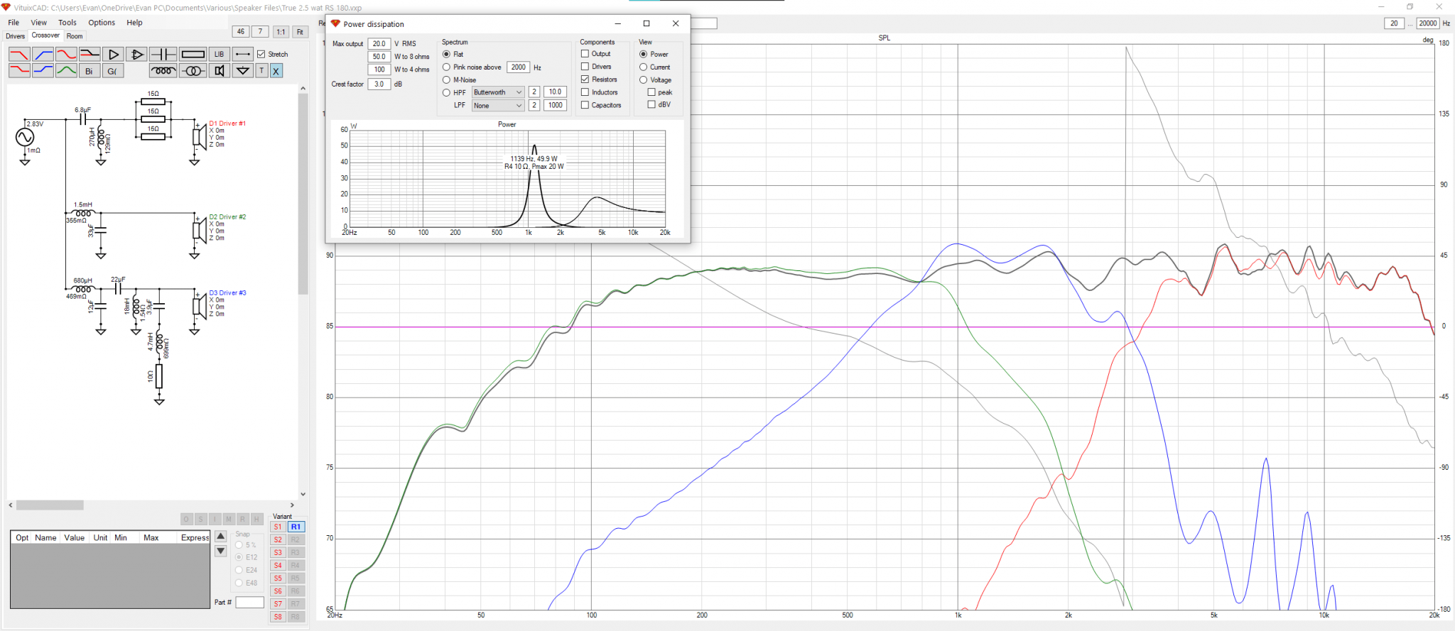

Some screenshots of both designs for reference.
Answering your question directly, I agree with Kevin.. however, I suspect you're talking about something else.
The context of your question makes me think you've been reading about MTM vs 2.5 way. The difference is that you low-pass one woofer at the baffle step frequency and then you only have one woofer working at the crossover frequency. MTM has a challenging tendency to produce a narrow directivity below and around the cross, compared to above it. This makes it difficult to get right if at all possible with a given configuration, making the 2.5 way a safer bet.

Other than doing a 2.5 way design, is there other way to help reduce this? I tried modeling a 2.5way crossover with these RS180 drivers, and it's proving pretty difficult to to get an acceptable FR without a pretty (to me) complicated crossover. However, I would rather only build these once, so I want them to be as good as possible, so if need be, Ill do it. I calculated the baffle step to be 570hz (8inch wide baffle) and this is what I came up with. Does this seem appropriate for a 2.5way design? Only real issue I am finding is the notch filter power dissipation is a tad nhigh when I am feeding it reference level power, but more reasonable when its typical listening volume, so maybe a non-issue.
(Just as an FYI, other baffle step considerations I am going to try and save that for DSP attenuation so I can consider room correction as well. SO, my goal is simply as flat as possible for now.)
There is much to sort out here. I'd mention that you shouldn't cut the lower woofer (D2 above) second order, it has to stay first. You shouldn't high pass the other woofer, they should both run all the way down.
I'm sorry, I definitely misunderstood what you meant. Below is a reworked version of what I think works as a 2.5way crossover.
