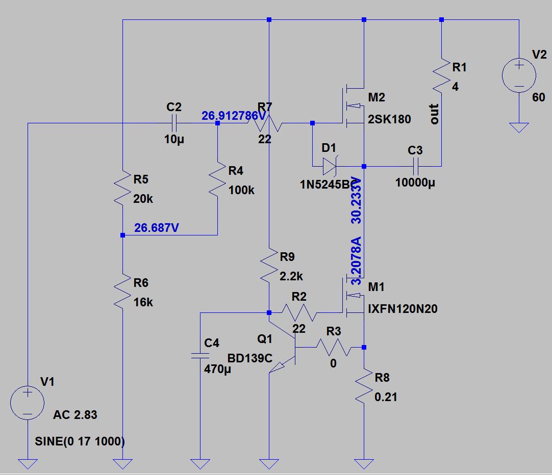

Analog_sa, a couple of suggestions along the same lines of what triode_al suggested:
1. Try a different Vds and Iq for the SIT. I have found that higher voltage and lower current worked for me for better harmonic distortion profile, say 33 to 35V and 2.2 to 2.5A for the 2SK180. The voltage drop across the CCS and SIT will no longer be equal. I did that with my common source BAF2015 amp.
When I do my build I will test and vary parameters if I do not like the initial harmonic distortion profiles.
2. Add some resistance between the CCS and SIT and take the speaker output from the middle of the resistance (mu follower). That will change the harmonic distortion profile. The speaker out location between the resistor group can be varied also. However I am not sure whether your CCS will work in conjunction with resistance as a mu follower. The CCS with optocoupler in my schematic in post #1 will.
If you are concerned with the voltage at speaker ground, you can change the polarity of the power supply as I have done in my schematic.

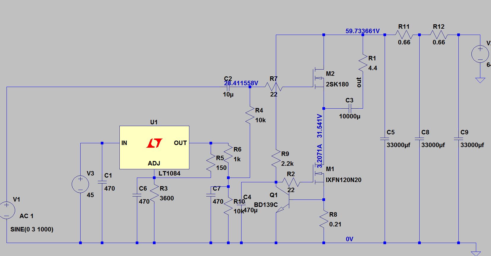

Fixed the hum issues when the speaker return goes to V+ with the addition of another PS cap and some resistance. Zero hum from any practical pov now.
Got the two channels to have identical distortion profiles and currently thd is set to a minimum. 3rd is very slightly lower than 2nd. The distortion is a ridiculously low 0.0069% @ 0.4W/4ohms. For reasons that are probably obvious but never the less escape me varying Vgs allows to balance between 2nd and 3rd within very wide margins.
Changing whether the source is grounded on the negative or positive rail is not the same. It appears to me in one case the signal is passing through the last PS cap. Listening tests were quite interesting with some deliberations within the first half an hour but eventually source ground went where it belonged, to the negative PS terminal.
Here is a more or less detailed circuit of what i have. Regulator is a 317HV and the mosfet a 140N20

I see you have added CRCRC to the power supply. That will definitely reduce the hum. In my single ended amplifiers I use a CLC power supply and that works really well. I hear no hum at all out of my 102dB speakers.
If you look at my schematic in post #1, you will see what I meant about power supply polarity. I also like that I do not need to add a separate bias supply.

Тhe supply polarity is relative and unimportant. The important bit is whether you connect the speaker load and source ground to positive or negative rail. Bias can be derived from the main power supply in either case.
After exhaustive listening tests i have established that returning the speaker to the positive rail is good, while connecting the source ground to the positive rail is not. A separate bias power supply also sounds better to me.
A next logical step would be to integrate a tube gain stage into this as such integration will make possible to remove the input capacitor and use the gain stage transformer secondary as means to apply bias. Otoh, already pushing towards 20kg/channel...
The bias circuit can also be simplified by moving the pot from output to Adj pin.
