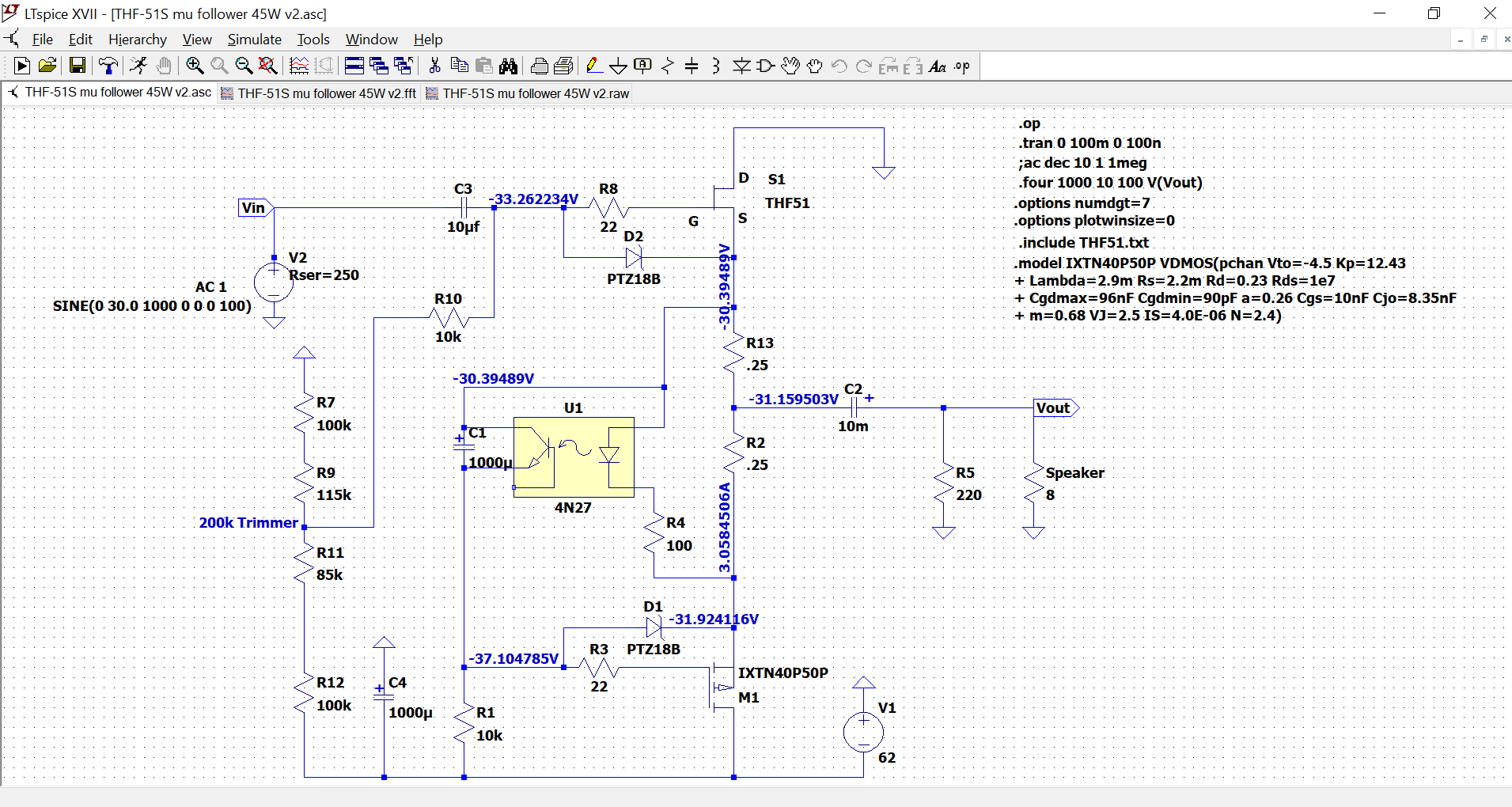

For the CCS/mu follower I needed to find a suitable P-Channel enhancement mode Mosfet. Unfortunately they are not in great supply, especially when I was thinking power dissipation of about 100W. So with a safety factor/derating factor of say four, I was looking for a device rated at a minimum of 400W. After some searching the internet I found the IXTQ26P20P. However it was only rated at 300W. I was willing to give that a try though. Its datasheet had a Safe Operating Area chart showing DC parameters at Tc=70C, Tj=150C and it looked very feasible. Then I found an even better device that was used by diyAudio member Lynn Quam in his SIT3X amplifier design: the IXTN40P50P. It is rated at 890W, so plenty of headroom, and it is also the same form factor as the IXFN140N20P in the BAF2015 amp. Also Lynn had the Spice model posted so I didn't need to search for it. Thank you, Lynn.
Since my plan is to repurpose my BAF2015 THF-51S build, I will be using the existing chassis and power supply. The power supply was designed to comfortably output 60VDC at 3.0A. It is currently running at about 2.3A and 62.5VDC. The chassis has a fan cooled heatsink and temperature is not an issue.

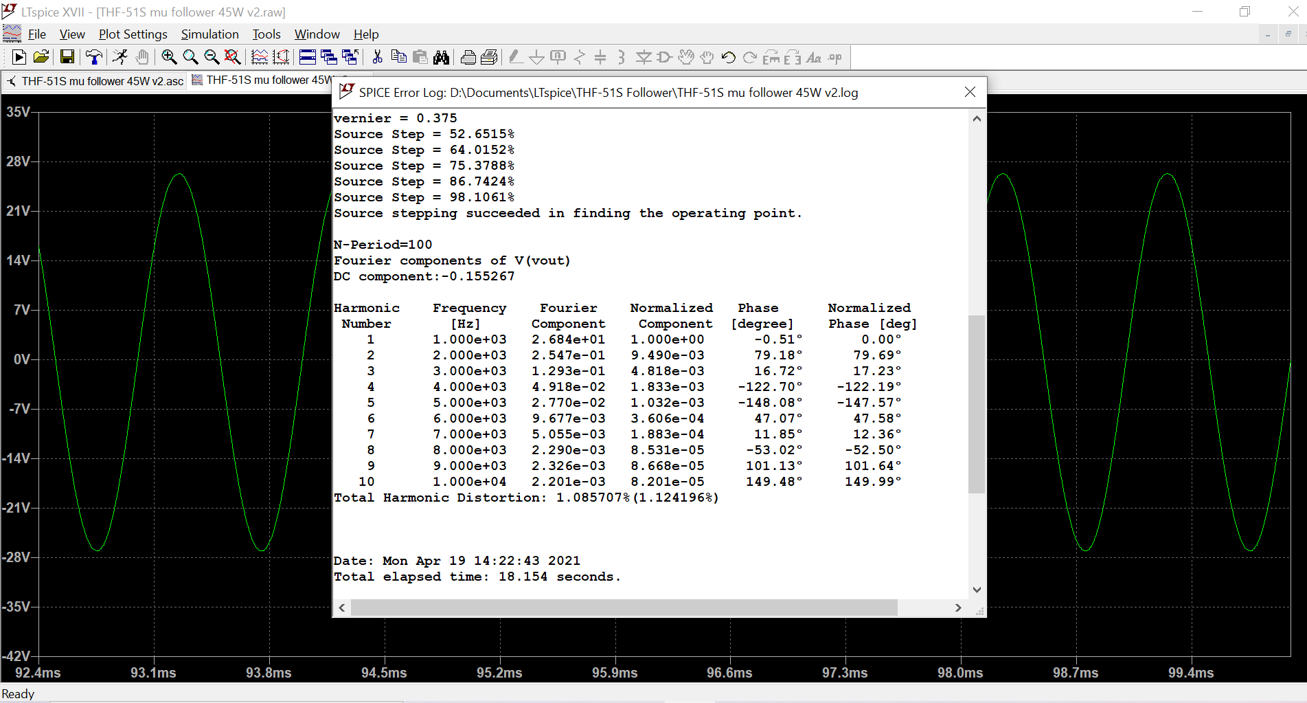

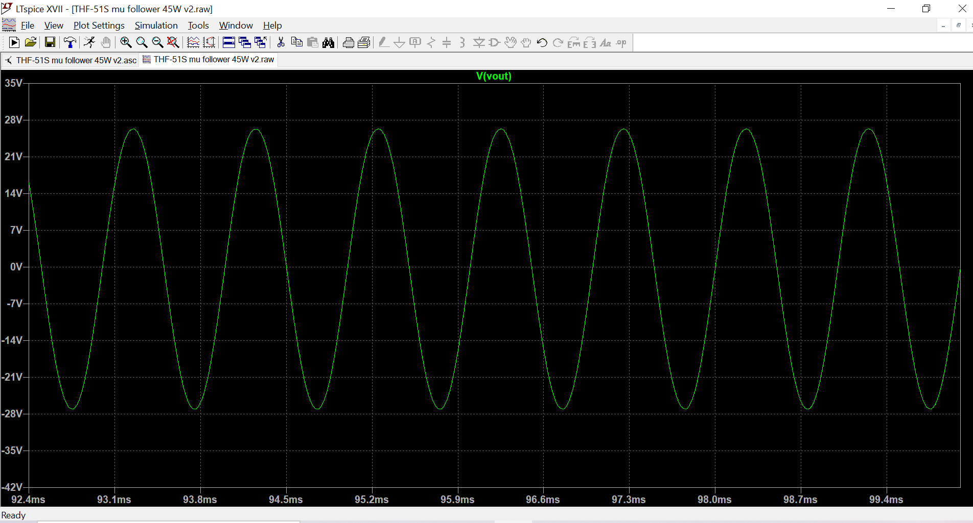

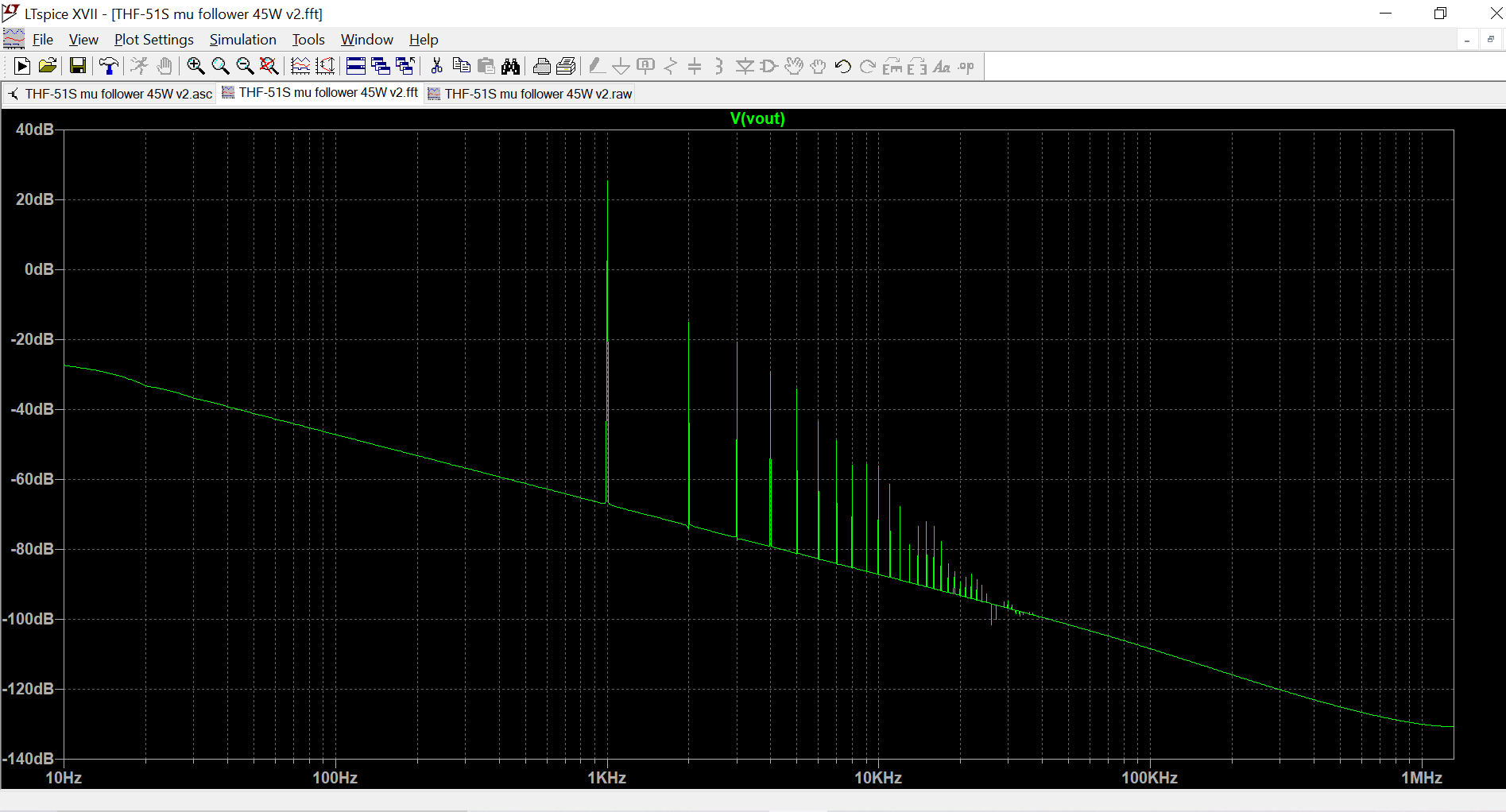

So I started out with some LTSpice simulations and decided to go with the mu follower and not just straight CCS, as the mu follower's additional power output was enticing. I found 62VDC and 3.0A was a good operating point. Simulations showed 45W into 8 Ohms was feasible. In reality, to be determined.
THF-51S Common Drain Mu follower 45W THD simulation.png119.9 KB · Views: 3,476
