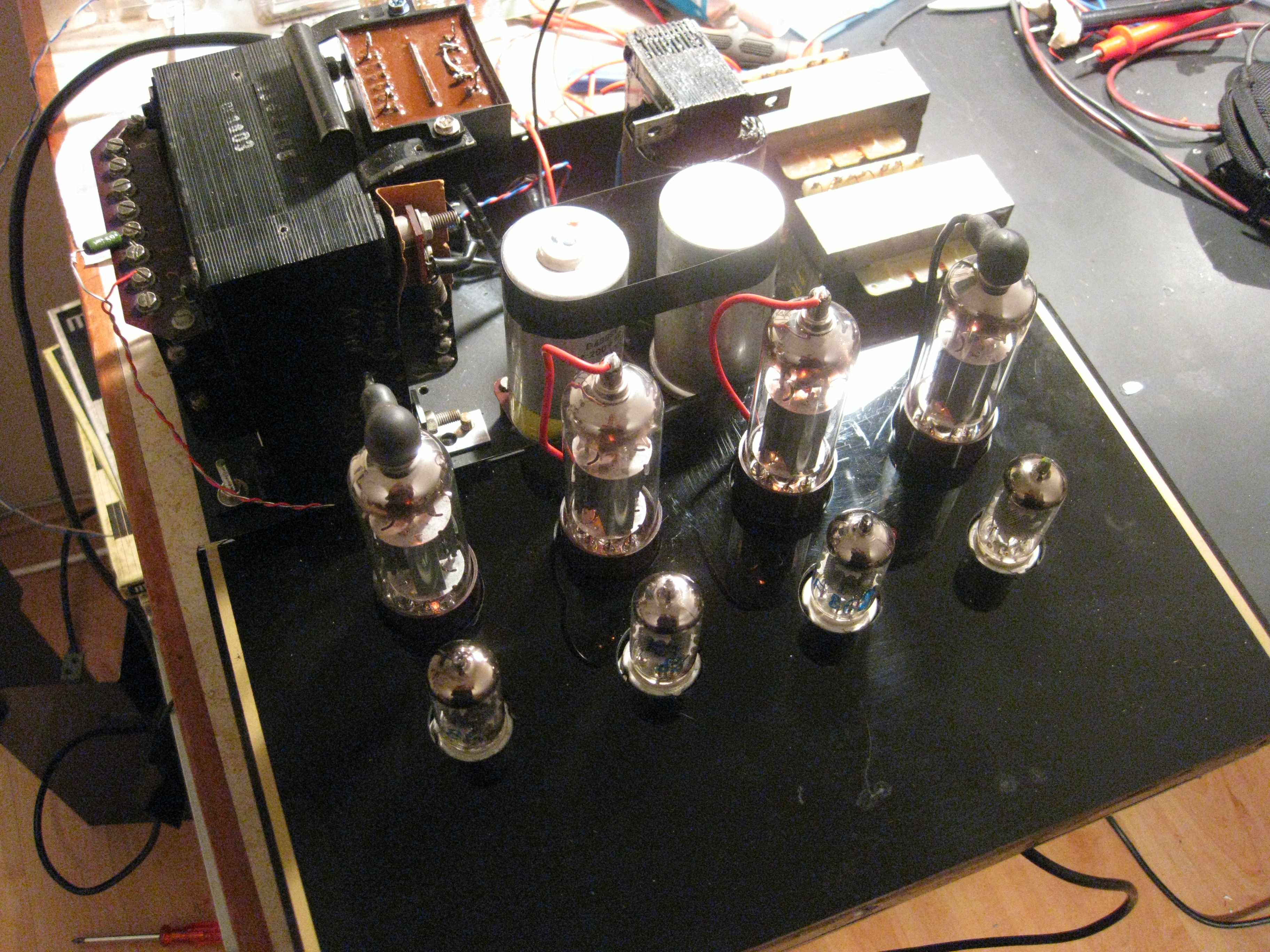

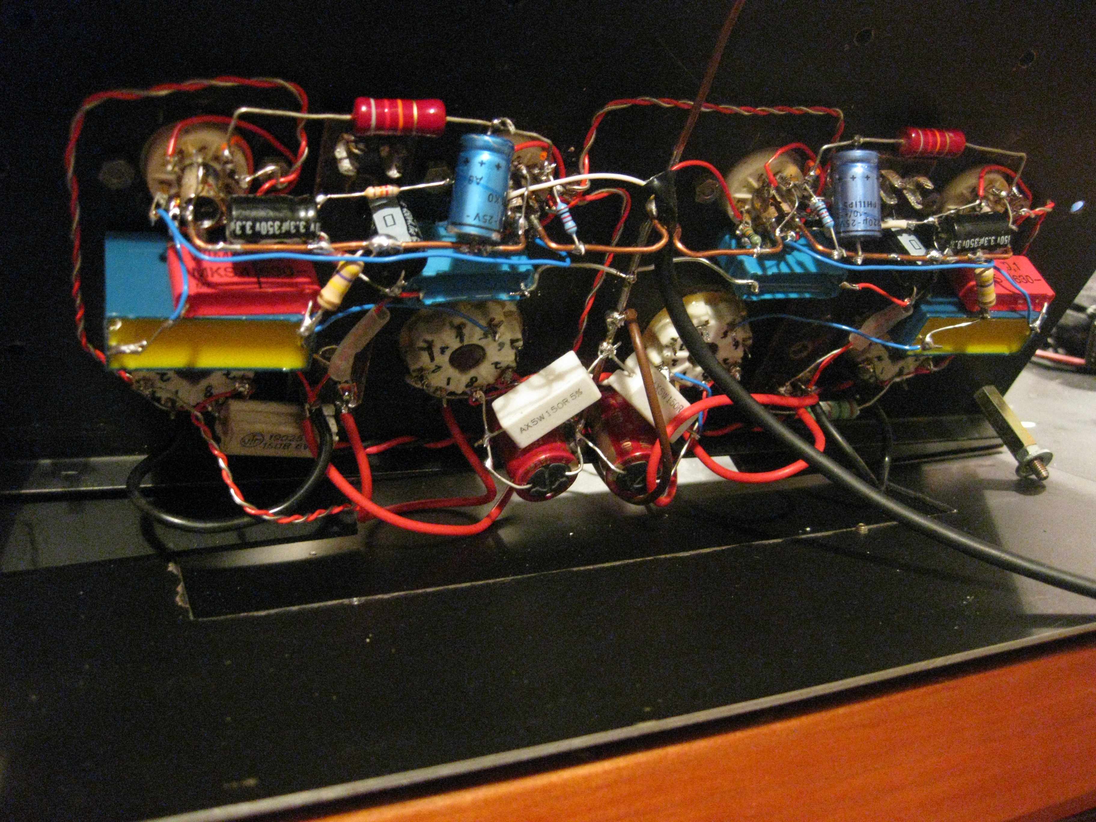

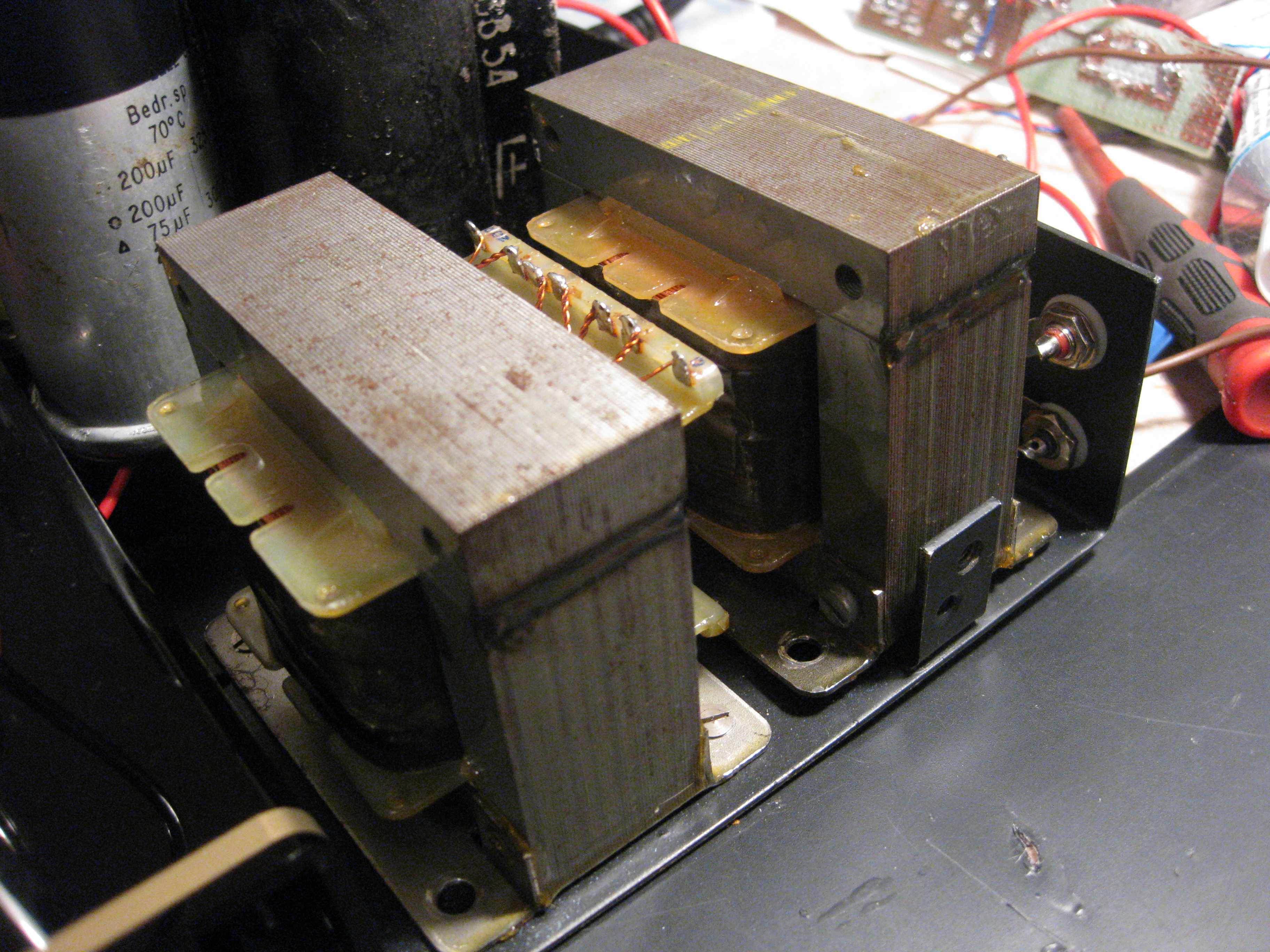

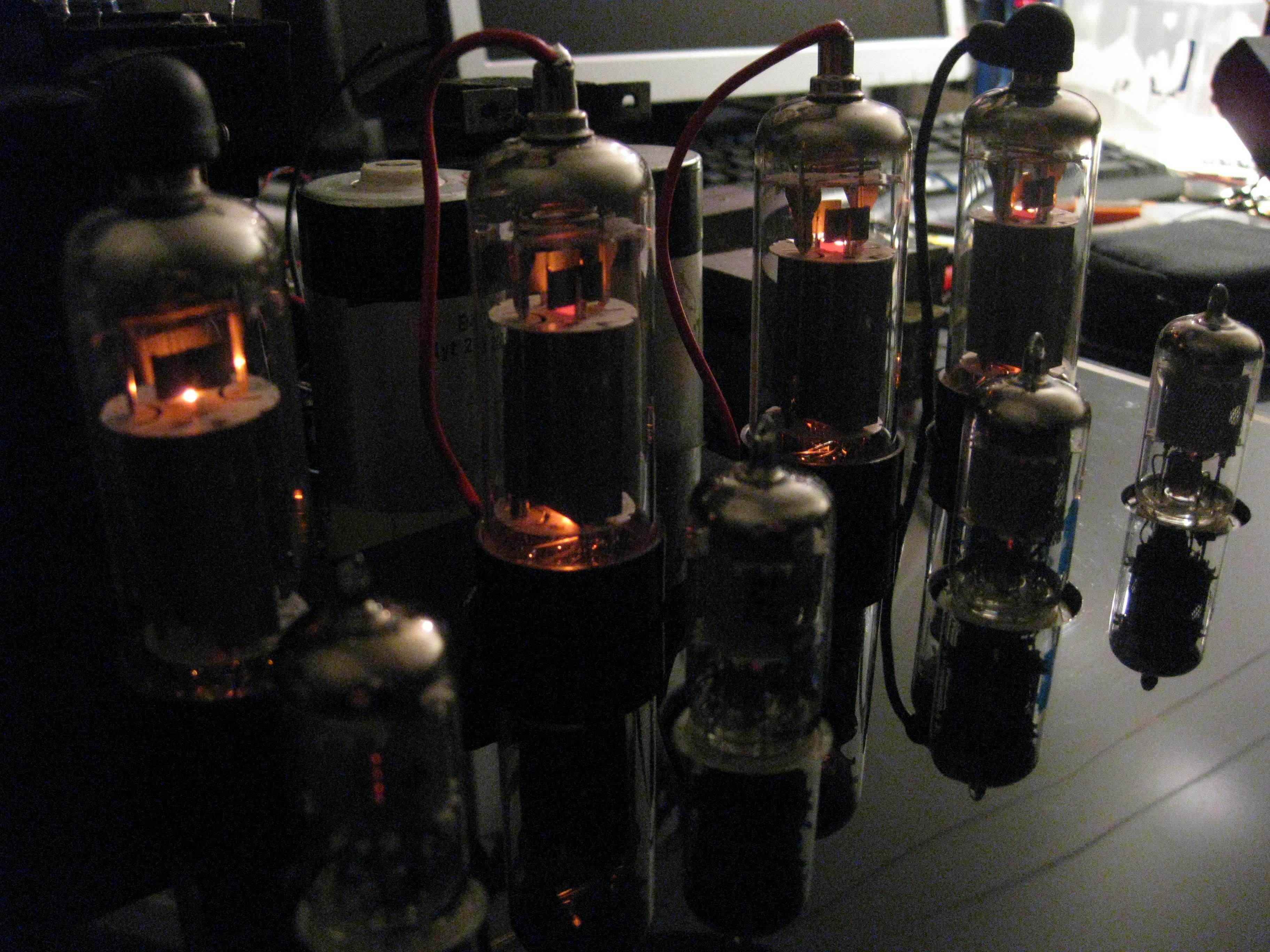

well well, looooong time ive been here. Long story too: my class D amp in PC speakers broke up and made a germanium amp for it wich i had laying around, AD161 amp. This made me think could it not be done with tubes and that reminded me on my first attempts. Spend a few hours on a soldering session and first design idea of a SEPP with EL34 penthodes is done. Sound not available (yet) but keep you posted.
Did not use the bootstrap idea but used this schem:
This has less coupling caps, and the bootstrap to upper EL34 is not needed, simply the voltage swing of lower EL34 drives the upper, simple as that.
