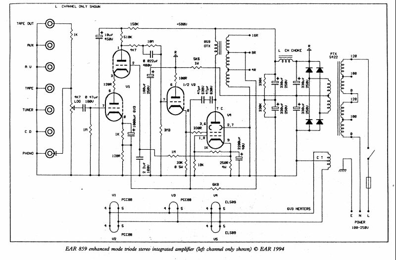

EAR 859 (YIKES)
Here's the schematic...
Holy Sheit/Merde/[insert your language here]
47uF/630V caps. A walk in the park.
Oh, probably jumped the gun on that; see Post 38 here:
https://www.diyaudio.com/forums/tubes-valves/27132-ear-859-questions-4.html#post770942
Wacky (and possibly "seeded") component values, plus a specially-wound OPT.
"Eccentric" is a word frequently used in EAR 859 posts.
Was hoping for something a little more conventional (read: CHEAP); ideally using iron and tubes gathering dust in the back of a shelf.
This is the TubeLab forum, after all.

I think Tim de Paravicini did indeed specify a "very good" OPT, which is always good, but I do not see anything "exotic" on the unit used (no added windings, taps, etc).

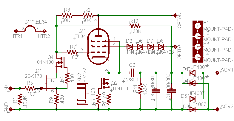

Thing is, there is not a lot of worked out schematics for single ended screen driven amps, so some experimenting will be necessary. Look at this thread EL509 (JJ) or PL519? for some additional schematics using tubes and mosfets to drive the screen.
In these amplifiers it is basically a voltage gain stage, than a current gain stage, and the output tube. The output stage has a high plate impedance, making it a transconductance amplifier. Do you want that? If not, some form of feedback can reduce impedance and distortion.
The El519/509 allows for a lot of plate dissipation and consequently output power, still a 6AV5 will also make a couple watts.

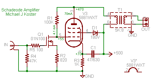

I mocked up an AC coupled, cathode biased version of Michael Koster's Schadeode so that I could easily test different tubes by changing the cathode resistor and the screen grid zeners.
https://www.diyaudio.com/forums/tubes-valves/196532-hybrid-partial-feedback-se-amplifier-2.html#post2710121
The plate to grid feedback is 98% by my seat of the pants calculations. And the tests were performed with Bud Purvine 5k ohm impedance transformers.
I tried the Rev1 circuit with 6L6WXT+, 7581, Philips top cap 6BG6GA EH 6CA7, 6CB5A and 6P20S, 26LW6 and 4D32.
The lower PD tubes produced 1 watt with midband distortion at 0.15% or lower, 8 watts at 1% and 10+ watts at 3%.
The higher PD tubes all performed better than this. The 26LW6 produced 1 watt at 0.1% distortion and 14 watts at 3%. The 4D32 produced 1 watt at 0.08% and 15+ watts at 3%. I only operated these tubes at 80% and 75% PD respectively, because my bench supply only produces 550 volts and my transformers were rated for 80ma.
I also tried the 4D32 with a James Transformer that supported 120ma and got similar results with 3% distortion occurring at 18 watts.
After these tests I ordered a handful of 6LW6 tubes and intend to build a stereo amp with them. I intend to use the Rev2 circuit for this amp.
