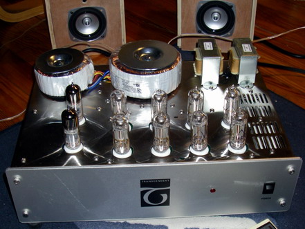

Well, folks, the kit arrived, and four evenings of labour later, I have single ended output transformerless house heater...err, amplifier. Its happily burning in right now with just a testing speakers for now. Too soon to be plugged in into line array or horns. Will report later. Here is pic of finished amp.

Very nice! Have you got a chance to listen to it yet on a efficient pair of speakers? Their T-16 stereo kit looks pretty sweet too.
yes, after few days of testing, i decided to plug it into my horn speakers (18" cervin vega, radian compression for midrange, cervin vega horn tweeter)
amp is not fully after break in, so I expect the sound to further change
here are the first impressions:
transcendent otl amp replaced my highly tweaked magnavox single ended el84 amp
sound is different, much cleaner, less sweet, much more transparent, if that is what one prefers
magnavox has 2-5% distortion, so the sweetness is probably overdone
transcendent does not seems to have much distortion at all
if one word should describe the sound, clean would be the word
it has nice hights, which were little sharp at first, but once tubes had hours on them, it got better, nice shimmering hights, midrange is crystal clear, from first moment, like no glass in windows clean, bass is there, its deep, but its not as authoritative as solid state bass, definitely not muddy as se tube bass can be
i was expecting a little more bass, but that might improve later, but than again, I am comparing to solid state amp, since I had system biamped
so far very happy with the result

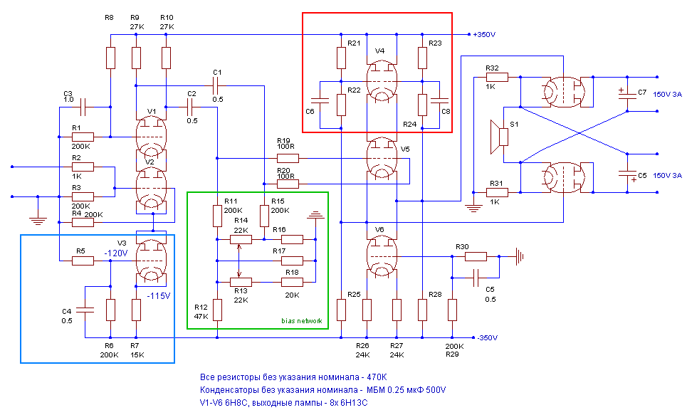

Follow the link for an actual working M-60 clone with improved driver circuit.
http://www.klausmobile.narod.ru/projects/pr_01_mamont_e.htm
Each channel (monoblock) requires 6 6SN7s and 8 6AS7s.

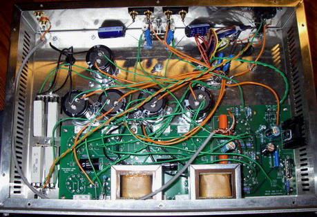

Congrats on your build. I'm curious as to how difficult it was? I looked at your internals pic and wires seem to be running in a lot of directions!

Looks like a pretty decent design. However, adding some gNFB would help with the bass problem he mentions, and help clean up the nonlinearity of operating the 6AS7 cathode followers into such a steep loadline.
Also, needs a DC offset servo. As it stands here, it's a speek-poofer waiting to happen. Especially when you consider that attention to balance between sections of the 6AS7 isn't what it should be. After all, the 6AS7 is supposed to be used as a series pass device in a regulator (where balance between sections is not so important) not an audio final.

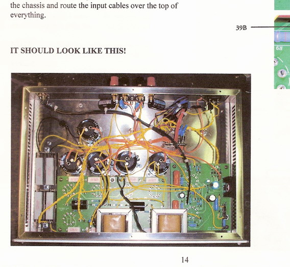

hi jduffy,
it was easy built, instructions were clear and easy to follow
when it comes to internal mess, that's exactly how its supposed to look like
attached is image scaned from instruction manual

Glad to hear it was an easy build. and I hope that you're really enjoying it. There is no satisfaction quite like the satisfaction of building something that makes beautiful music! 😀

Very-very nice design. Excellent. 6N1P tubes may be used there instead of 6N8S. Also, may be easily configured for symmetrical input.
I don't know the guy who designed it, but he is definitely The Master.
