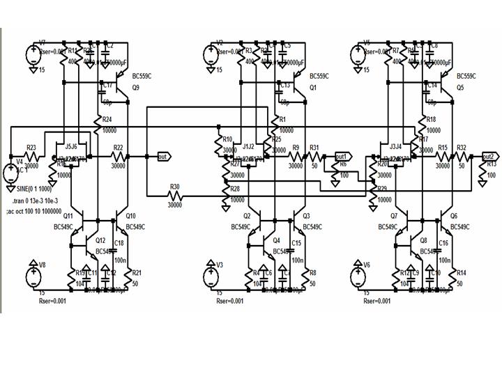

Single-ended input to balanced output, no DC offset
Has anyone designed a circuit that can translate the single-ended outputs from my active crossover into a balanced output with no +/- DC separation to drive my power amp. I'm trying not to use blocking capacitors in this signal path. The crossover circuit is on the same PCB as the power amp driver circuitry. The power amp has a DC servo, but this cannot null the outputs from two opamps if the +IN and -IN have a fixed DC separation plus drift. My search in diyAudio has yielded typical two opamp buffers which generate a few millivolts of non-symmetric and variable drift voltage separation which translates to 100ma of bias current at the amp's bridged output.

xplod, thanks for the BB pointer. I simulated a similar circuit using a discrete opamp (diff JFET Pass crossover clone ckt) and noted about +/- 12 mv from the sum of the balanced outputs(attached). Maybe discrete circuits cannot track as well as the Burr Brown IC with laser trimmed resistors and single die thermal tracking. I keep wondering if a good discrete transistor solution is possible.
ampguru, the amp uses one complementary differential folded cascode input stage with balanced inputs to drive both +/- bipolar outputs, so there is only one servo amp. In this topology, if the +/- balanced inputs have a DC sum on top of the signal, instead of just a balanced tracking DC offset, the outputs drive a DC current into the speaker.

Attached the Burr Brown drv134 buffer internal ckt diagram.
My design is all discrete, with JFET opamps used in the crossover.
A discrete circuit for single-ended-output from crossover to balanced-input on amplifier that nulled any DC offset created in the generation of the +/- balanced drive would help me and all of the SuperSym_X amp designers as well.

Wes,
I mimiced the Buffer134 using my discrete opamps and got the +/- 12mv offset shown in post #4. Burr Brown specs laser trimmed resistors and special on-die thermal tracking for their buff134. The Burr Brown app note shows DC blocking caps.
