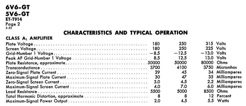

First time poster. I just found this site. Not even sure if this is the right category, but here goes. I am restoring a WWII BC-348R receiver. The original audio output tube was a 6K6. But since this radio is missing its audio output transformer, and the radio does not even have an audio driver, it depends on a single 6K6 to drive the headphones used on board the bomber. There was no speaker. But I plan to replace the 6K6 with a 6V6 to get a little more power out of it to drive a speaker. The 6V6 will be single ended, and I'm having a little trouble selecting an audio output transformer for it to drive an 8 ohm speaker. I seem unable to pin down a number for the primary impedence for said transformer. Thank you.
Thanks. I had looked over those charts over and over and just plain missed it. Now, if I can just fine a plan I like for the power supply on this receiver, I'll be in business.
