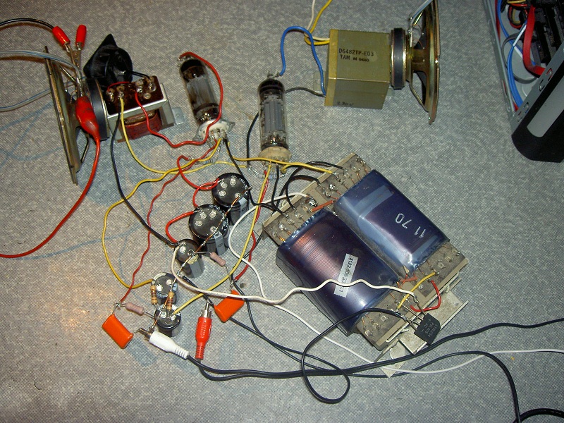

The prototype on the youtube clips uses two line transformer 220V/24V 40VA as output transformers

Audio test of PL504 @ 35Vcc with line trasformer 220/24V as output transformer:
http://http//www.youtube.com/watch?v=V1F7q249M0I&feature=player_embeddedhttp://www.youtube.com/watch?v=V1F7q249M0I&feature=player_embedded
Preamp = 1/2 ECC82
Preamp = 1/2 ECC82
hello ,
me copy your build , up to élévate HT to 150 V= or upgrad to 250 V=
you are no tested to big voltage ?
You can increase anode voltage up to 160 Vcc without any problem, just adapt electrolitics capacitors voltage. 🙂
You can increase anode voltage up to 240 Vcc without any problem, just adapt electrolitics capacitors voltage. 🙂
hello 😉 ,
i me tested to build , and me problem for use transformator adapted to impédance audio !
me old build , so risk no assymétric audio and build CR for good appréciate music ?
hello 😉 ,
If you increase PL504 anode voltage above 90V, you should use real audio output transformers (600-800 ohm) instead of using the line transformers as I suggested for the 24 Vcc prototype.
Audio transformers improve bandwith and also limit the risk of core saturation due to c.c.
If you increase PL504 anode voltage above 90V, you should use real audio output transformers (800 ohm) instead of using the line transformers as I suggested for the 24 Vcc prototype.
