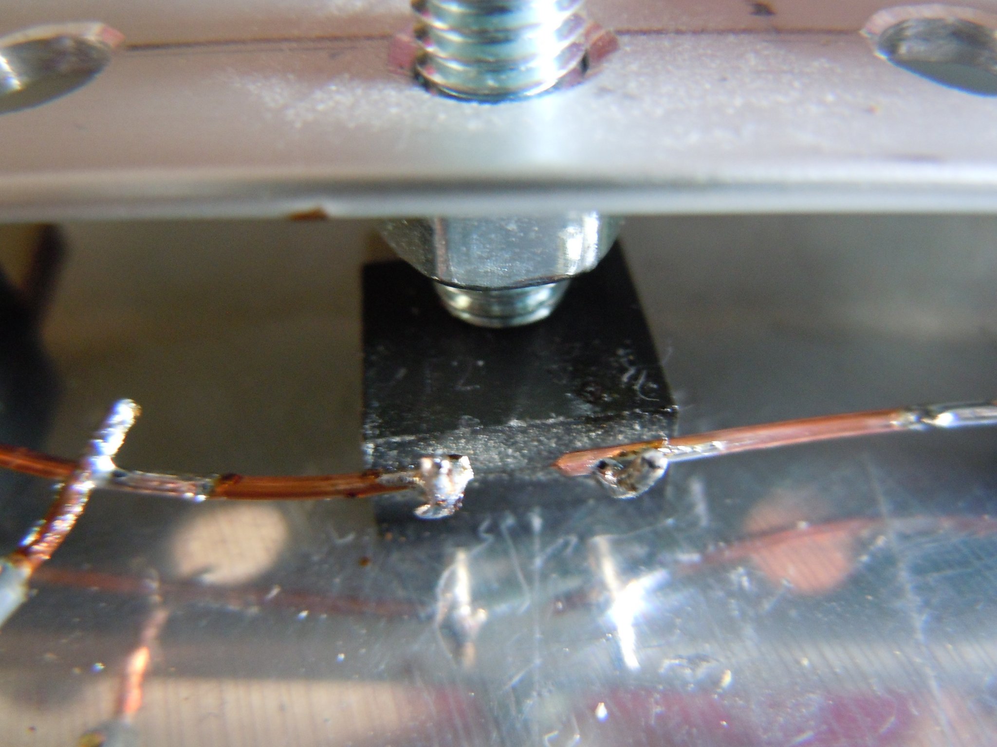

Here is a small detail - attention: physics, "science"-)
The contact pressure of the transistor and resistor, here showing the resistor as an example, to the heat sink in order to achieve maximum thermal coupling.
I use screws here that press directly against the PN junctions. This is not possible using conventional housing screw connections or clips.
Are you serious? Ordinary galvanized soft steel. Do you have any idea how much the non-linear magnetic fields induced in the iron will affect the sound quality? The junction is literally millimeters away from the iron. Electron flow in the junction is also affected by the magnetic field from the iron bolt.I use screws here that press directly against the PN junctions. This is not possible using conventional housing screw connections or clips.
Of course you do - this is one idea that actually has good engineering basis behind it. It isn’t directly against the PN junction at all - there is certainly the epoxy case in the way. But direct pressure over the die area IS the best way to reduce thermal resistance, case to sink. The mounting hole in a TO-220 is in the wrong dam place from a thermal standpoint. And the tab really isn’t rigid enough either (it bends, leaving further voiding under the die).
Those solder joints however, would fall apart on a shaker table. Or perhaps just moving it around the workshop.
Nothing revolutionary in this type of assembly which has been used in a few amps (not enough by the way) and I totally agree that it should be the standard.
Much simpler to implement on an assembly line.

You are supposed to use minimal solder, but make a mechanical connection FIRST. A shaker table does, in fifteen seconds, what months of use in your HT subwoofer will. You do NOT want something critical to go open and send DC to your speaker. Especially the subwoofer.
However, the TO220 backplate is made of copper which has a much better heat transfer than aluminum and using thermal grease should leave you without problems.
The thermal grease joint is physically THINNER with direct pressure. Even the copper lead frame deforms, and direct pressure deforms it in the right direction. Can a few tens of microns matter? YES. I’ve done the ANSYS thermal models and seen the IR results myself. As well as test data that confirms threshold voltage shift and reduced gain from thermal rise. Mind you, this was with RF power transistors (my day job, with a full lab at my disposal) but temperature is temperature.

My application is in audio too. The shaker table is just an industry standard way of doing an accelerated life test - they can’t wait months to see if something will vibrate apart under normal use.
I’m not putting something with a poor solder joint in one of my subwoofers, because I don’t want to pay for a RECONE or start a FIRE. I don’t need a shaker table to tell me when I see a questionable solder joint. When you start playing with 150 volt power supplies on your amps and something comes apart, things go szhekx in the night. You’ll quickly find out what 1/2 CV^2 means.
If the surface is flat enough, no thermal grease is better. If not, it can suck without it. Deformable and phase change interface materials are generally better and far easier to deal with, but the flattest possible dry joint is best short of eutectic attach. None of us here can get it that flat, and most AUDIO transistor packages aren’t up to that standard either. When you are dissipating 5 watts of average power it may not matter. Start adding zeros and it does.
