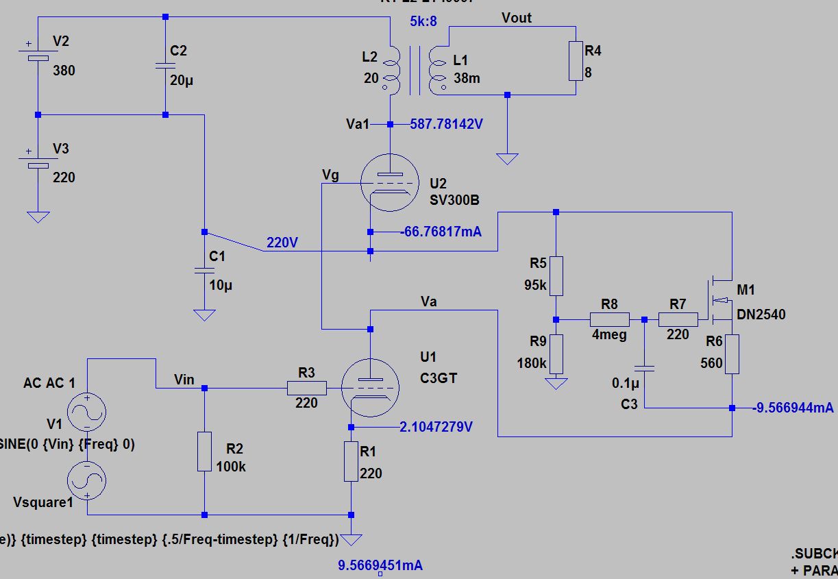

Hi Sheldon. Good suggestion! The 'upper' B+ will need to be higher than for the version with the plate choke... and maybe a solid state solution (CCS) would be less noisy (heresy of course, and not along the wishes of the original poster).

Thanks very much for this schematic pictured in message #79. So simple is correct, and this really is what I have been attempting to come up with by myself, but was fixated on providing a negative supply for the driver.

Hi RajkoM. Just to explain things a bit... you have 66.7mA on the cathode of the 300b, but the CCS only draws 9.5mA off it. The gyrator divider only draws 0.8mA.
Ok, so I would be tempted to cascode this CCS with a 2nd cn2540, and might use a different gyrator (I have been experimenting with a few). Also maybe you need to increase R8, but maybe not...
So, the question that one might want to ask is where does the rest of that 300b current flow?

btw, some might note that for this totem-pole method to work, you need significantly higher B+ than for the 'traditional' method.
