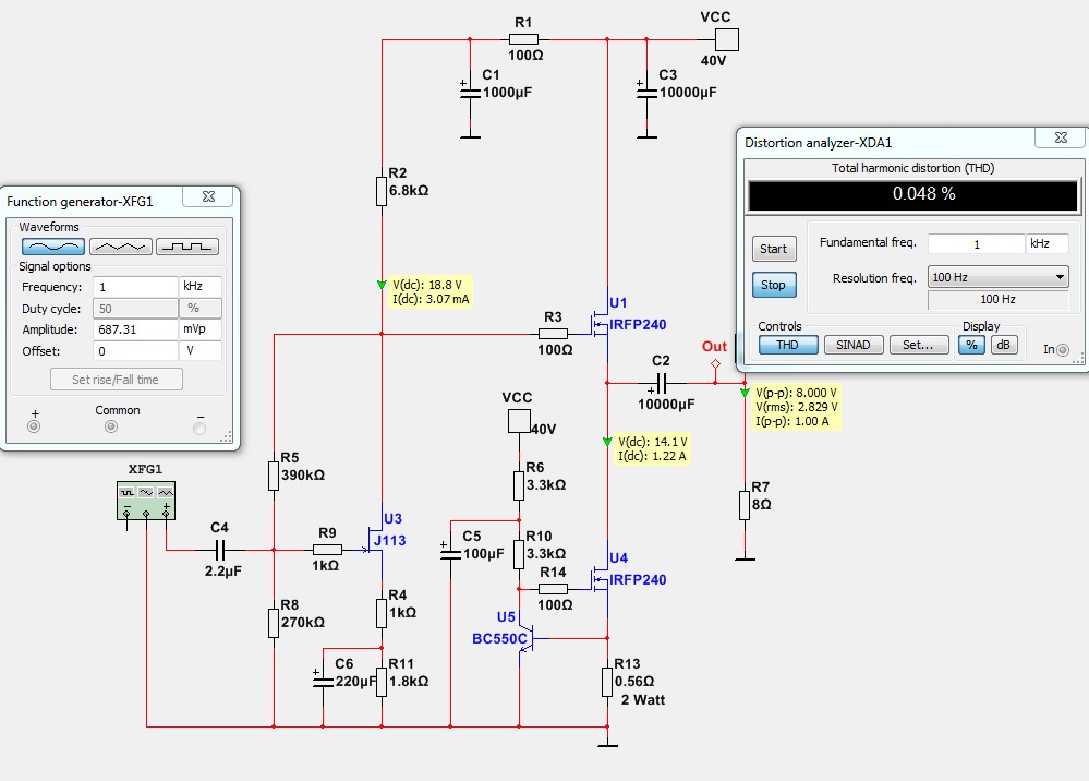

Single End Class A, No Global Feedback with J113 and IRFP240. 4 Watt.
  • Single End
  • Class A
  • No global Feedback
  • 2 Stages with J113 and IRFP240
  • Max 4-5 Watt
Here is the simplified idea.

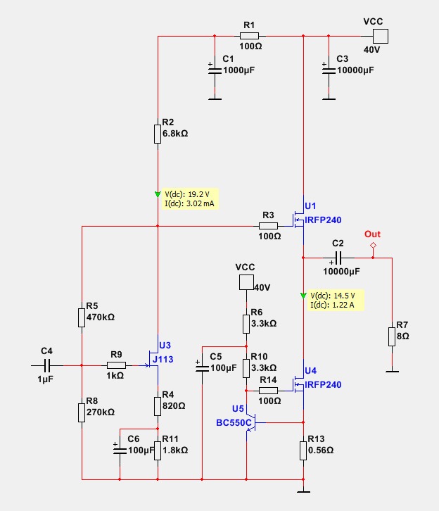

And the actually fully working circuit.
It can deliver more than 5 Watt into 8 Ohm.

As you might have understood - I'm on the hunt for some proper driving of my 16 ohm 18sound compression drivers 🙂 so I'm listening!
I also have a flat with electrical element heating so a bit a class A will not hurt 😉
Would this be suitable - anything better? Suggestion?
Reactions: lineup
Mike Rothacher has done a nice job on similar setups on his L'amp and Mofo series. TLDR is try a much simpler setup with a depletion mosfet for the CCS. And my favorite, use a choke in its place to reduce heatsink needs and improve efficiency
Reactions: lineup

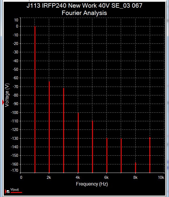

Here is Some figures of THD.
Watt THD
1W 0.067%
2W 0.100%
3W 0.130%
4W 0.166%
5W 0.216%
Max 5.7W at THD 1%
Also attached is the harmonics with the Fourier Analysis.

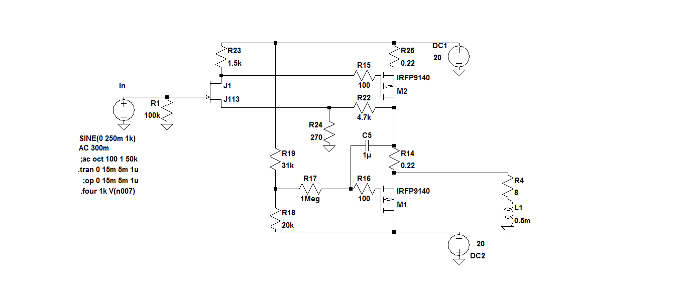

How would I add an Aleph current source? To my circuit.
Look here , it is a version of the Zen amplifier by Nelson pass. The Aleph I would describe as a controlled current source.
For a mu amp example, this is something I cooked up some time ago:
The bottom mosfet gets the output signal of the top mosfet into its gate through C5. So now the bottom mosfet becomes kind of a controlled current sink.
They used to call this a totempole arrangement I think, nowadays mu amp is more hip.
Nice! I'll have to get those circuits onto a simulator for a closer look. I'm basically looking at varying the output impedance vs frequency, e.g. by having a controlled current at high frequency, pulling against a muted voltage source. Whereas at low frequencies, the voltage source gets a stronger input signal and the CCS side has reduced impedance so it also runs as a voltage source.
I can do it with 'servo' style feedback, but I want to be able to use different filters that aren't constrained to a low phase shift for negative feedback.
Reactions: lineup
