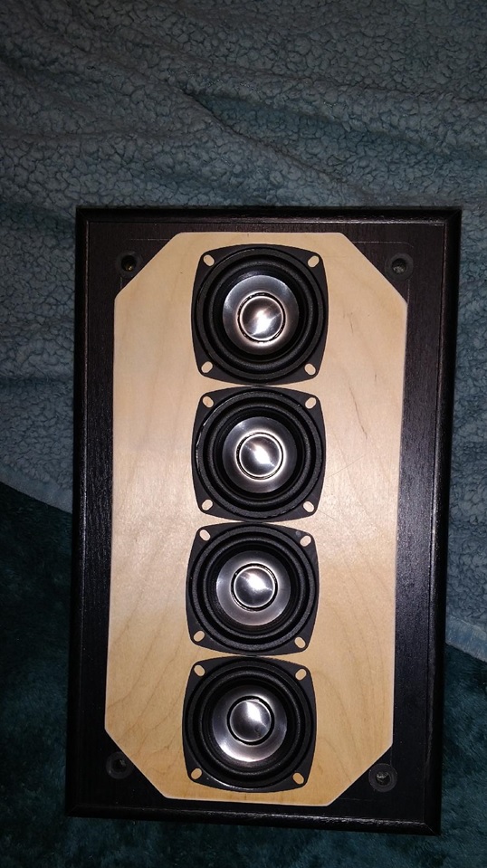

I have a 4 x 3" that excels at voices, not much below 200hz.
Works great at 9', requires slight tilting, i though it would be more.
Sweet spot vertical around a foot.
Make sure the minimal frames are touching.

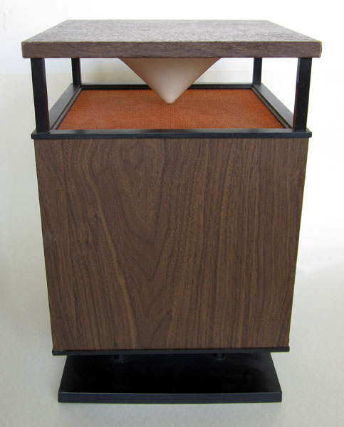

I really like the aesthetics of these Zenith speakers. I'm thinking they might be my target to design something towards

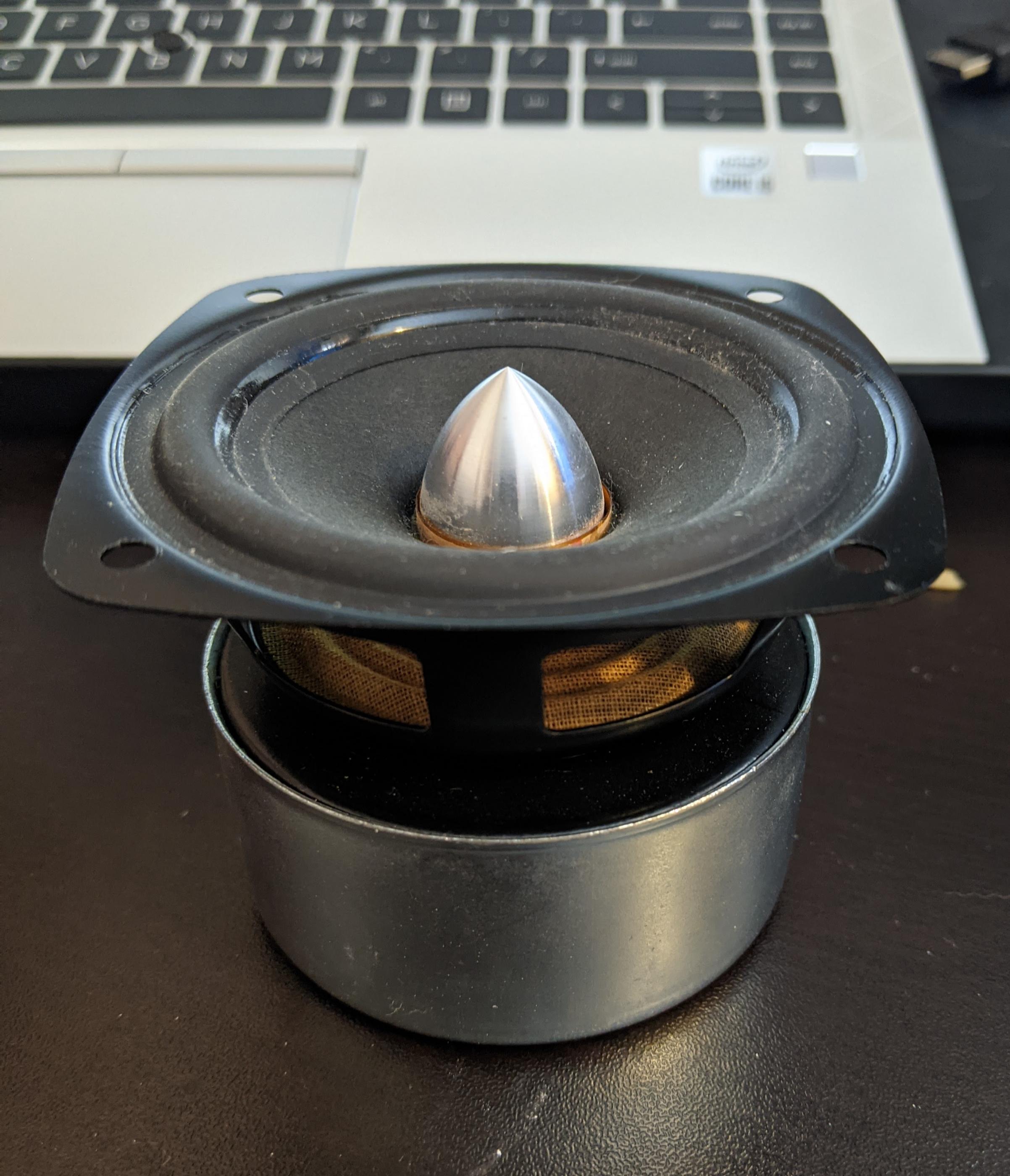

I have two pair of FaitalPRO 3FE25 that have only two wires to the SS amps. I just keep moving them around the room using heavy blocks of maple as a tiny city scapes that bounces the sound around the room This is clear music, but no lows. It doesn't affect the charm of living in a changing environment. I am an old man and the strict, solid image of my young, expensive listening has wandered off and the wayward sound just yearns to wander, like a restless wind? I have the cermet (mud) magnets. The speakers were $20./each. Heresy? Those old Klipsch three ways I started with were never this charming. Loud, plenty of bass, but no dancing...

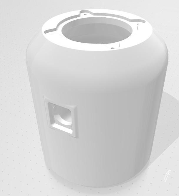

I will most probably soon print these (maybe some more improvement will be done on the baffle to round it a bit more). Just a hole for a 3FE22/25 and a speakon connector. I intend to print 3 or 4 of these to explore different options for exotic speaker placements around my living room, which is anything but audio friendly. No bass though, internal volume ca 1.3 - 1.5 l (need to measure when printed).

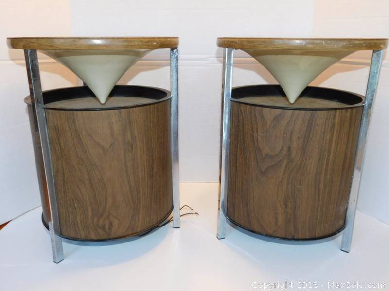

I can pick up a pair of these for cheap locally.
The range of detail & quality of build & the driver used vary considerably. Each pair is a crapshoot.
I probably have some of the reflectors kicking around.
