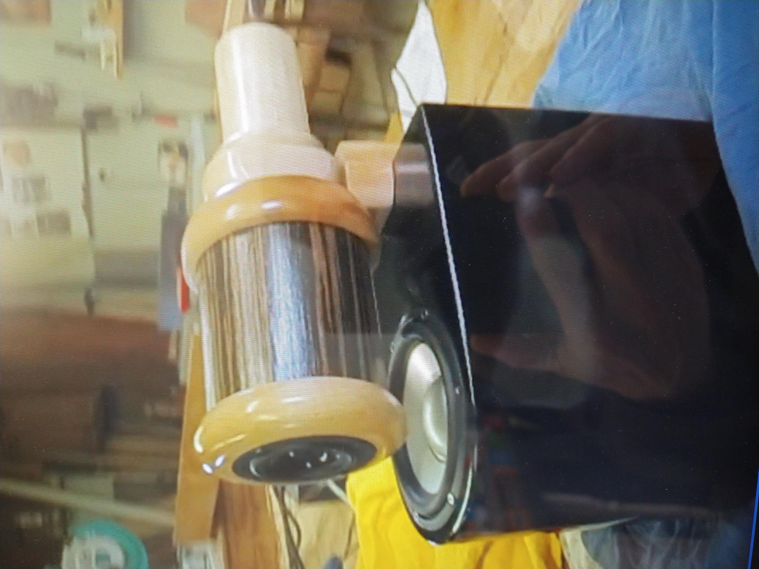

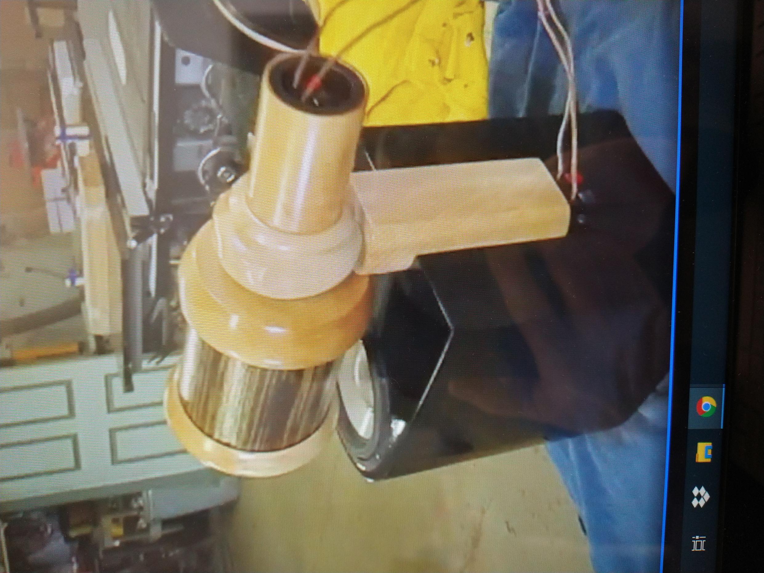

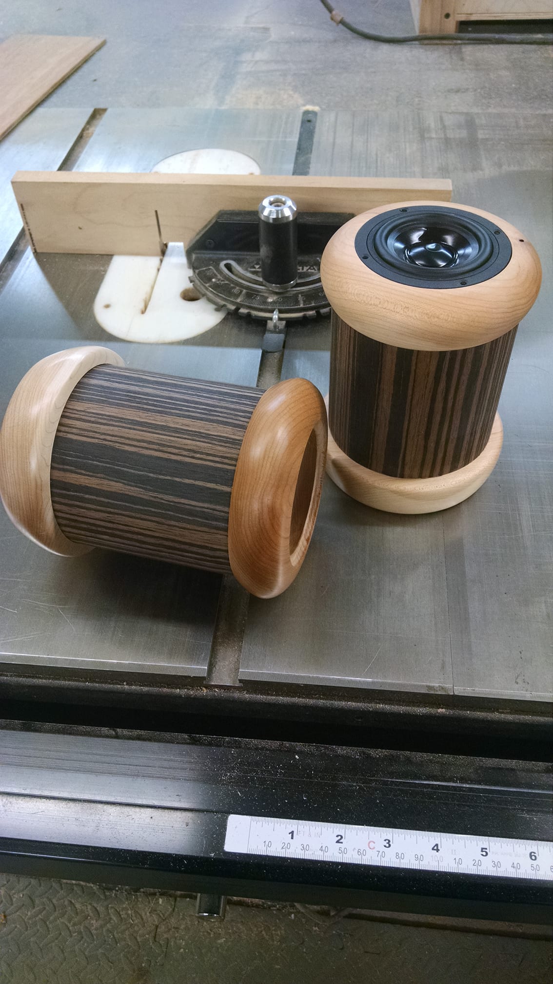

An enclosure like this would work well for that, pointed upward and set below listening height. Project I turned on the lathe a couple years back with an fr89ex. I was surprised how well the large roundover worked to mitigate diffraction effects from a small circular baffle.

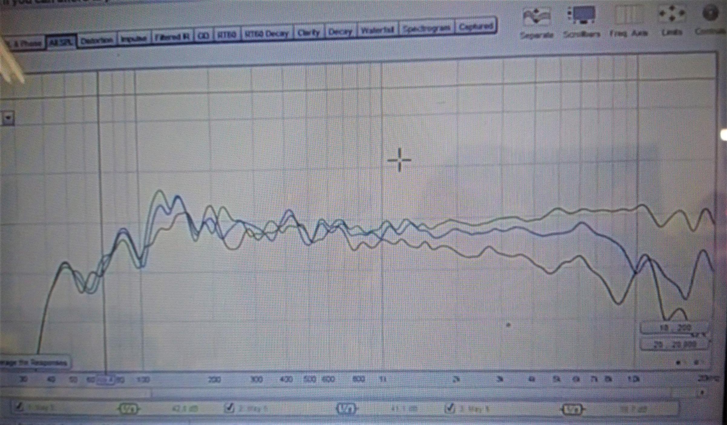

Yes it appears to be very effective, certainly when a torus open baffle was simulated. Did you take measurements?
I did take some quick measurements on the bench before I installed them. They were crossed to a seas L16 at 300hz, and mounted in a perpendicular fashion. I used them as side channels in a home theater install up high on the walls with the fr89 pointed downward, and they worked excellent for this.
Unfortunately the measurements only exist in a video I uploaded to the cloud that I cannot download. These are quick, rough and ungated...I wouldn't use them to launch a satellite but you get the idea.
1/6 octave smoothing done right there on the bench at 0, 45 and 90 degrees off axis and all the reflections included. The directivity is very good.
Sorry about the screenshot quality, it's all I have. Speaker connections are from the free on the side of the road collection, wood is Maple, everything is sealed, box volume for the L16 could have been a bit bigger, but all satellites had a sub underneath coming in at 60hz.
Hope this helps the OP's design considerations, I don't want to highjack the thread.
