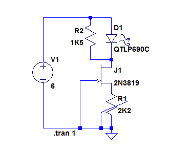

May I please ask what FET value in the datasheet do I have to look fore, to determine resulting current and Voltage output?
Idss is the parameter to look for: it determines the maximum current when the set resistor=0.
The resistor reduces that max to the desired value, and the shunt resistor across the LED allows the current to go to zero.
Voltage has no role in that, except it has to be sufficient to bias the LED and the FET properly.
A blue LED will need a higher voltage to function, as will a high Vp FET

Elvee, thanks a lot, I just don't understand the part about Voltage being less important, I think that the circuit in post 35 do give 5V, but what if the LED is 3.3V or 12V?
Do the Voltage drop or how do the circuit react by i.e. adding several LED's in series / parallel?

A LED is not 3.3 or 12V. A LED is current driven and has a forward voltage that may be 1.6, 1.8 or even 4V (white and blue LEDs).
So current is the main parameter. When current is OK the voltage will be OK too. It will not be OK to throw a voltage on a LED without limiting/setting current. In the simplest form this leads to the standard current limiting resistor in series with a LED.

But do that mean a "4V" LED will light up by using a current source from a 1.2V, as long the current is correct? That 100V or 1V do mean exactly the same for the LED as long the current is correct?
"4V" mean diode voltage drop at some nominal/rated current.
You can't light up 4V diode with 1.2 V current source - because current will be much less. You need at least 4V current sorce.
Ideal current source can has infinite voltage at its output.

Does this help?
The circuit shows an LED connected across a voltage source and also an LED connected to a FET.
Look at the scales, the voltage is at the left and the current is at the right for the first LED. The LED draws no current until there is sufficient voltage to turn it on. Once that point is reached the current rises dramatically for even a very small change of voltage.
A real LED would be destroyed doing this.
The colour of the LED determines the voltage needed before it begins to conduct... that's just the way it is and is that way because of the different chemical structures needed for the different colours. They all have different forward voltage drops.
The FET current regulator shows the LED current vs the supply voltage. Current is at the left scale now.
There are four different values of resistor used in the sim, each one gives a different current (the actual values are those in the 'variable' list on the sim).
Look how constant the current is as the supply voltage alters. The supply is still going from 0 to 30 volts. Once there is enough voltage for the LED to turn on plus a little bit for the FET to work the circuit regulates the current.
The LED voltage doesn't really change for any of the different currents... a bit like a Zener diode.
Last image shows the LED voltage for those different currents. It is about 1.8 volts which is the forward voltage of a red LED.
