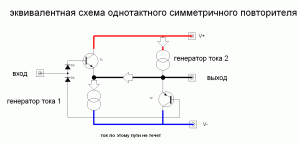

It is a kind of paralleling two modified JLH class A amps.Consider your schematic on the far left In post#1, I hope that I understand it as follows:
- Has a voltage gain of 1.
- Each unit is a voltage source power amp and a current source power amp operating in parallel. The bjts have their opposed emitters and their opposed collector nodes joined so as to make the power output node...

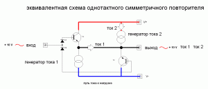

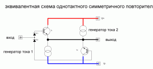

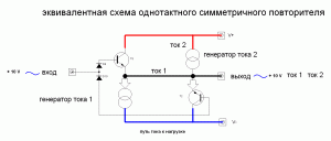

Brief description of the operating principle of a single-cycle symmetric povtoritelya.Ustroystvo consists of two single-ended repeaters performed on transistors T1 and T2 and the current generators 1 and 2. Here we assume that the interaction ( overflow ) currents between the left single-cycle repeater N - P - N and right channel single-ended repeater P - N-H channel is not happening. However , we assume that the left and right single-ended single-cycle repeater repeater at the same time give to the load current .
Power generators 1 and 2 are set to the current 2.5 amps. Suppose that at a given time on a device input signal goes positive . In this case the load current flows . Assume that a current in the load at this time is 1 ampere . This load current will consist of two currents.
0.5 amps will flow out of the transistor T1 and 0.5 ampere flows out of the current generator 2 . While simultaneously decreasing the current generator 1 to 0.5 amps. The total current through the transistor T1 will remain unchanged and will be 2.5 Amp , the same thing will happen with the right shoulder only in the opposite sequence. In this case you can see that the total current consumption device remains unchanged.
So regardless of output power , up to output short circuit , the total current drawn by two single-cycle repeaters will not be changed.
All this increases system efficiency to 50%, reduces the harmonic distortion.

Right. However, the formed new properties. Symmetry. Precise quiescent current. Accuracy maintain current 2.5009 A.It is a kind of paralleling two modified JLH class A amps.
It's a fine mixing of PNP and NPN quasi-symmetric OPS. Nice way of using transistors to set the VBE and drive at the same time.
Hellofranzm. Most interesting, I was also thinking of your approach yesterday.It is a kind of paralleling two modified JLH class A amps.

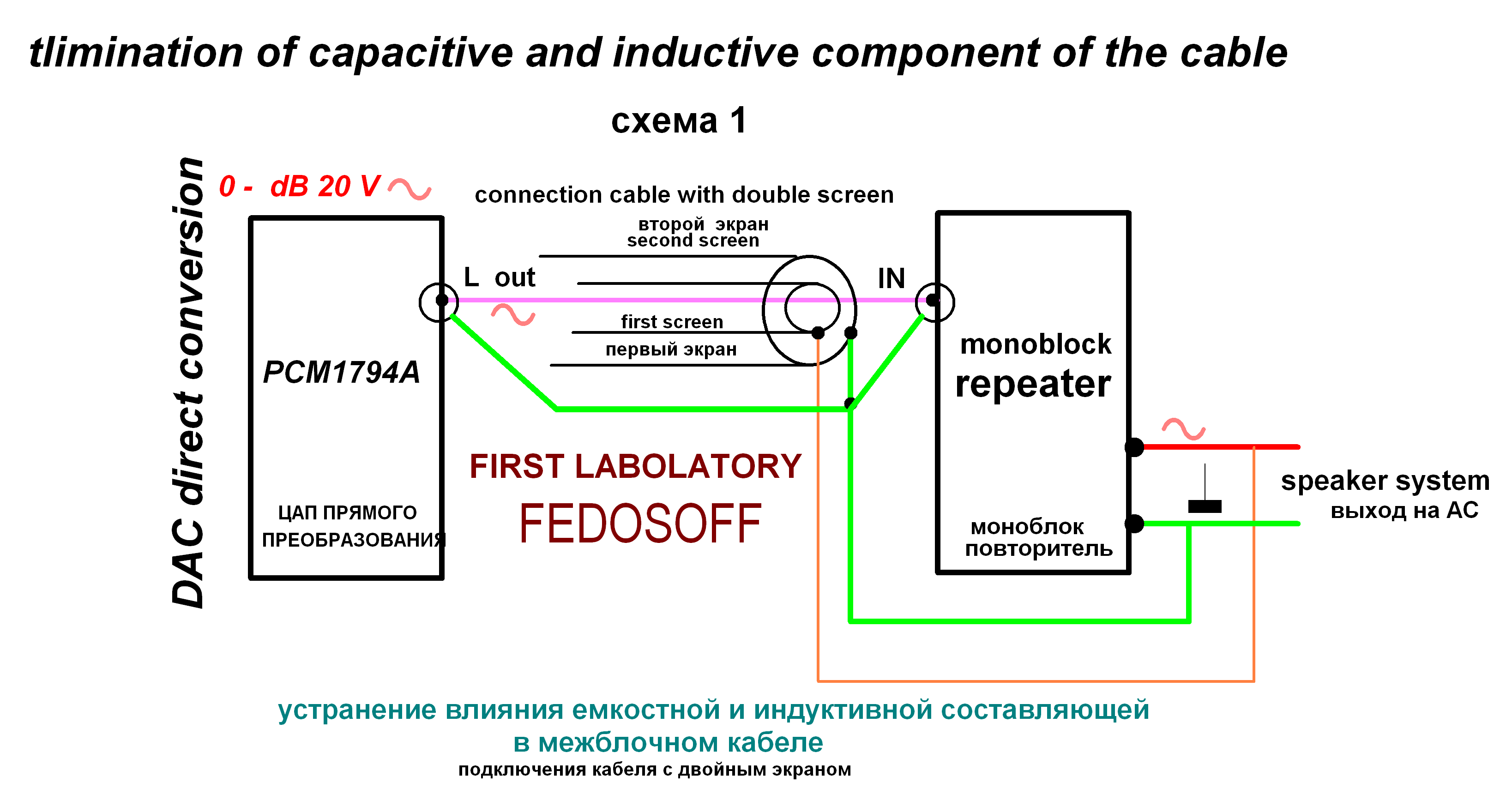

Hello colleagues . I would like to draw your attention to detail in the repeater unobtrusive . Input jack . Here too there is an original solution . In Schemes 1 and 2 show an embodiment of the connecting cables with dual screen . Huge input impedance repeater with FET input allows to connect the original interconnect cable . This connection considerably improves the transmission of high frequency signals - fronts . Current chip RSM1794A mono inclusion is 13 mA. We can now directly connected to the current output RSM1794A our repeate. For the functioning of modern sound systems are used interconnect connectors are one of the audio components .
The actual quality of the amplifier is primarily determined not only by its own linearity , but also interconnect connector input parameters , ie its inductive , capacitive and active component .
In existing amplifiers , including in terms of HIGH-END power considered in itself , and interconnect connector is regarded as a separate accessory . Meanwhile, the interconnect connector is not a separate accessory , but actually an integral part of the input amplifier circuit and an integral part of this can sometimes reach considerable length with all the ensuing consequences. That is input circuit becomes significant , inductive , capacitive , and resistive component , which occurs during the passage of a structural change of the input signal , which is a stream of complex pulsed signals . In HIGH- ENDe , in recording studios is a structural change of the signal is clearly unacceptable. Thus, the conclusion is obvious , it is necessary to interconnect connector , seen as a continuation of the input circuit of the amplifier.
Connectors interconnect geometry - a coaxial cable, and physically - distribution line with distributed parameters and available reactive components. Inductance and capacitance of a line across the frequency range should be as close to zero values . With regard to the active component, it must also be set to zero . To minimize this line in the physical point of audio amplifier requires an infinite input impedance compensated reactive component line - interconnect .
Scheme 1 and 2 show how much input impedance implemented 109 - 1010 ohms compensated reactive component of the line , ie interconnect , which led to : the elimination of the dielectric losses in the cable at frequencies of 1 kHz - 10 MHz , Close to zero is an impedance interconnect and eliminated its capacitive and inductive component , ie "Lack of debris at the entrance means no garbage output. Thus implemented postulate Ivor Tifenbruna «garbage in-garbage-out» »
Besides the use of dual-screen lowered level induced interference . Predetermined level settings stored for a wider range of frequencies.

Hello colleagues . I would like to draw your attention to detail in the repeater unobtrusive . Input jack . Here too there is an original solution ...
Like this? (page 4 of original document)
http://www.ti.com/lit/an/snoa664/snoa664.pdf
Compensator thing known. However, rarely used in home equipment. Sincerely.
