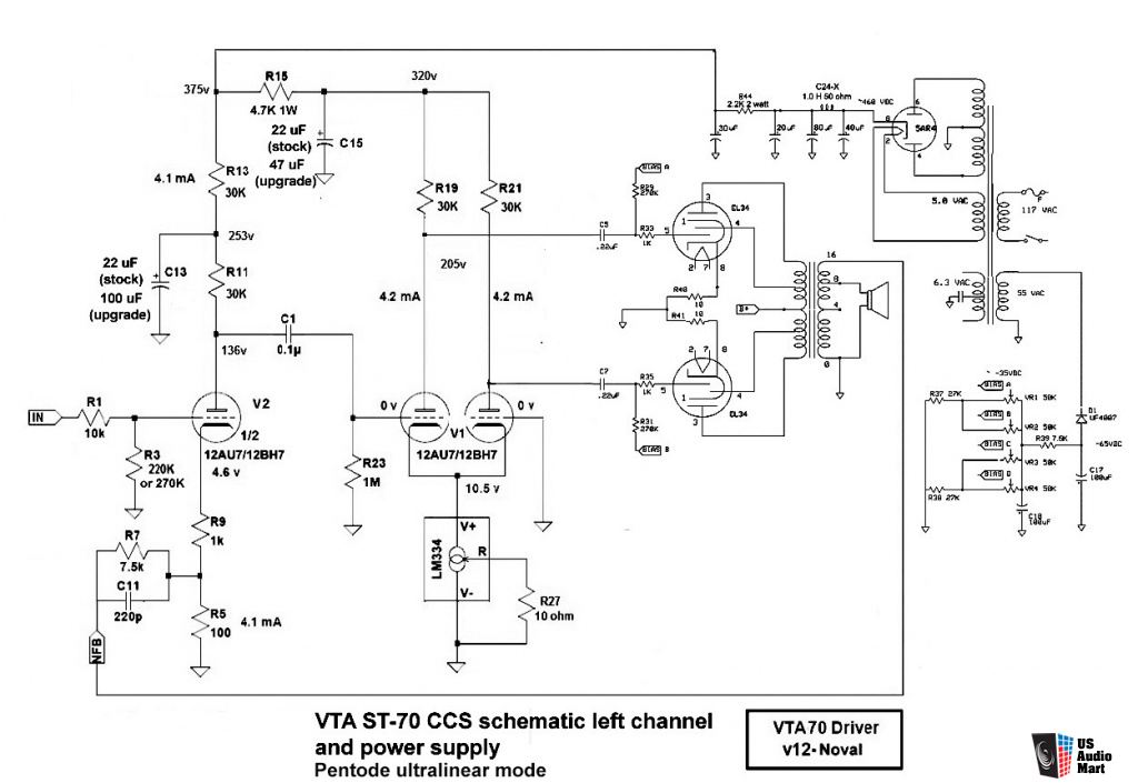

I have a pair of Dyna/VTA 70 "twins" that I use as single channel mono blocks. Can I safely remove the driver tube from the side that has no output tubes, or will that cause an issue with the rest of the circuit?
The original ST70 used 50mA cathode current (plate + screen) for each EL34 (200mA total).
The KT88 (shown in Post # 1?) would have to be adjusted to a more negative fixed bias voltage, or the current per KT88 would be more than 50mA.
Perhaps that is OK, since there is only one channel operating.
More current into the 2 KT88s, will tend to bring the B+ back down closer to its original voltage (with 4 EL34s).
One question is: What sounds better, KT88s at 50mA each and higher B+; or KT88s at 70mA each and slightly lower B+?
. . . Just thinking out loud.

Excuse me, but can't you bridge these amps like the original? That would make more sense.
12AU7 in both input and splitter have low gain; assuming a 6.6K UL transformerBTW, what’s the voltage gain of VTA-70?
7.5K/100 Ohm=75 times? It seems too big for an amp.
open loop gain: 27dB
closed loop gain: 2.4dB
so only 3dB of FB, just enough to halve THD and reduce output impedance from 3 to 2 ohms.
Do you mean 24dB closed loop?12AU7 in both input and splitter have low gain; assuming a 6.6K UL transformer
24dB is about right.Do you mean 24dB closed loop?
Based on the VTA-70 review, the gain at 8 Ohm is about 22dB.
These amps can be bridged, but running two output transformers in series tends to not sound as good.

Those were not KT66 tubes, were they?
Yes, those were KT66. This amp won't run KT88 as-is.
