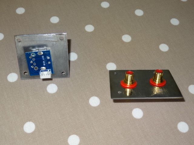

I have routed all the holes for the drivers and the ports. The Jordans are rectangular, so I had to make a jig for the routing. Also, there is not much breathing space for them, so I ground the wood away behind the baffle. It worked quite well.
Tomorrow, I will make all the other holes for the LCD screen for the amp, the power switches, RCAs, the IEC socket, grille attachments etc. I am also going to put a very slight roundover on all the sides of the cabinet.
