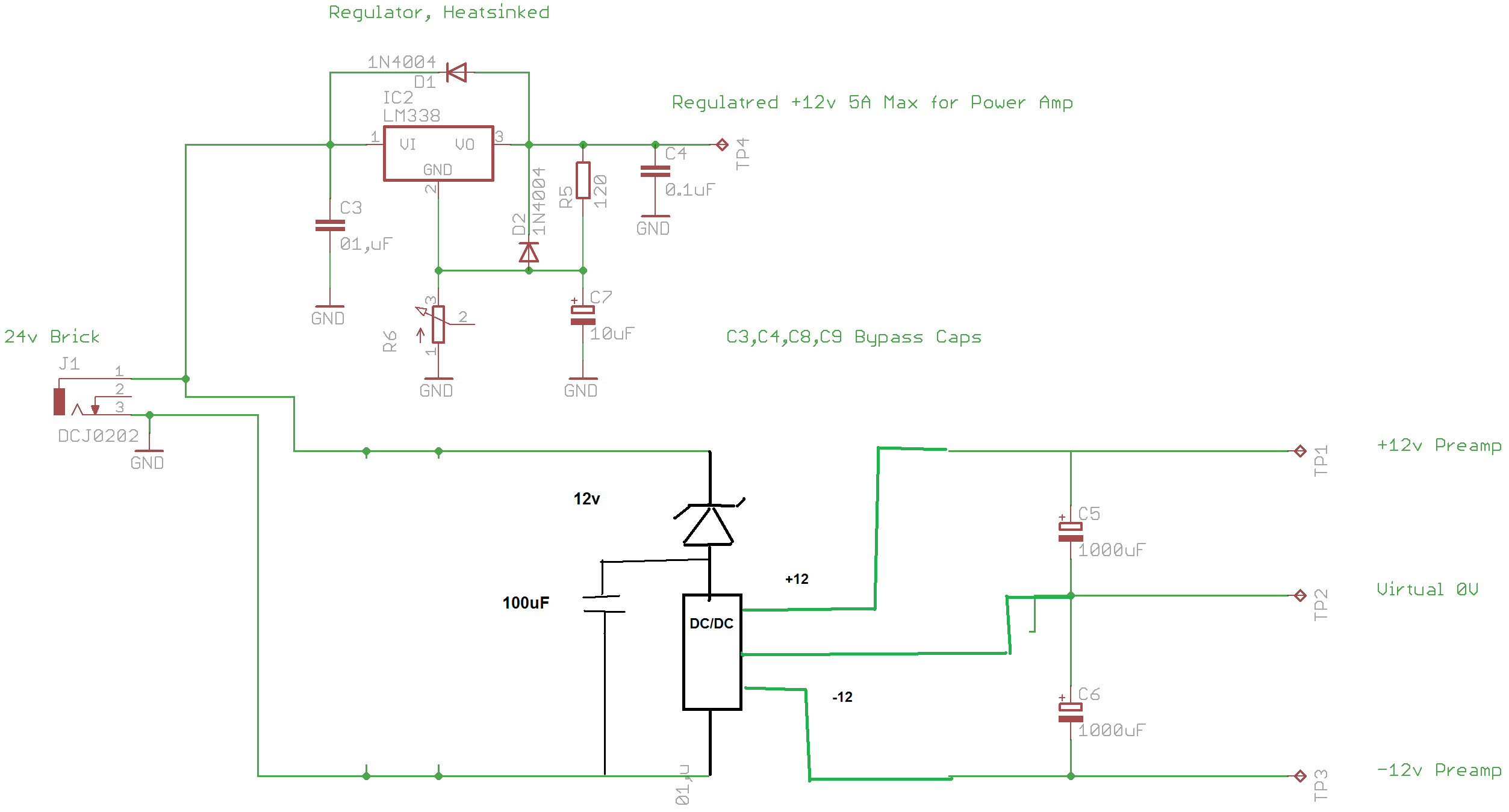

Ok so, i worked a bit on the schematic and i think much of the incomprehension came from my poor skills rather than actual problems, i apologize for that.
To draw this schematic i copied information from:
- LM338 Datasheet for the single rail +12v part
- Rod Elliot's Project 43 - Ultra Simple Split DC Supply For the dual rail part of the schematic.
- I added bypass caps everywhere was suggested to but not shown in the schematic, that would be Ceramic Discs 0.1uF: C3 and C4 on the LM338 Regulator, and C8 and C9 on the supply pin of the opamp
So here is it, what did i get wrong this time?
Thanks for your feedback!
Your "virtual" 0 volt line is at +12 volts relative to the "Gnd" points. Each part of the circuit is fine looked at in isolation but will not work together as you want.

The zener drops 12 volts thus giving 12 volts across the convertor. The input to these devices isn't critical as long as it's within the recommended range.

I believe my second schematic is correct according to Rod Elliot's site?
Like this. Now your virtual earth point can be connected to ground giving a true -/+ supply.
Wait. The dc/dc converter you linked has an input voltage of +12v and can output a +/-12v? But then i don't need 24v anymore.
I only used 24v in the beginning because rod elliot's split supply used 24v to obtain +/-12v. My laptop brick has selectable output, i can very well just buy that dc/dc converter and use +12v straight from the power brick!
I could then have the poweramp fed directly from the dc jack (maybe with *minor* regulation, requiring no heatsink), and use the dc/dc converter to have a *real* dual power supply!
Is this correct? am i understanding this correctly?
Yes it just needs a single 12 volts input to give the -12 /0/ +12 output...
I have to go... but it really is that easy.

Just don't connect Virtual 0V to 0V because they are different DC potentials.
Its not that easy as both are used as reference points for the audio... they have to be connected. Can't think of an easy way to explain it 🙂

As said before, it will work if you AC couple the pre-amp and power amp.
(Just fix the small error: R1/R2 junction should tie to the +IN, not -IN, of the opmps).
But if your brick can do +12V, the DC-DC convertor solution of Mooly is much more elegant.

I'll fix the schematic as soon as possible, but i think i'll go with Mooly's solution. Would it be a good idea to regulate the 2 rails after the dc/dc converter as well? or would that be overkill?

You have many options... you could go with a 15/0/15 convertor and use 78and 79L12 regs. The 3 volts is sufficient headroom for these to work well.
You could just use a simple R/C filter feeding the opamp rails.
Or just use it "as is" with suitable caps on each rail.
Or again with a 15 volt reg you could use a resistor/zener/cap arrangement which in many cases for low currents is a very good option... this "shunt" arrangement is the one I use in my integrated amp.
