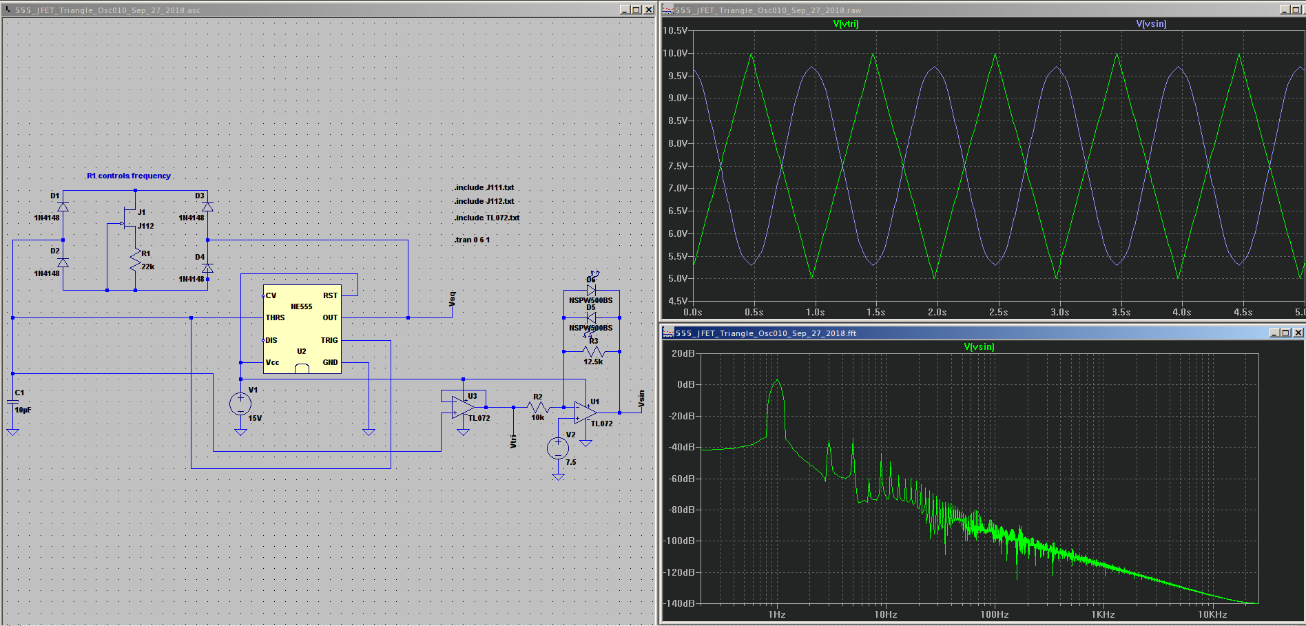

Here you go (LTSpice simulation only). It works, but needs seconds to settle down, and even with a JFET servo loop to control gain, I get lower sinewave distortion and quicker start-up by shaping a triangle into a sine. The triangle-to-sine approach also requires considerably less circuit complexity.
The usual caveats apply - this is only a simulation, and the real thing might not behave exactly like this.
My personal guess is that the heterodyne approach will also prove a very tough nut to crack if you want to generate beat frequencies as low as 0.5 Hz, because the two oscillators will want to lock up and generate a zero-hertz signal instead. If I were a betting man, I would give you long odds on this actually working.
IMO a relaxation oscillator of some kind is the way to go for this application, whether made with solid-state, or hollow-state devices.
I guess time will tell. :)
-Gnobuddy

Rectifying and filtering the output of the oscillator to make a (nearly) DC control voltage is/was routinely used with the LED/LDR and JFET stabilization methods. But adding the extra poles in the servo feedback loop tends to make settling times long, and/or lead to outright servo oscillation, with the LFO producing amplitude-modulated output, or short bursts of sinewaves with dead silence in between!
One of the approaches suggested in this thread was to use a 3RC oscillator with a six-phase rectifier. With so many phases, what comes out of the rectifier requires only light filtering to become almost pure DC. So it is still capable of the fairly rapid changes needed to make a stable servo loop, so the LFO output has a reasonably fast settling time.
Personally, I think Rod Elliott's "miniosc" is an excellent solution for the purposes of this thread. It's relatively simple, distortion is far lower than necessary for this application, and Mr. Elliott has been nice enough to provide a proven schematic that only needs to be tweaked slightly to lower the frequency range: Miniature Audio Oscillator

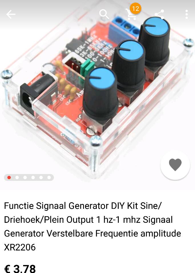

If you search for signal generators on Amazon, you will find XR2206 modules for $10, but XR2206 is a rounded triangle wave, not very clean. But they also have a DDS box for $30, which will be more than you need. Of course you can use Audacity etc. on your computer or a RPi to generate sine waves etc.
But maybe you just want to tinker, in which case just make an amplifier with AGC / compression and add a phase shift feedback. Such is the essence of analog sine wave generators. ~70 years ago, HP started with a tube circuit that was one such, and used an incandescent lamp for automatic gain control. HP Virtual Museum: Model 200A audio oscillator, 1939 HistoryP
