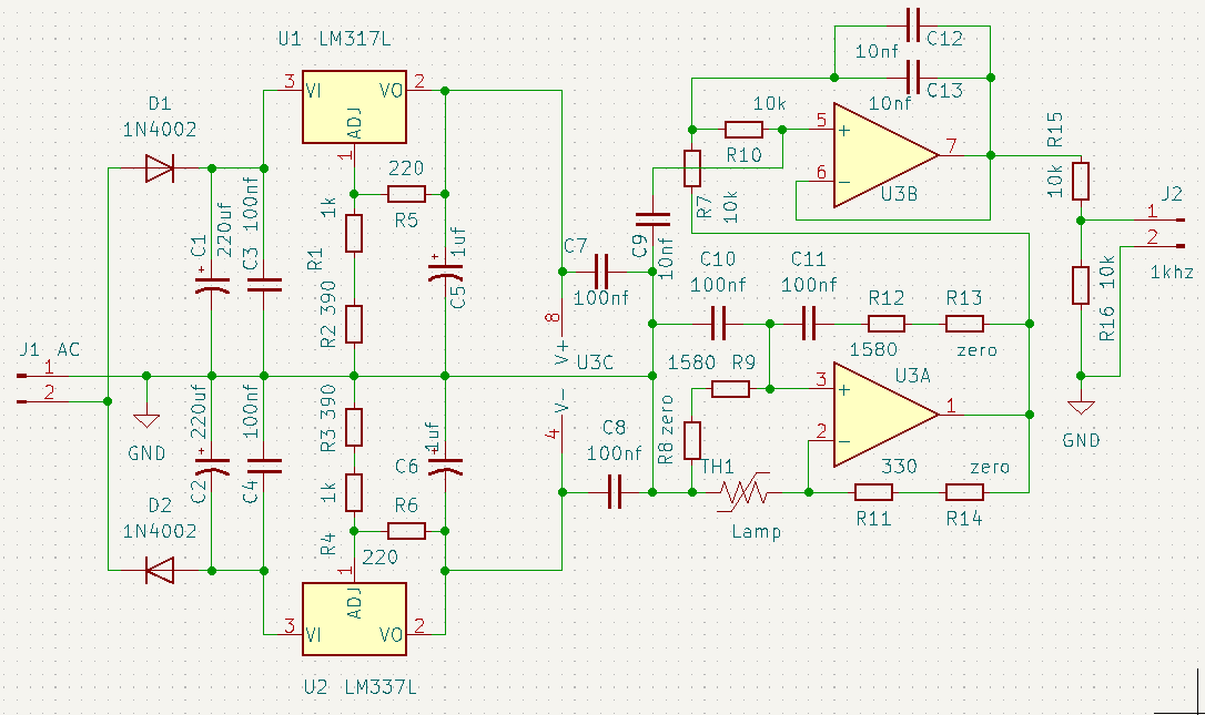

The sine oscillator in the LM4562 document is only a model. Can it be made into a stable 1khz circuit without using the lamp which is supposed to prevent distortion. I have been reading about various solutions. They seem to be rather delicate.

What's your application? If distortion around 1% is ok, just do the lamp.
The lamp will last a long time, since it's never lit up much if at all.
It can even be soldered in, no socket.
Though the Bubba can be made with one quad op amp. Try both.

Bill Hewlett build HP around that simple oscillator. It does work and getting low distortion is possible. The lamps run at a fraction of their rating and should last as long as the device would be useful. Finding an optimum lamp is important. Its actually more linear than any of the other AGC solutions but its response is slow so stability in output takes a while.

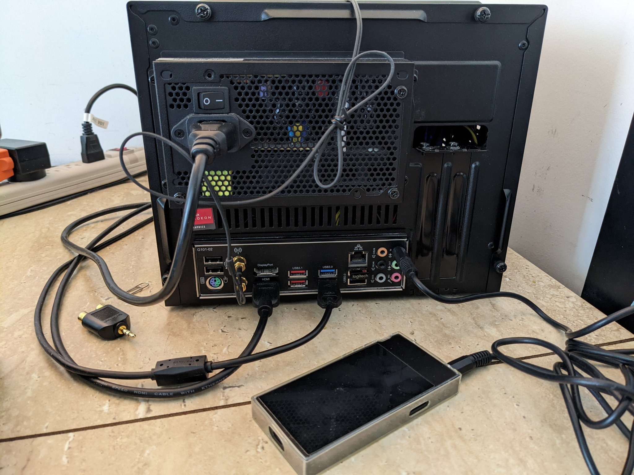

Thanks, I don't have a laptop I have a mini-itx cube chassis with AB350 mobo having Radeon 3 integrated graphics. There are no gaming components, i just like the compact format.

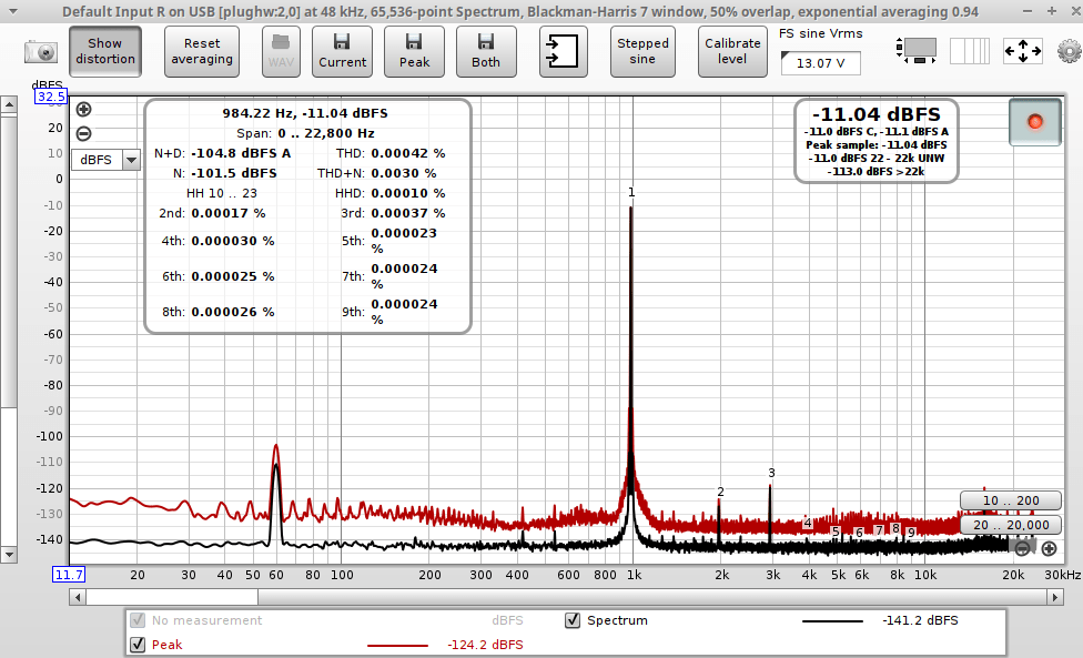

The mobo has a Realtek multi-channel ALC1220 codec which is said to have a 120db SNR. I am skeptical about real-world usage. XRK971 has found these devices have too much noise. I attach cards.txt which has a list of channels and functions. It is interesting that if one has an external USB DAC, the codec is responsible for streaming so it is essential and cannot be fully bypassed.

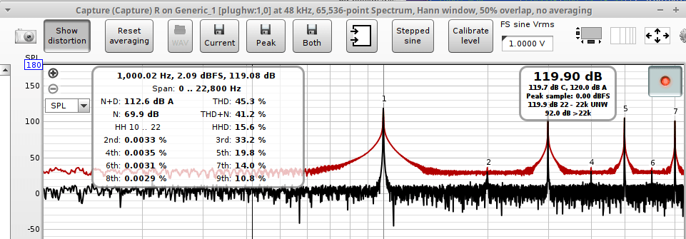

I attempted some REW measures. I find it too complicated. It should be more modular with modes for specific purposes that don't activate multiple option panels. So I muddle and hope for REW-lite.

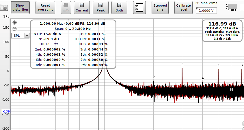

- shot 2 .. using REW generator which has dominant odd harmonics

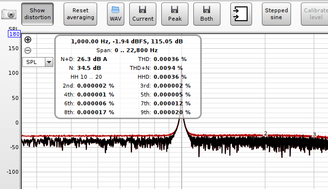

- shot 3 .. FFT of Audacity WAV file (which REW calls MDAT)
- shot 4 .. same WAV send from FIIO M7 to the mobo line input.

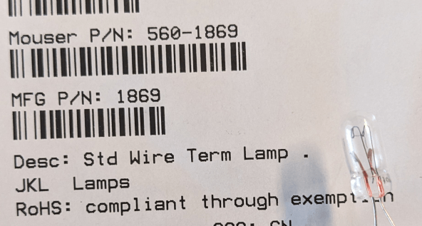

Mr Heuvel has an interesting investigation into the Wein network lamp oscillator. His lamp choice is better than the old #327.

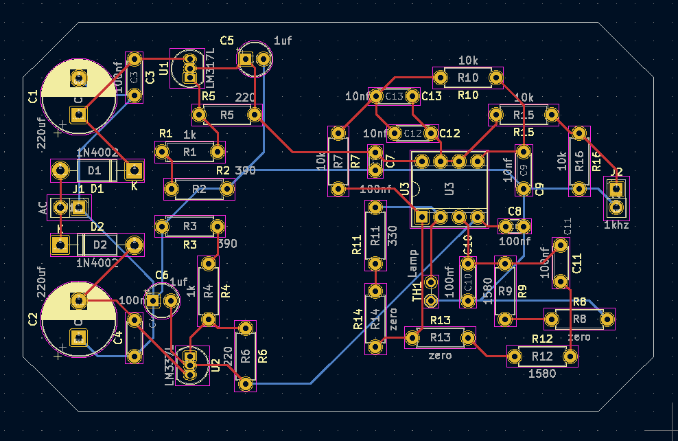

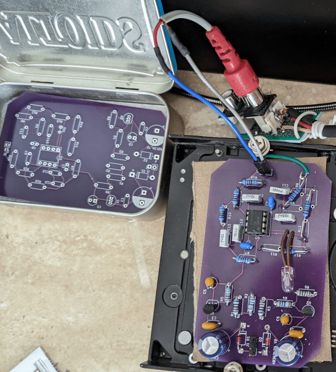

I usually solder parts onto a grid board. This time, for a change, I am tinkering with KiCad to design a PCB.

First there was a minimalist green PCB (KiCad) that was promising. It used half 4562 and 78/79 L15 regulators. Now there is a larger purple PCB that adds a Butterworth filter to reduce the 3rd harmonic. This version operates at +-9.1vdc and could be modified to use batteries. I cut the PCB to fit an Altoids tin just for grins.
Many of the resistors are elevated for ease of replacement and for convenience of probe clipping. There is an option to combine 2 resistors for a single values in the oscillator circuit. Otherwise 1 resistor can span the footprint of 2 resistors. The 317-337 are adjusted with 2 resistors .. 1k+390 = 1390 which gives 9.1vdc.
The PCB can work with 9.5vac, 12vac, or 16vac. The choice of regulators, fixed or adjustable, does not matter. However, when powered for +-15vdc, the 4562 and regulators feel hot if touched for more than a few seconds. There is no need to run hot since it would only require more output attenuation .. no advantage.
I tested the oscillator with REW. The U3b Butterworth filter is optional but 3rd harmonic is 20db higher without it. I might be suitable for casual use. One can always buy a slightly better oscillator if there is no interest in DIY.
