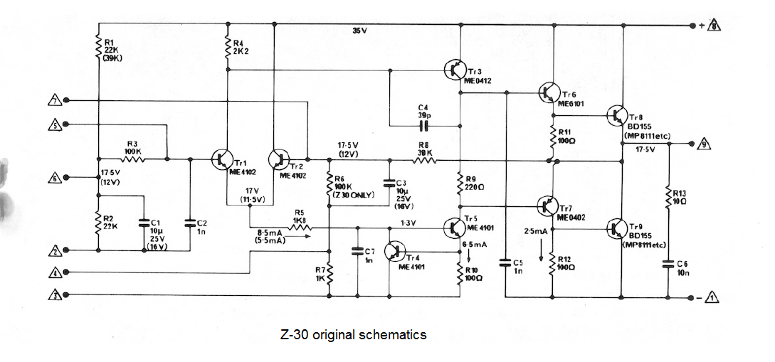

Several years passed and after I finished my university studies I was still an enthusiastic DIYer and I have returned to the idea to build Z-30. So I took an original schematics

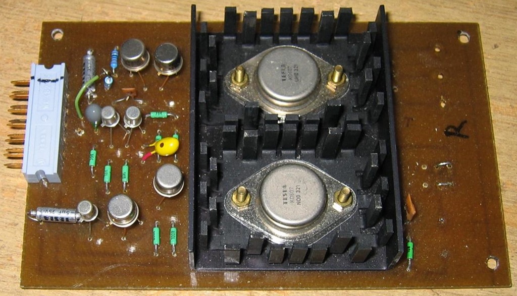

made some small mods like modification to +/- DC power supply (to get rid off the output coupling capacitor) and also changed the transistors, as the originals were not available here. This was probably a good idea, as my power transistors were more robust. And this was the result, in 1980

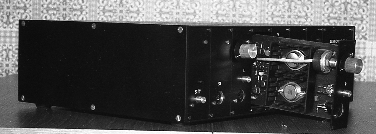

I have chosen a modular concept, with a motherboard and modules that could have been changed to make different amp configurations. There was an RIAA phono module, linear preamp module, bass/treble equalizer module, two modified Z-30 modules and a power supply. All except for Z-30 were my designs. It took years to realize the project and this was the result in 1987
The amplifier was working well and had served me till 2001, the year when I returned to DIY hi-fi and realized to build something more advanced. The amp shown suffered from 2 major issues
the heatsinks were too small and continuous available power was thus reduced (similarly as in nowadays miniature TPA3255 amplifiers)
due to absence of Re resistors and poor idle current stabilization the idle current had to be kept very low, in order to prevent thermal runaway and destruction of power transistors. As a result, there was the crossover distortion. The same issues applied to original Sinclair modules.

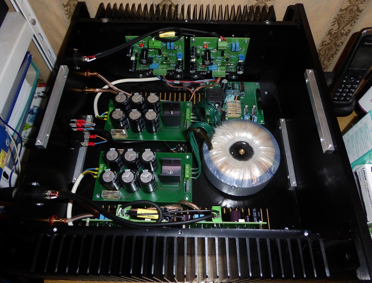

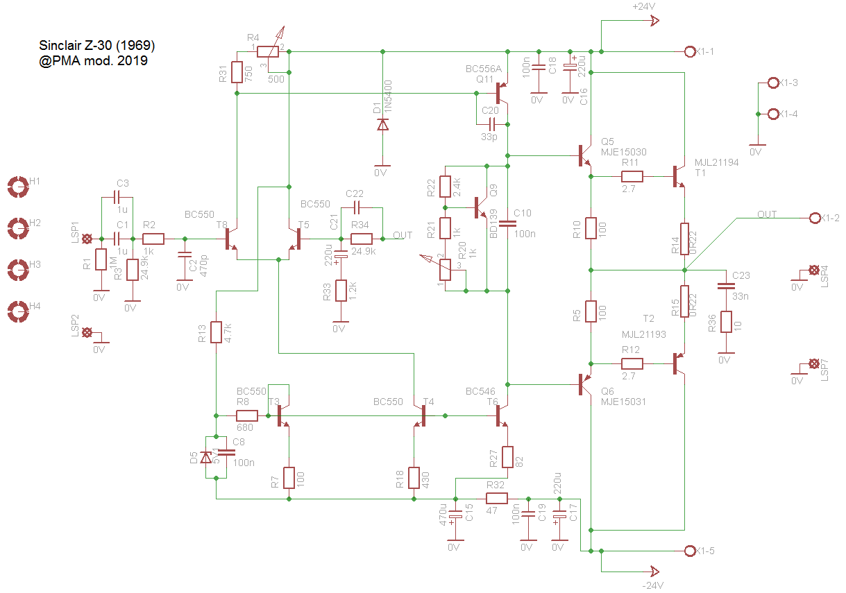

Sinclair Z-30 rev2014 – my 45th anniversary project
In 2014, I got an idea to wipe dust from the Z-30 project and to make some modifications and make it a reliable amplifier with continuous maximum power capability, thermal stability and optimal bias of the output stage, to get rid off the crossover distortion.
This was running pretty well, with power specified at 50W/4ohm, thermal stabilization of idle current and appropriate heatsink.
Z-30 2019, last mod 50 years after
And this is my last (as for now 🙂 modification from 2019, 50 years after the original Z-30 was issued.

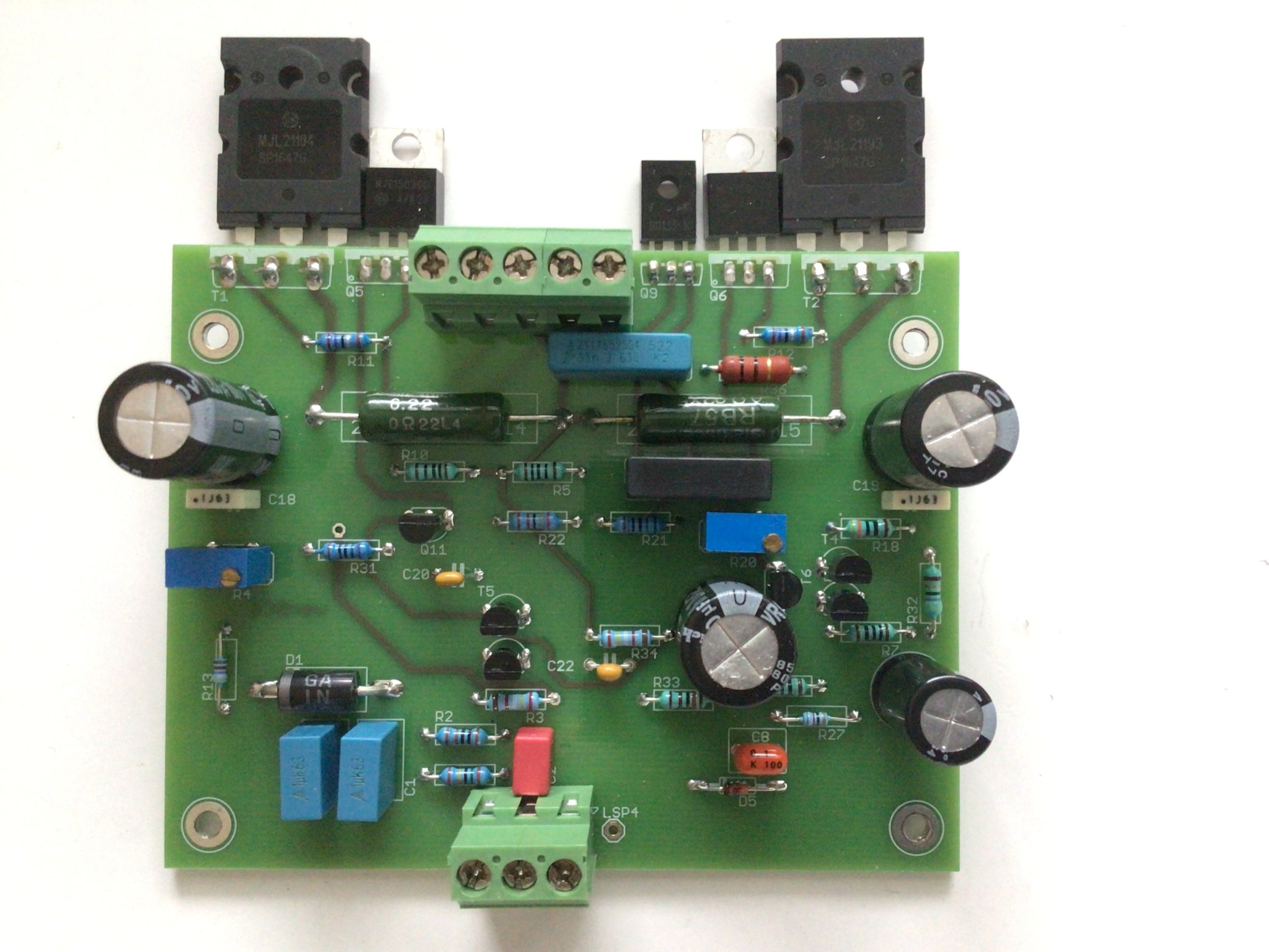

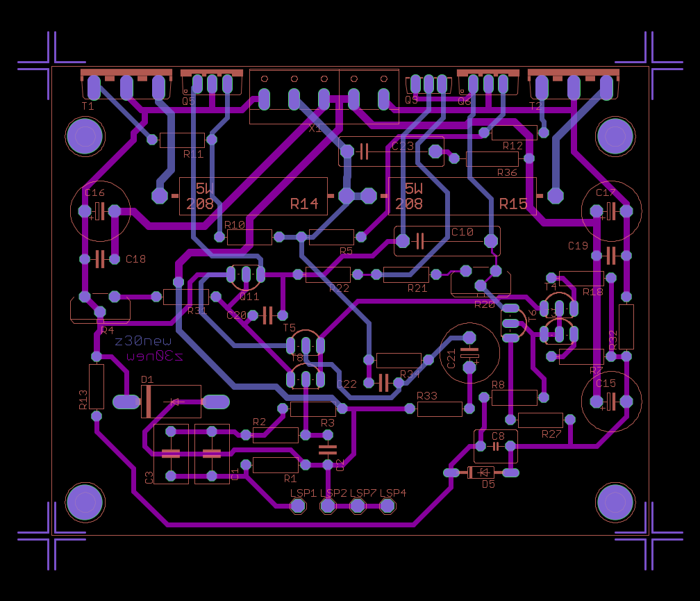

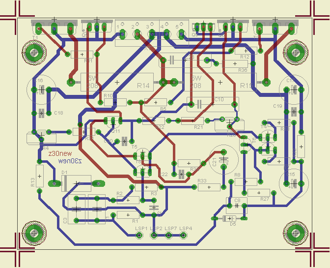

Schematics and PCB - this is the valid project schematics!
(Gerber files are attached at the bottom of this post in the z30_new.zip file, as well as the parts list in pdf)

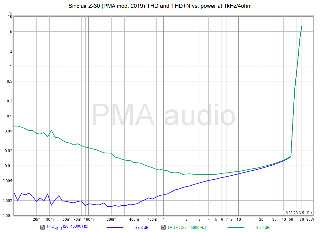

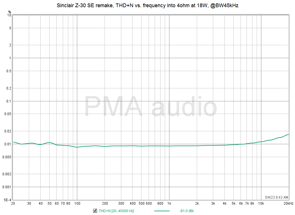

Measurements
THD and THD+N vs. power at 1kHz/4ohm
We can see that the amp gives 50W/4ohm
THD+N vs. frequency - pretty flat

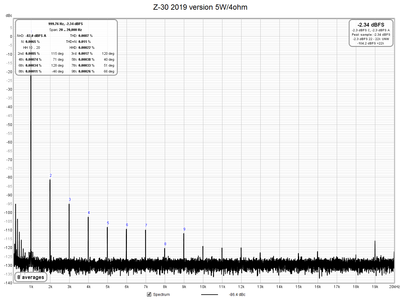

Distortion spectrum

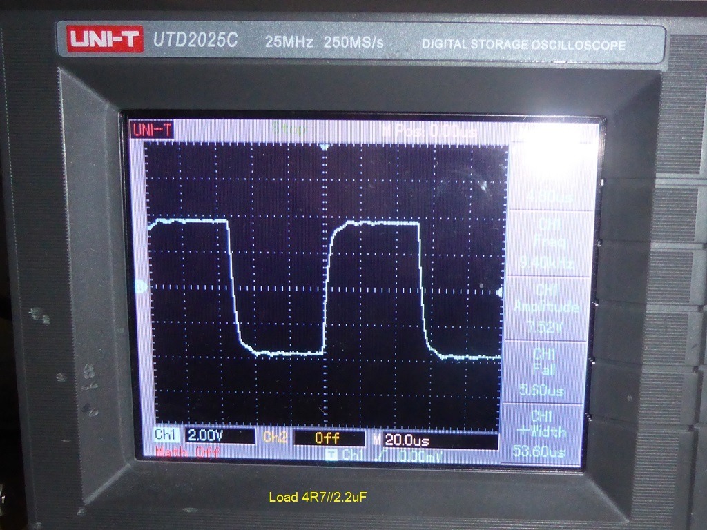

New: 20kHz square response
So this is my story of the Sinclair Z-30 amplifier. Even after 55 years, its basic topology is able to give good results. We have not moved much, since 🙂. Have fun with DIY!

Could it be the original quasi complementary output stage -without any countervailing measures such as Baxandall diodes or Quad 303 style triples- produced horrendous crossover distortion?
Yes it did because due to absence of emitter resistors and due to small heatsinks the idle current had to be very very low, in fact class B, otherwise the amp went to thermal runaway.

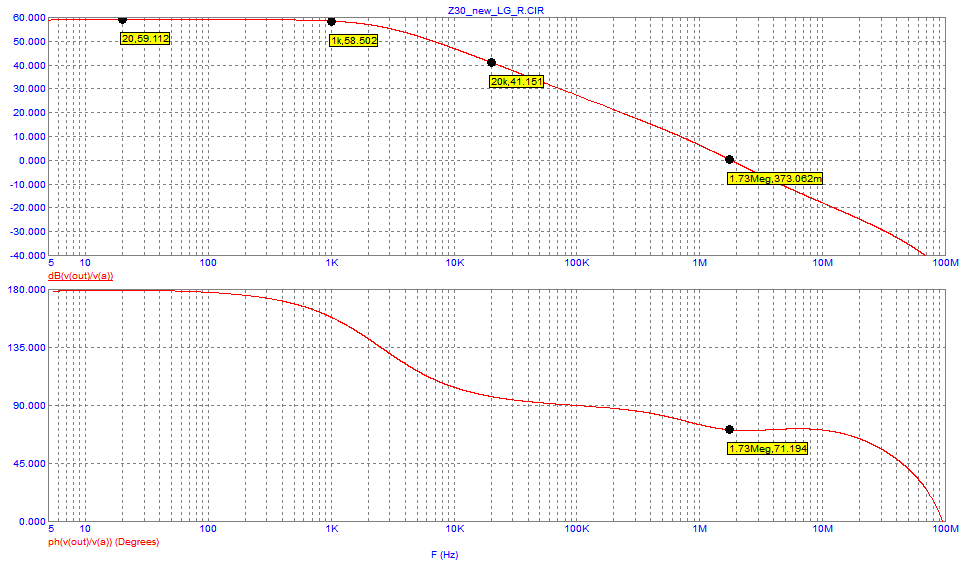

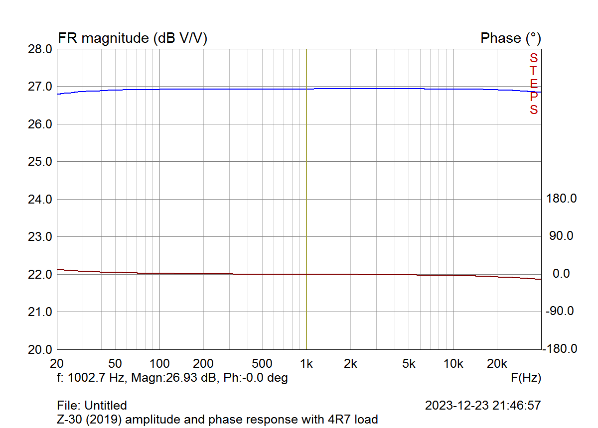

I forgot to post amplitude and phase response, so here it goes:
(one can read the gain from the plot as well)
This is measured as 2-channel measurement in STEPS. 2-channel method is a must, otherwise both amplitude and frequency responses are heavily influenced by DAC/ADC filter responses.

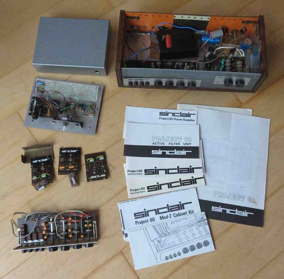

Project 60 brings back memories. The system was frequently seen built into the plinth of a Garrard SP25 turntable.
The attachment show a current UK auction listing.

Those Sinclair booklets breathed magic around 1973: for nostalgic reasons I kept those many many years. A guy in my neighbourhood, who owned the Z30, complained about blowing up the output stage more than once. Back in the day Elektor (Elektuur in NL) already paid lots of attention to crossover distortion, so I never trusted the Sinclair power amps output stage.
I did, however, home brew a version of the Sinclair preamp.
That was basically one of those more or less disastrous designs of the early 70s, there was another one at Elektor IIRC, a 20W amplifier without emitter resistances for the OS, some good ideas like an enhanced VAS and a triple transistor for the negative rail but result was still awfull.
The preamp is nice, though, with a real baxandall, these were inexistant in about all japanese amplifiers even from the late 70s because there was royalties for this patented circuit.

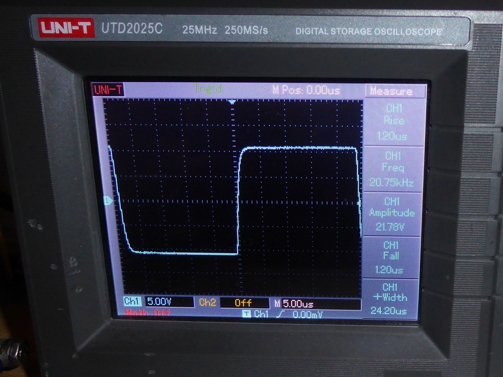

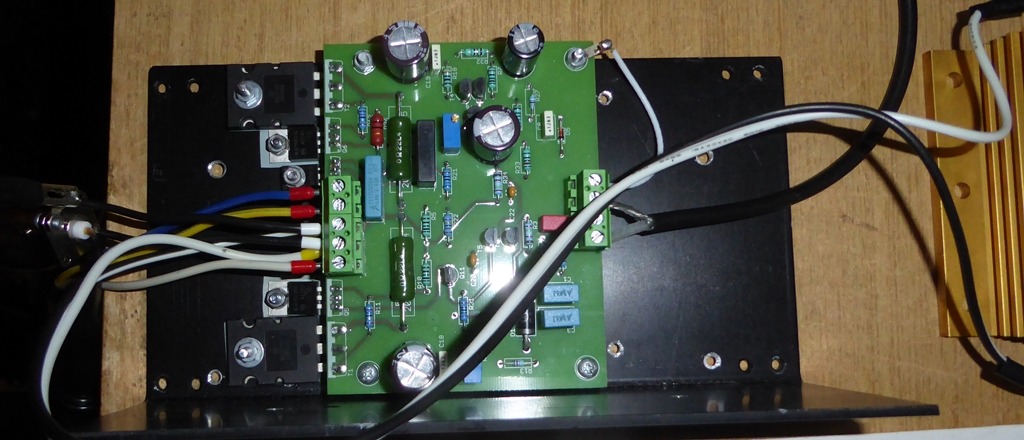

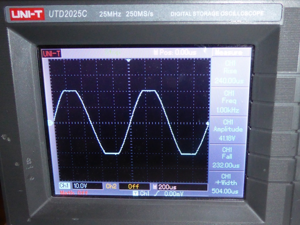

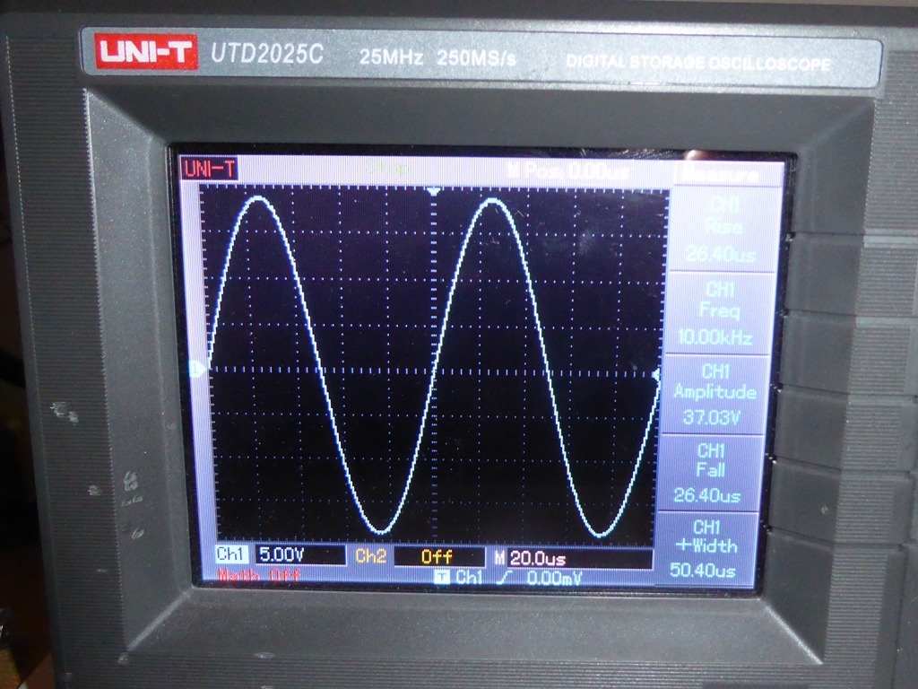

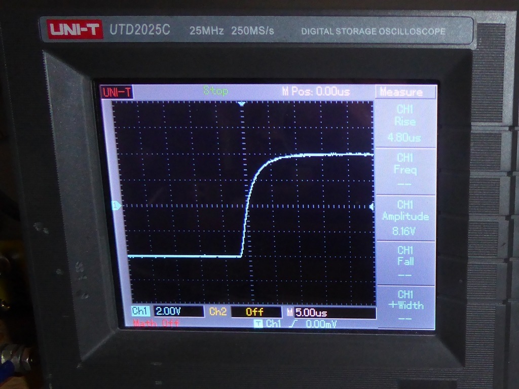

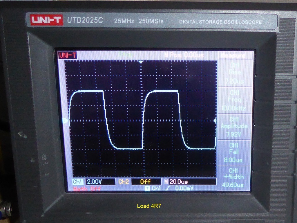

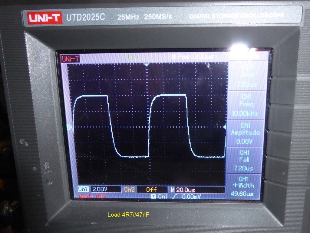

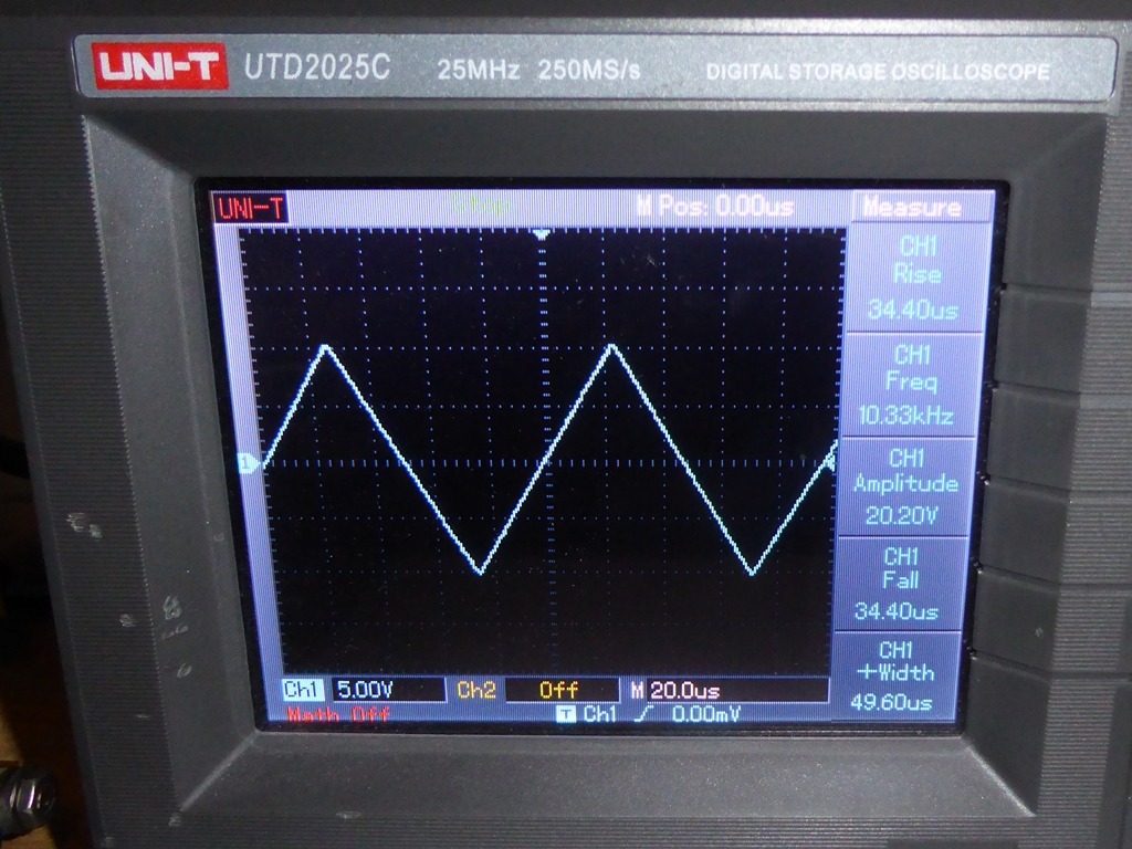

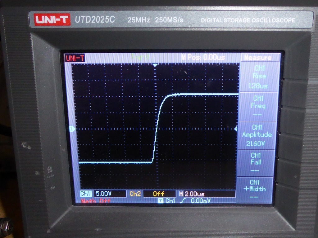

More precise measurement of step response rise time. Tr < 5us, F(-3dB) > 70kHz. Conservative, however prevents the amp from slewing. It can be adjusted by R2, C2 (post #1). I forgot to mention the idle current. I set 20mV across R14 (R15), so output stage idle current is <=100mA. The Vbe multiplier around Q9 keeps the idle current very well. C22 = 10pF.
Finally, the measured sample. I have had 4 modules that have been operated since 2019 without any failure.

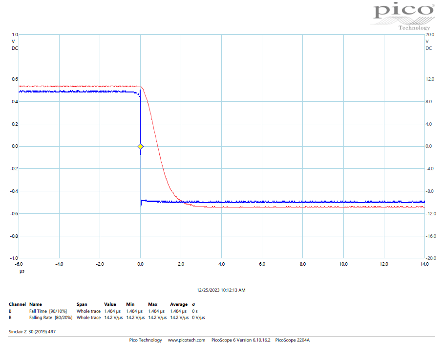

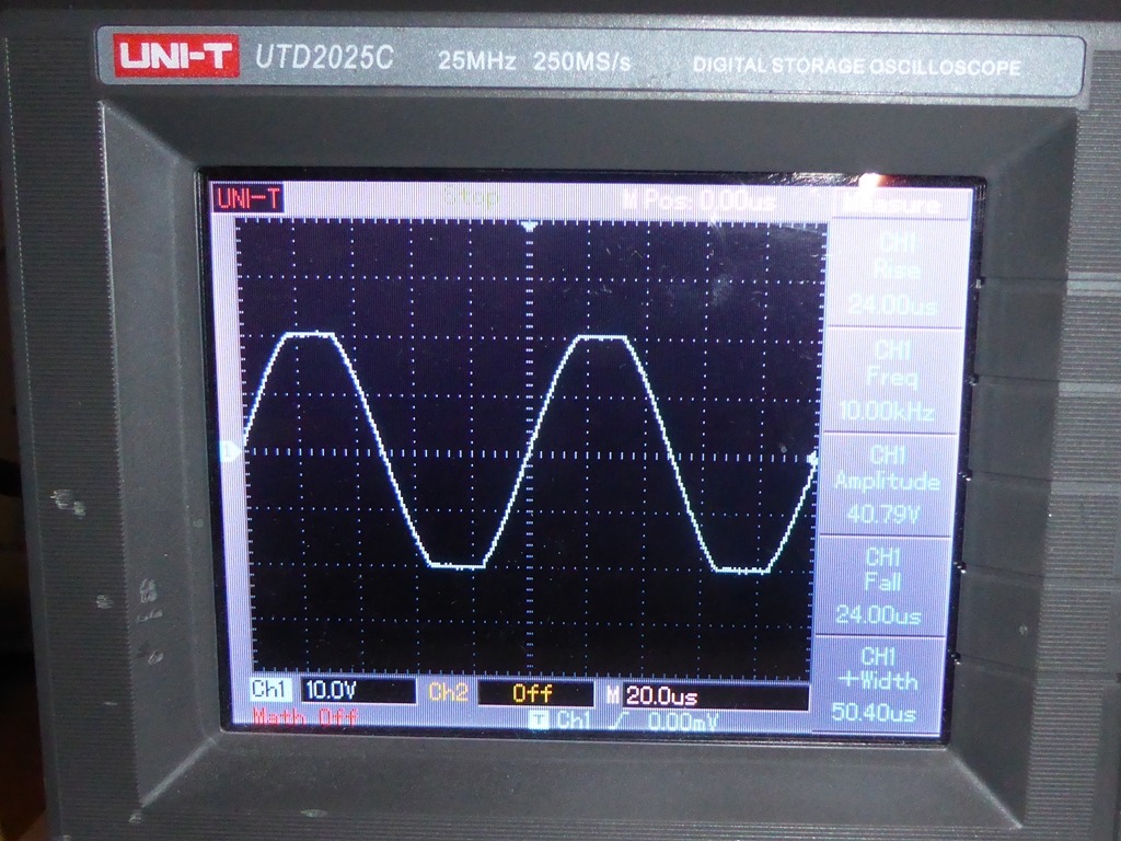

I had to repeat the time domain measurements and re-measure with a fast function generator with rising edges of 10ns. The previous measurements that I made with an audio generator turned out to be unreliable, with badly defined square wave edges. I apologize for that.
So, finally the correct results - rise time, 20kHz square response and 10kHz triangle response:
20kHz square
