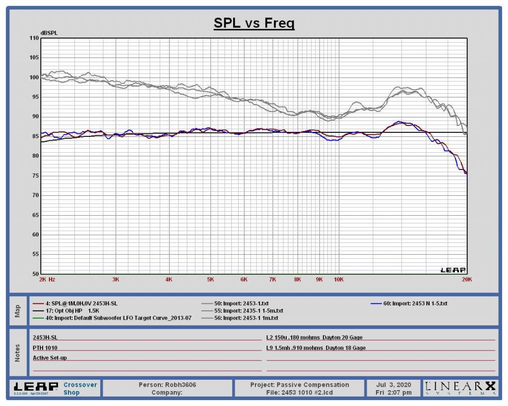

What i'd love to know, is how many folks think their (well made and repeatable) measurements ended up matching their sims?
My sims, even on very simple builds, have been close but no cigar.
Hello Mark100
What do you consider close?? If mine are in a db or 2 of the simulation it works for me. Taking a post build measurement is the only way to confirm that you ended up with what you intended by design.
Here is a comparison of the last compensation build I did as an example.
Red is predicted Blue is measured.
Rob 🙂
