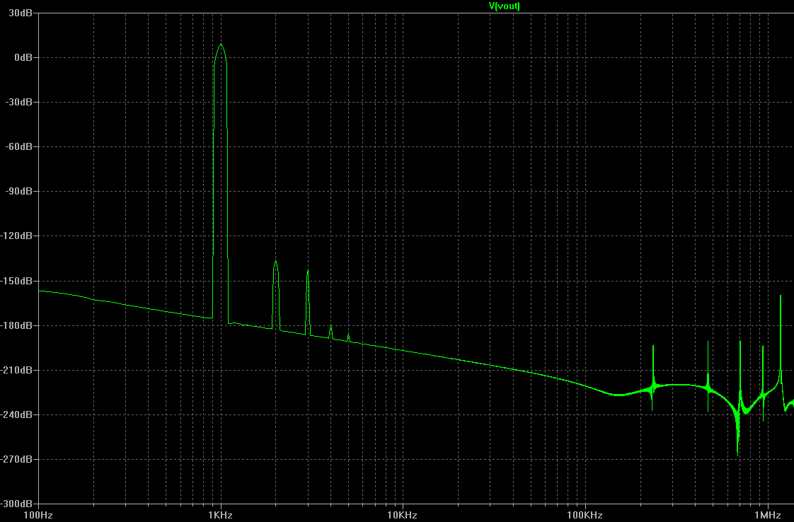

I fixed up the simulation with Bob C's Bd139/140 for outputs and added simulator
commands for distortion analysis. Output bias and operating points look fine now.
Download the old .zip file and extract it to a folder then add the attached file to that
folder so that you have all the old model files if interested in trying this.
Change the .param Freq= to the desired simulation frequency
Change the .param Amp= (1.414*3)/23 to desired RMS output amplitude in place of 3.
All other parameters for the distortion analysis are calculated in the model - easy to use.
Here is 1 kHz, 600 ohm load, 3 Vrms output, here is the harmonic and THD1 = 0.000006%
(60 ppb) data:
Fourier components of V(vout)
DC component:0.00357529
Harmonic Frequency Fourier Normalized Phase Normalized
Number [Hz] Component Component [degree] Phase [deg]
1 1.000e+03 4.242e+00 1.000e+00 -0.14° 0.00°
2 2.000e+03 2.241e-07 5.283e-08 -166.13° -165.99°
3 3.000e+03 1.126e-07 2.653e-08 53.55° 53.69°
4 4.000e+03 1.208e-09 2.848e-10 158.40° 158.54°
5 5.000e+03 5.602e-10 1.321e-10 -102.52° -102.38°
6 6.000e+03 1.792e-10 4.224e-11 -3.31° -3.17°
7 7.000e+03 3.056e-10 7.205e-11 -1.71° -1.57°
8 8.000e+03 4.276e-10 1.008e-10 -1.84° -1.70°
9 9.000e+03 5.414e-10 1.276e-10 -1.74° -1.60°
10 1.000e+04 6.496e-10 1.532e-10 -1.72° -1.58°
Total Harmonic Distortion: 0.000006%(0.000000%)

Same conditions 600 ohm load, 3 Vrms output,
THD20 = 0.000176%
Increasing output voltage 600 ohm load, 10 Vrms output:
THD1 = 0.000038%
THD20 = 0.000694%
THD20 = 0.000176%
THD1 = 0.000038%
THD20 = 0.000694%

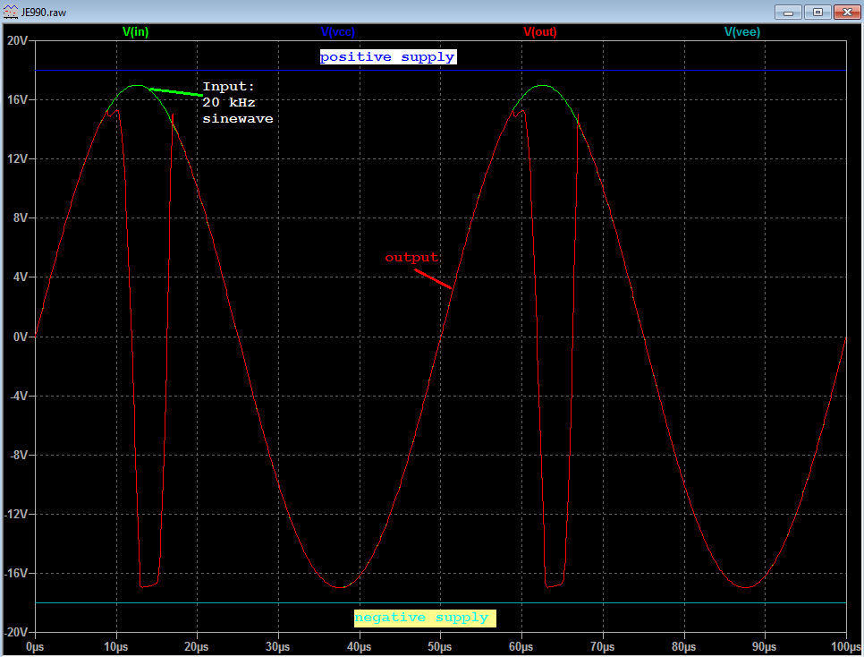

When I simulate the JE990 at unity gain, I get classical "phase inversion" instead of clipping. See attached LTSPICE results. It's fun to dig in to the simulation and figure out exactly how and why phase inversion occurs. Once you understand it, you can eliminate it.
The phase reversal story
Patent
tutorial
Why does it occur op amp output phase-reversal phenomenon?
Neil's list of bad actors
_
Patent
tutorial
_

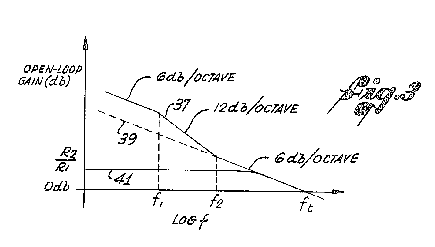

The inductors do have a specific purpose, read the AES article and you might learn
what that exactly is.
I might suggest if one has no idea what the inductors do getting a sim to work is the least of your problems. This topology has been around since 1966 i.e. no sims.
Scott, I know why the inductors are there.
The AES article mentions circuit analysis using an old HP program, don't remember the
name, and am too lazy to look it up again. They tuned the HF compensation with it.
Oh, I see you are referring to the earlier DOA that they based the 990 on, yes I mentioned
the prior art regarding the inductors in a previous post.

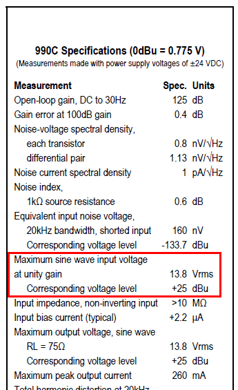

Mark - I'm sure you know that the 990 was intended for use mainly in mic preamps,
so I doubt that it would be used at unity gain. Not sure if it was spec'd for it and am
too lazy to look it up.
I observed it in the lab in 1980 in the old LF OP amps, had a professor who wanted us
to know about it.
Thanks, for the educational input.
to know about it.
Mark,
Thx for the links.
I see the list of opamps experiencing this CM range phase reversal is rather short.
I wonder if our favourites like NE5534, AD797 exhibit this phase reversal too?
I assume that AD797 does, since it is included in MT-036 note.
So I guess a question to Scott is, was there no way to remedy this in the AD797 design ? I could think of a few possible reasons, might be lame thinking.
1) maybe it is just the nature of the topology and it is best done externally with diodes
2) AD797 is not intended to be used as a voltage follower
3) extra cost, complexity
4) would affect its perfromance
Thx for the links.
The 990 datasheet permits unity gain operation and includes several GBW and risetime numbers specifically measured at unity gain. It avoids phase reversal by forbidding you to drive the input higher than (toprail - 4.5V) or lower than (bottomrail + 4.5V).
Doctor it hurts when I do this? Don't do that.
Ah, okay good point, thanks for looking it up.
I'll just point out that with the 990 on +/- 24V rails, the input limit is +/- 19.5V, not too bad.
But yes I agree, better to have a circuit that never does it.
