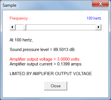

What would you want to know exactly? The electrical impedance graph as calculated by both WinISD and Hornresp tells you about the current. Just divide the applied voltage by the calculated impedance. Note that the impedance consists of both a magnitude and a phase.

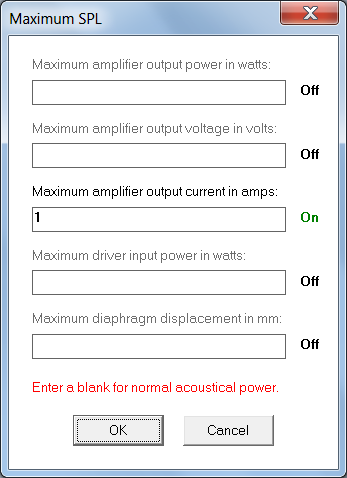

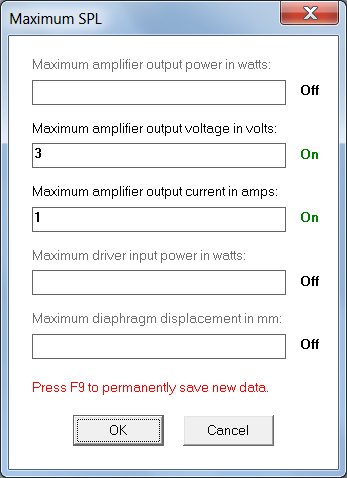

I would like to simulate the current thru the driver for a closed box and bass reflex.

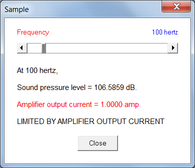

Use the Maximum SPL settings shown in the first attachment and then sample the response. This will enable you to find the current at any frequency, for an input of 3 volts.
