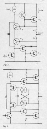

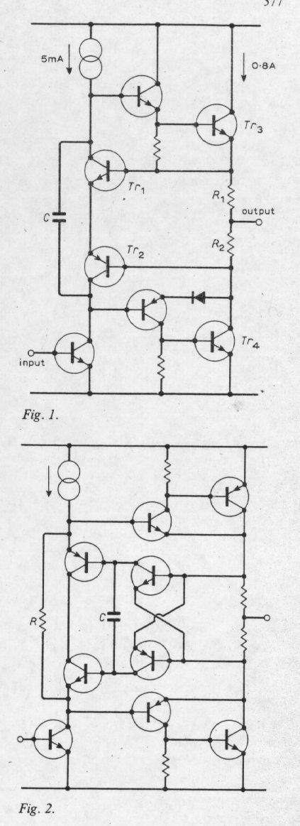

My favorite Allison circuits - part 1
I've been looking at Allison biased circuits for some time (2 years naybe), and while there are numerous ways this bias scheme can be used, I have several personal favorites.
The original article was published by W. Allison in Wireless World of December 1972. The two circuits he presented are attached. The first one (Fig 1) is the normal `Sliding Class A Bias' scheme which works very well. The second (Fig 2) was his attempt to reduce the voltage drop across the output resistors from one Vbe to 1/2 Vbe.
I've had a few attempts at getting the Fig 2 circuit to work, but I think that there is too many devices in the feedback loop and hence too much phase shift at high frequencies. It would be hard to make this circuit stable into typical loudspeaker loads.
My preferred Class A output stage is to incorporate the Bryston Quad-Complementary output transistor arrangement (see the second attachment). Here it is shown as a Class A headphone output stage, but changing the devices and using a suitable Re value would make a small and simple Class A output stage for loudspeakers. This circuit can be voltage driven as shown, or current driven by varying I1 and I2 (ie a typical VAS stage). Note - don't allow this circuit to go into Class B mode, as the Mosfet drivers turn off and inject horrible transients into the signal.
That's enough for these circuits, continued in part 2.
Paul Bysouth, September 2009.

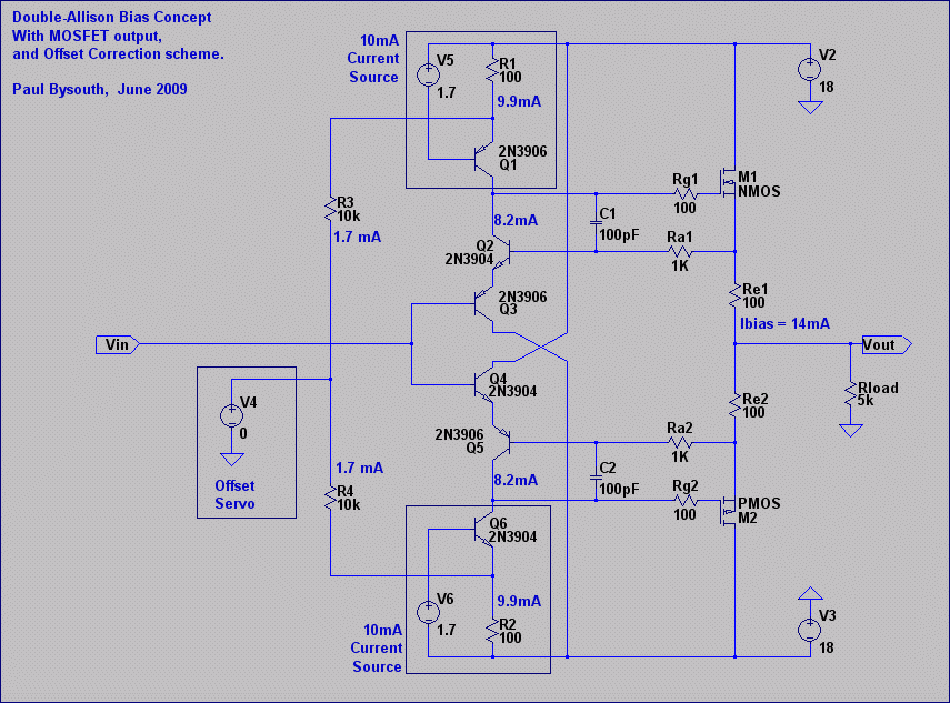

My favorite Allison circuits - part 2
My next favorite is a buffered input version that provides very high imput impedance.
In the attached circuit I've shown, as well as the Allison bias scheme, a means of implementing an offset correction scheme (V4 would typically be an Opamp integrator).
Note that this circuit has two Vbe drops across each Re resistor, and hence would not be suitable for driving loudspeakers. This circuit would however, be ideal as a preamplifier output or headphone amplifier.
Also do not let this circuit go into Class B mode, as one of the two input transistors (Q2, Q4) will turn off, and probably go unstable (highly distorted at least).
Continued in part 3 ...

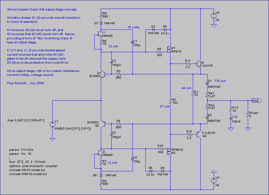

My favorite Allison circuits - part 3
The normal Allison `Sliding Class A Bias' scheme really only works for Class A (ie neither output transistor ever turns off), and if a transient pushes it into Class B operation, the distortion increases dramatically.
I've been looking for a suitable modification to allow Class A/B operation, and after many false starts arrived at the circuit show in the attachment.
The addition of two Schottky diodes (thanks to Kenpeter for prompting me to relook at this arrangement, but this time with Schottky diodes rather than Silicon diodes) provide a smooth transition into Class B operation. The addition of the resistor R1 ensures that the Allison bias `stays alive', and that Q3,Q4 nerver turn off. Similarly R2 ensures that M1,M2 nerver turn off. This circuit becomes a form of `Non Switching Class B' output stage.
I've also shown bootstrapped current sources to drive the Allison bias transistors (ie Q1,Q2), and note the inclusion of a diode and a Jfet to set the bias current. I've show C1 being connected to Q3 (and C2 to D4), but it may be preferrable to cross connect C1 to Q4 (and C2 to Q3).
I've spend some time downloading and checking many Schottky diode Spice models. Most bear little resemblance to their datasheets! The Onsemi MBR1045 model comes reasonable close, so that The model I've used. I don't expect that the real circuit will match the Spice model, but shouldn't be too far off.
Initially when I thought of using the Schottky diodes and the `keep alive' resistor (ie R1), I was quite pleased, then I reread Nelson Pass' patent 3,995,228 only to discover that he had had a similar idea 30 years before me.

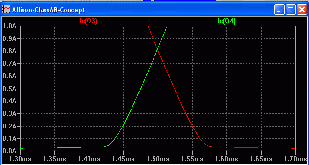

Also attached is a simulation of the currents in the two output transistors during crossover. Note that they don't turn off (though the Schottky diodes will).
After experimenting with this idea for a while, I had a better idea! Continued in Part 4.

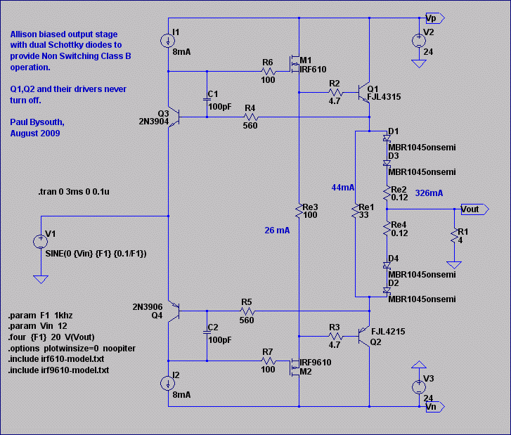

My favorite Allison circuits - part 4
When I was experimenting with the circuit in Part 3, I decided that if a pair of Schottky diodes was a good thing, then two pairs should be even better!
See the attachment for the concept.
Note that the output transistors never turn off, but the Schottky diodes will. Adjust Re to set a suitable bias current. As the Schottky diodes heat up, the bias current will increase (but not run away). Thermally bonding the diodes to Q3,Q4 will produce a stable bias current. To126 transistors for Q3,Q4 would probably be easier (I'm planning to use ksc3503 and ksa1381). The temperatures of Q1, Q2, M1 and M2 have no effect on the bias current.
I'm currently working on a variation of this with a Bryston output stage, and its looking very promising. I've been able to include a current limiter to protect the transistors and diodes, and I've been able to tame the turn on transients. I'll publish the design once its built and tested.

Okay... Allison update!
I just found an awesome variation that sims spectacularly, of course.
I tried this on a whim, and discovered that the Jfets increase transconductance by a huge amount, apparently.
I added the Diamond input buffer just for kicks, and according to the simulator I get about 50Gohms input impedance... Better than my Fluke 8800A. This, with virtually no distortion at 100KHz. Bandwidth is 10MHz! It gets slowly less believable (but then how do the DMM manufacturers do it?). As Kenpeter said, the models probably don't take into account Jfet capacitance distortion though.
The second circuit is an adaptation to use only 2 CCSs, though it's not quite as good.
