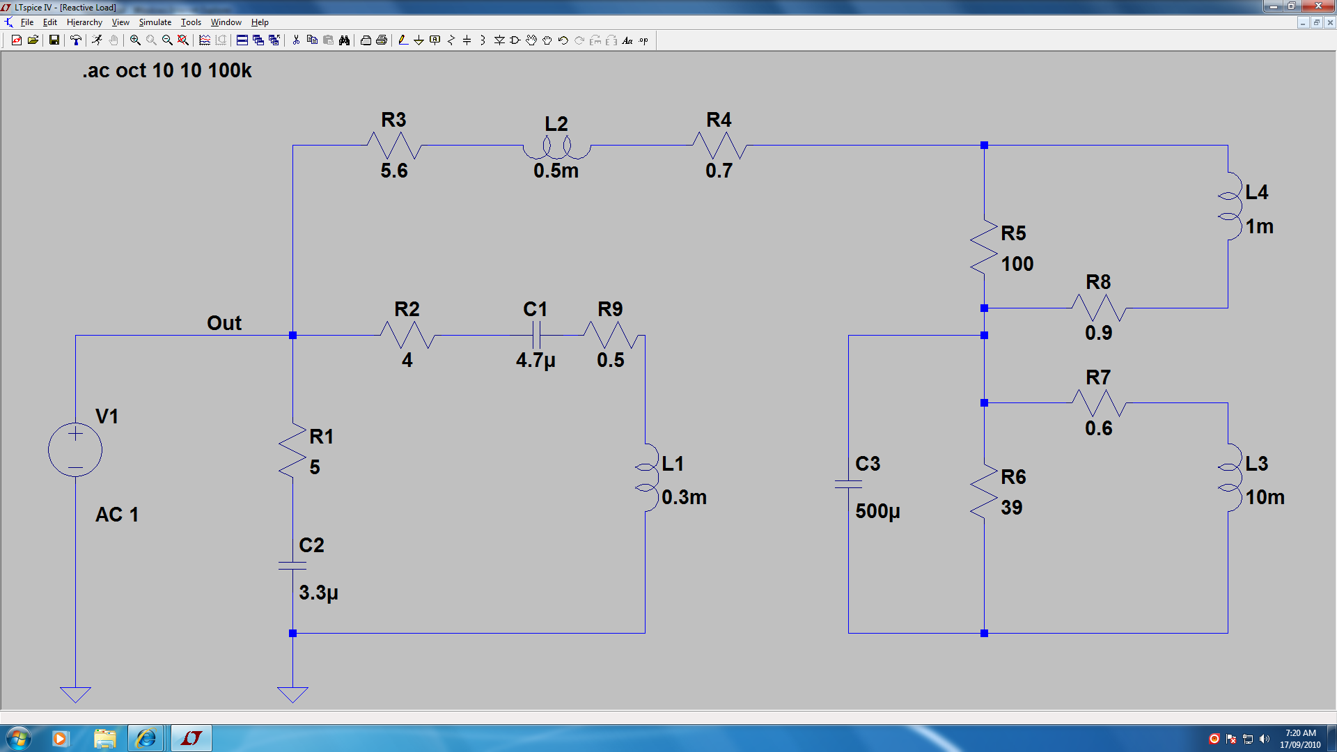

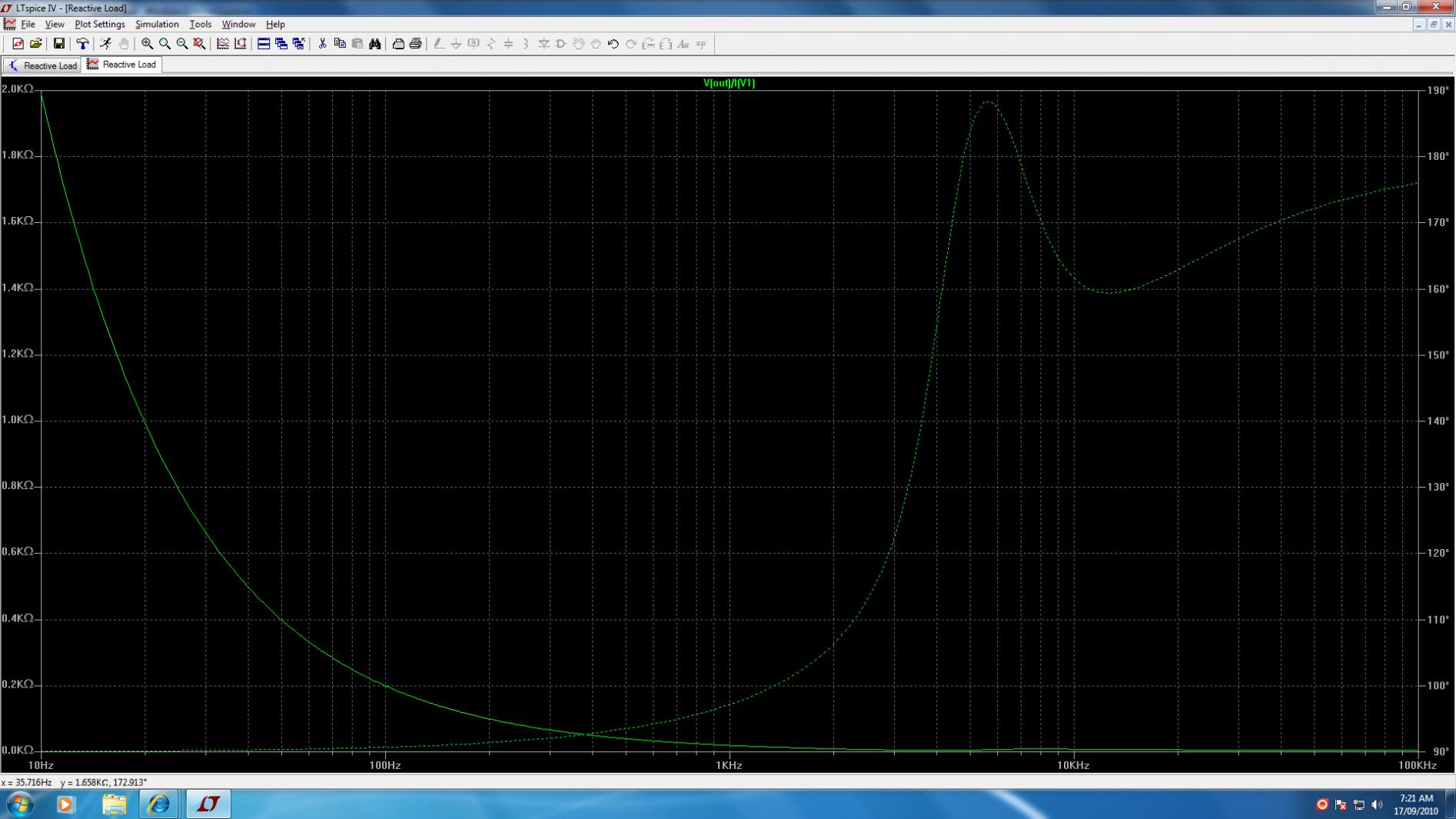

I am having trouble reproducing the same results of impedance and phase vs frequency that stereophile have published for the dummy speaker load.
Here is the link
Stereophile: Real-Life Measurements
See the attachments for my results
If anyone else is familiar with LTSPICE that can check this out to let me know if I or stereophile have made a mistake, I would be greatful.

generator output impedance is about 0.006R for the phase
response being the one displayed at stereophile..
That makes an amp with more than 1000 damping factor
at 8R load....
Did they test some SET with such "speaker equivalent load" ?...
The result should be intringuing...
Hi thanks for the reply. Would you or EUVL care to comment on wattage of resistors or heat sink size?
R1 5 ohm
R2 4 ohm
R3 5.6 ohm
R4 0.7 ohm
R5 100 ohm
R6 39 ohm
R7 0.6 ohm
R8 0.9 ohm
From EUVL's pic it looks like 63v electrolyptics are fine.
C1 4.7 uF
C2 3.3 uF
C3 500 uF
Wouldn't think gauge or esr would matter on the inductors.
L1 0.3 mH
L2 0.5 mH
L3 10 mH
L4 1 mH
Brad
