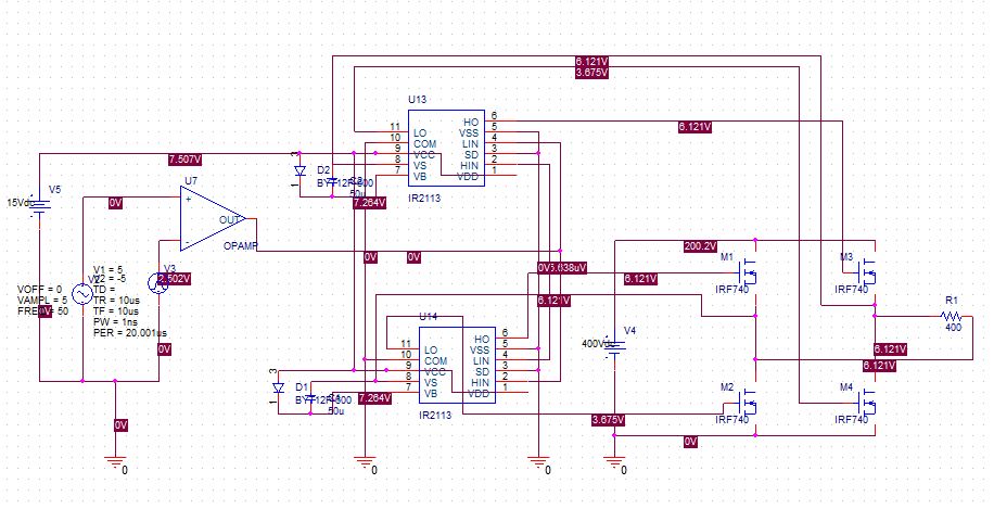

For my first thread I have decided to post one of my sideline projects instead of a purely audio related topic. This is very similar to what the class-D guys do so I was hoping some of you might help me out.
I am using OrCad Capture CIS 10.3 to simulate a ir2113 driving a full bridge inverter. The .lib file for the ir2113 was downloaded from International Rectifier website. I have allready built the circuit physically and it works perfectly.
However now that I am trying to simulate the circuit it keeps telling me that it has a "convergence problem in bias point calculation" and I cant figure out why. I have tried rebuilding the circuit with the minimum of components but to no avail. If I am making a connection error I am staring into my own error repeatedly.
Does anyone have any idea on what I am doing wrong?
