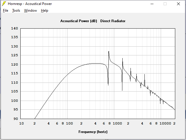

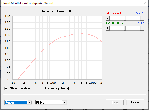

First I use Winisd to figure out a critically damped box size, and its potential maximum sound pressure.
Box size is 11,39 liters. Filter parameters are shown in diagram. System power is 130 W, cone excursion is xmax at 150 Hz.

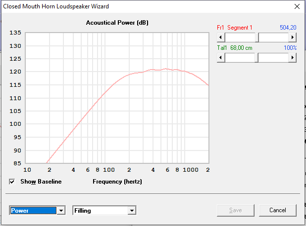

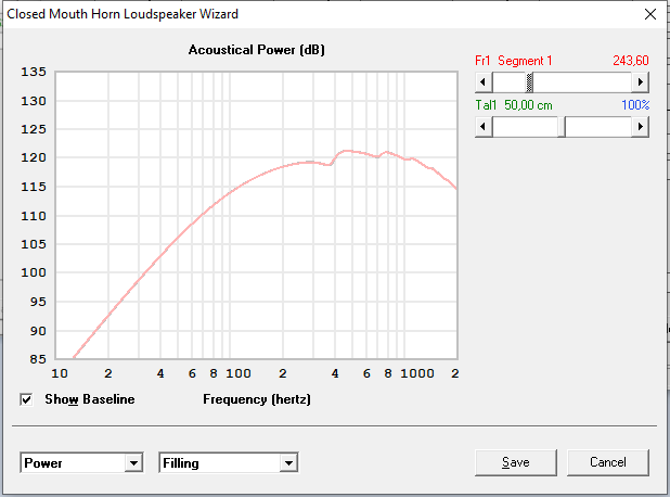

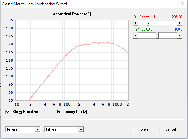

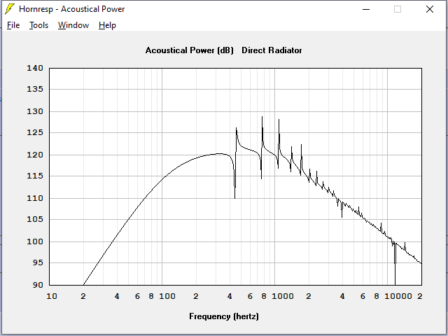

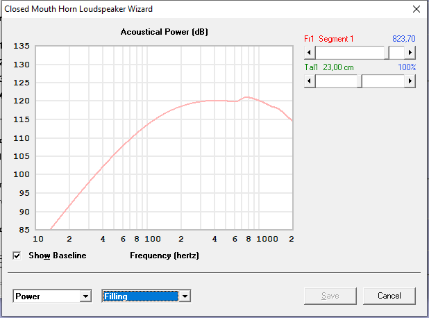

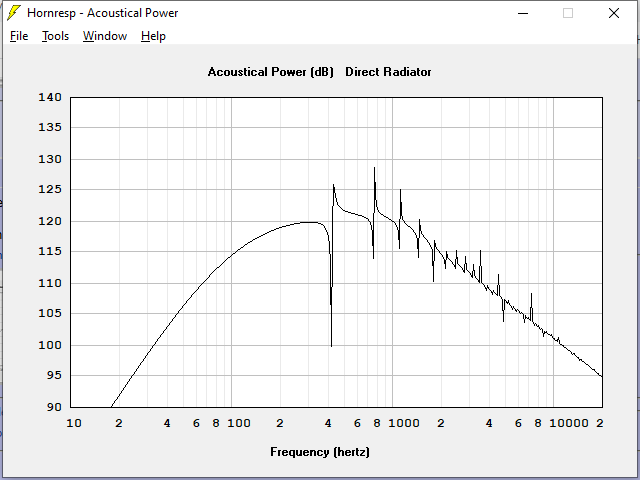

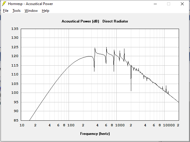

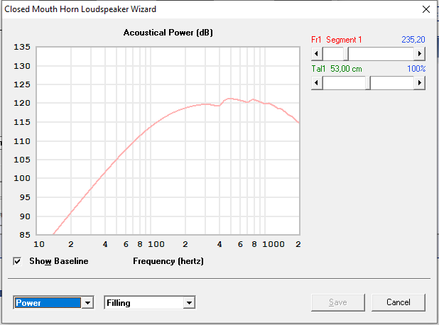

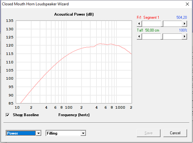

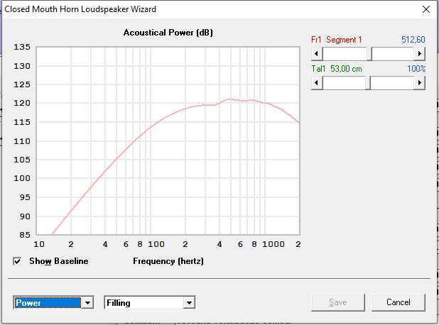

I have increased the filling to 500 mks rayls/m. Increasing above 500 has very little impact.

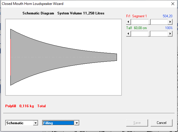

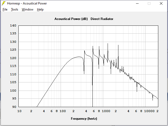

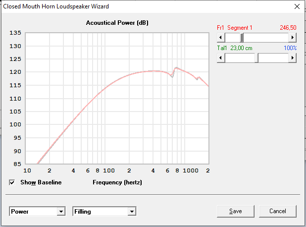

New curves and hornresp record with an equally large exponential dogbox.
This design is better than the others. 110 grams of filling in a 11 liter dogbox seems reasonable.
  • 10nmba520e.txt
