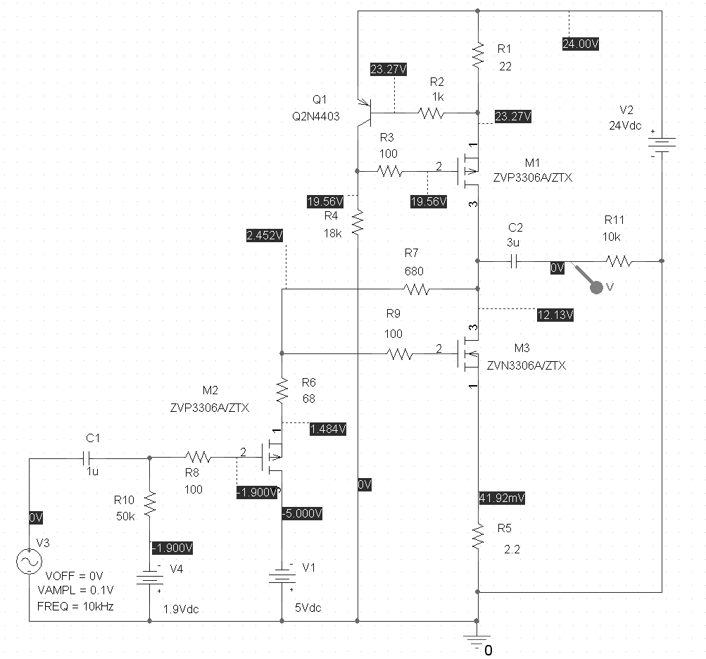

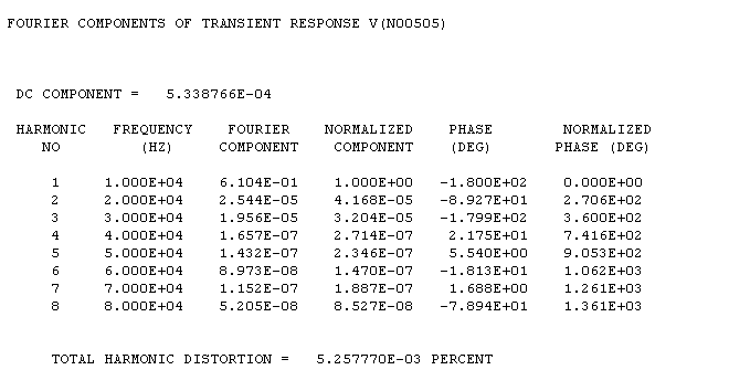

On a speculative note, here's the second "buffered SIT" circuit configured as a line amp. Gain is ~6X, and distortion is not too shabby... Some folks might like this simpler circuit.
