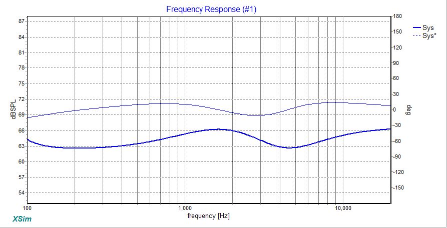

I find it a lot easier to explain theory with working models. Been having some discussions about speaker impedance, and the interaction with amplifiers. So I used XSim to build the Stereophile simulated 2-way speaker load:
Real-Life Measurements | Stereophile.com
I exported the system Z file, and then used that ZMA file to create a simulated driver with ideal FR.
Now I can use this to simulate amplifiers with different output Z and show how this affects the total system response.
Admin: Sorry if this is in the wrong place. Not sure who would be most interested. 🙂
I include my source docs so please feel free to enhance, correct, etc.
