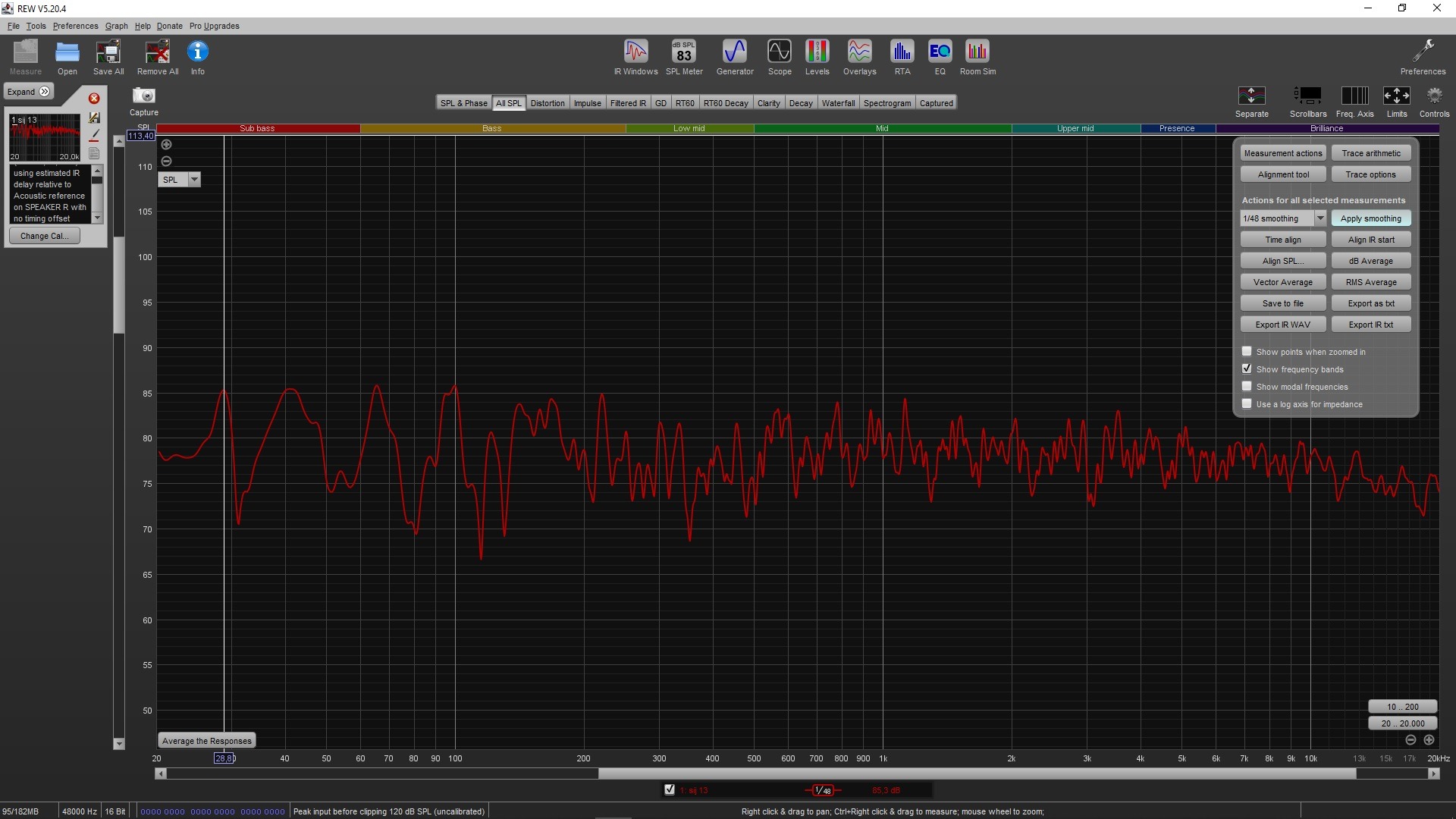

Since they are large panels, the measurement in the room was made at the listening position, I think the system is quite good and I can clearly distinguish the differences in components and cables, Teac did not sit in this kind of system, it is possible that it could suit someone who has a softer sound system with with its timbre.

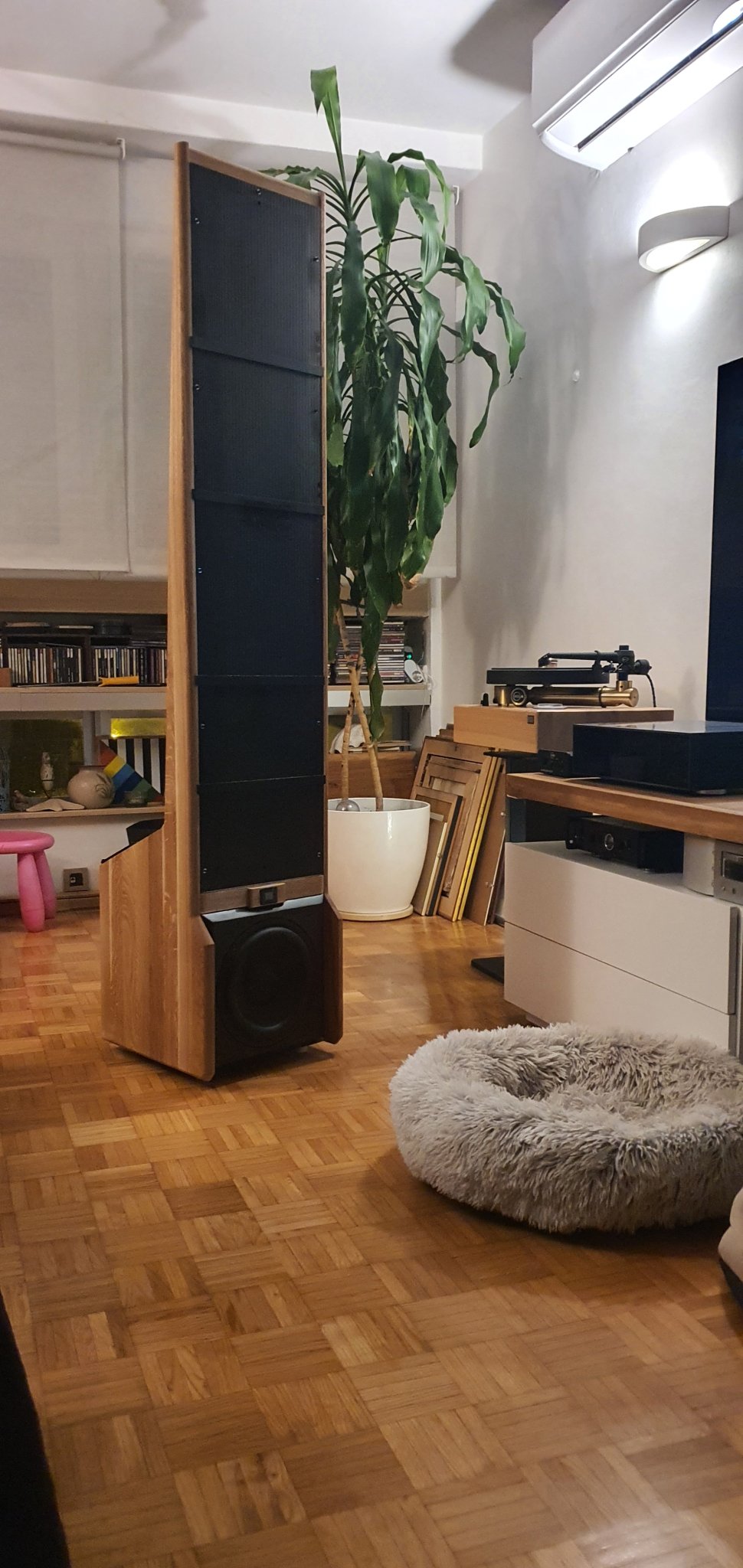

We often listen together. Both in the lap.What your Pug dog says? I see listening calm to the electrostatics. Must be enjoying the UFSP too.🙂
However, occasionally I have a problem with their snoring while they sleep, so the music gets noisy...hahahaha
They definitely enjoy Ultra
Exactly, it is interesting that even today with the KLIPPEL audio measurement system we get unusual measurement results, which do not match the auditory experience of such a speaker, probably because there is no line-type measuring microphone, but only a piston (point type).Čak i za male panele radi isto. Nedavno sam mjerio Magneplanar LRS+ kod prijatelja, mikrofon u bliskom polju ne govori ništa korisno.

I made another pair of speakers out of Magnepan 1.6qr with integrated sub and Hypex FE 203 amp.

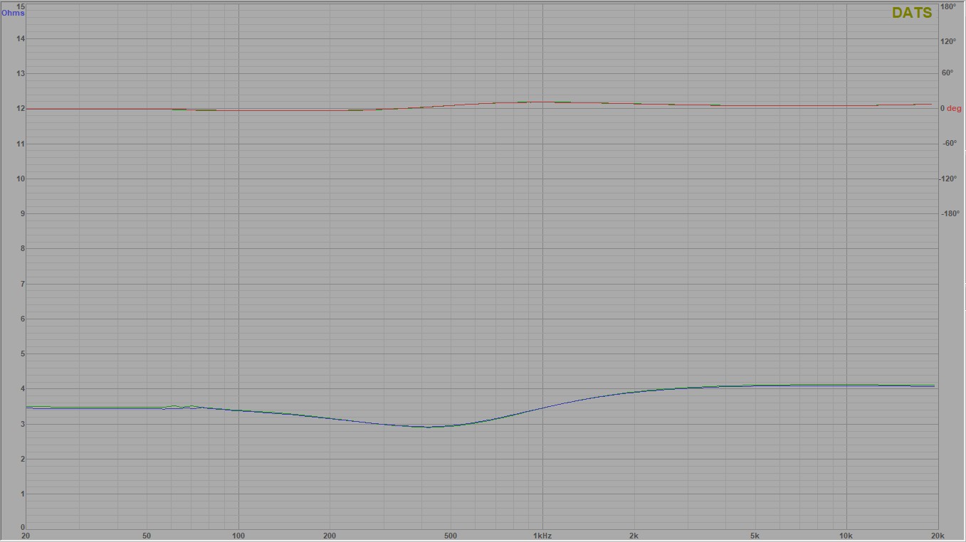

They are very good for up to 25m2 rooms I think. Going down to 55Hz then falling like a rock of course. But within their bandwidth and loudness envelope coherent and smooth. Need 10cm elevation feet to listen straight, else when directly on the floor their factory set back angle is well chosen for 2-3m away listening position. Don't believe 86dB sensitivity, that's some spot frequency 2.83V estimation, they are roughly as sensitive as a BBC LS3/5A in practice. Heavy load, dips little under 3Ω. I have seen it soaking 200W+ peaks.
