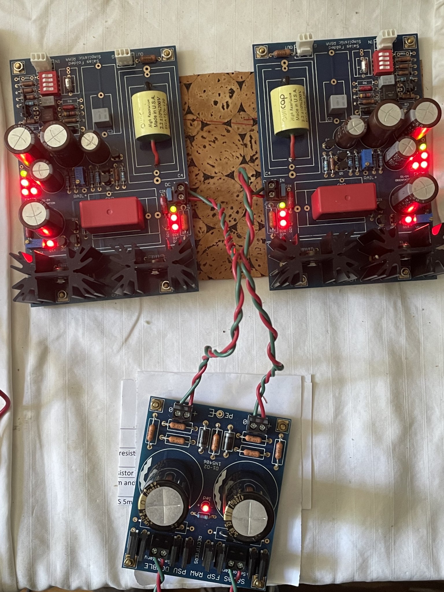

I recently powered up and biased some FSP circuits that I put together a few years ago. These are the blue boards with the Raw power supply board from a Tea-Bag group buy. I set them up for use with MM cartridges.
For the time being, I am using a single Hammond 182M15 transformer, 80VA with dual 15V secondaries in series. I used the build guide instructions to bias the boards. Here are the numbers that I am getting:
Unloaded Raw: L= 44.8 VDC; R 45.4 VDC
Biased boards:
Left channel: R+-G=32.88 V; T1-T2=3.596 V; Raw= 42.5 V
Right channel: R+-G=32.88 V; T1-T2=3.596 V; Raw=42.4 V
How do these numbers look? Should I try to raise R+-G above 33V by playing with VR2X? Do I need to measure/verify anything else before proceeding to hook up audio and installing it in a chassis.
Thanks.

Oops. Slight error in my description. I mixed up L and R. So the numbers listed for L channel are actually the R channel and vice-versa (left and right as pictured).
Hi, your raw dc and rail voltages are good. The rail level adjustment criterion is correct TP1-TP2 voltage. Rail for correct TP usually ends up lower when set for MM than for MC.
Thanks. So I am good to go.Hi, your raw dc and rail voltages are good. The rail level adjustment criterion is correct TP1-TP2 voltage.
Don't know about that single Hammond transformer with a serialized secondary shared between two PSUs diode bridges though. If such an arrangement will cause noise or something. FSP has been made with dual smaller 15+15 in series or single bigger 32+32 independent. No posted experience with a single 15+15 in series shared Tx. Anyway, you will see what happens.Thanks. So I am good to go.
