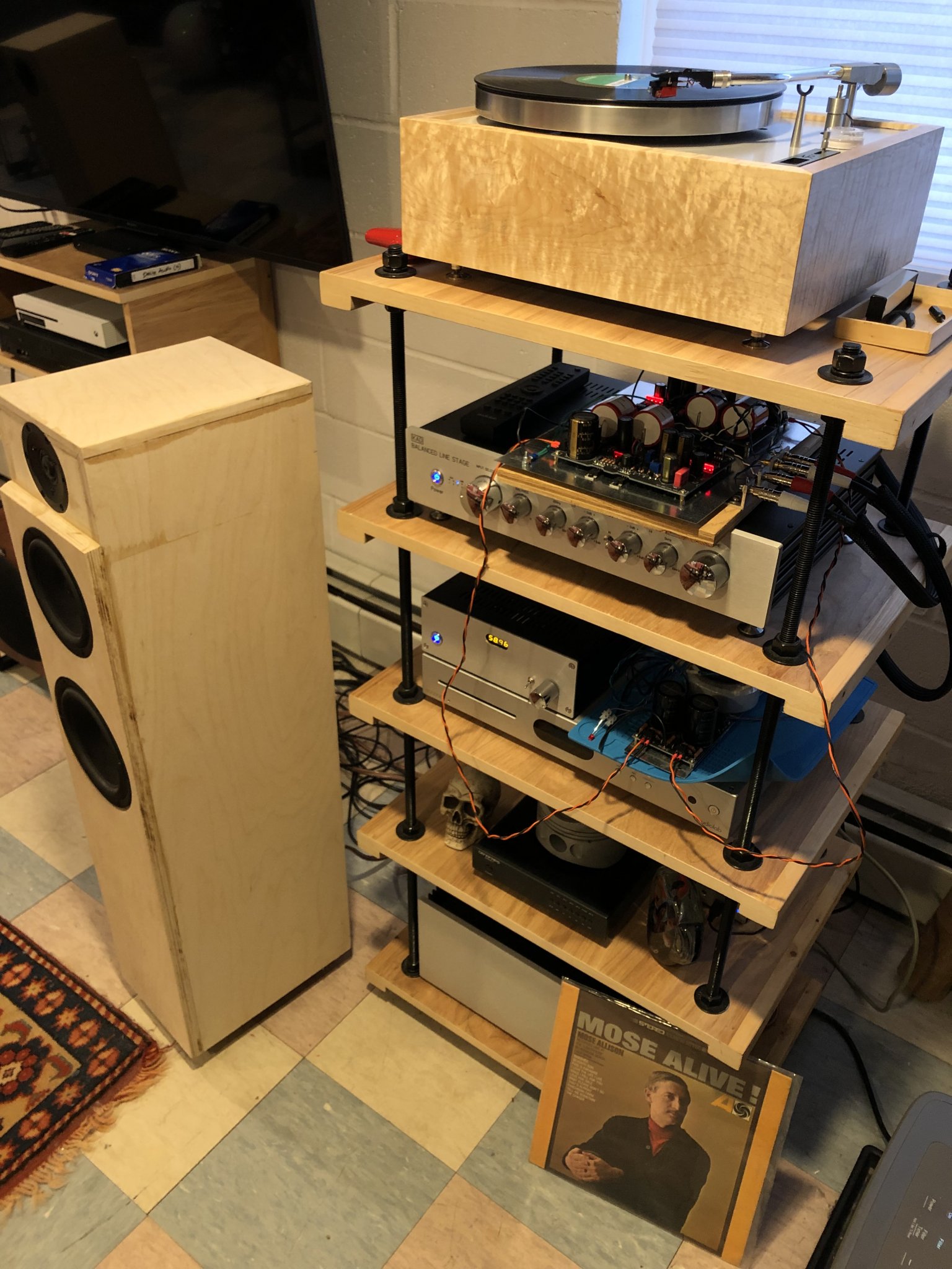

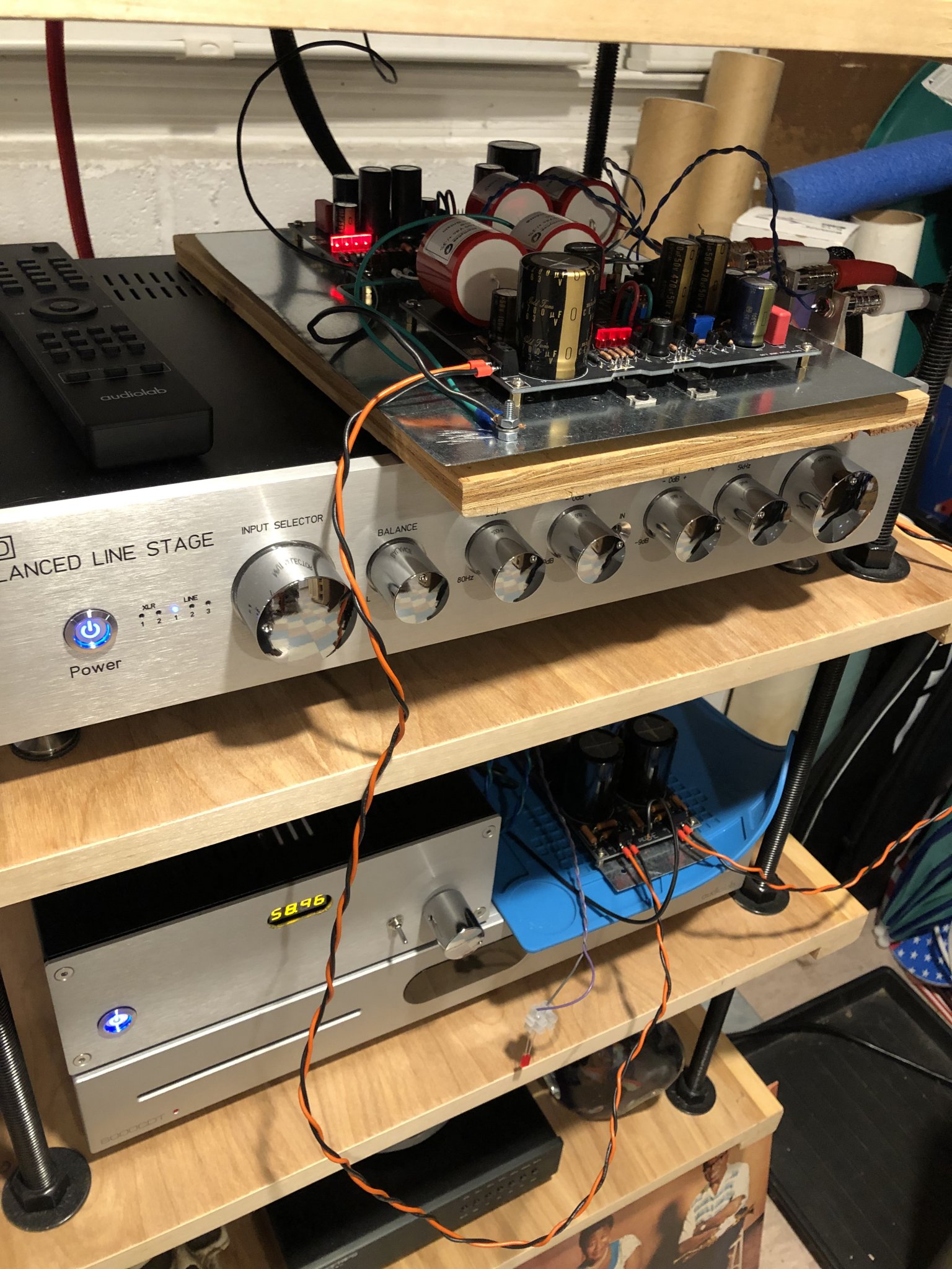

The UltraFSP lives! And might I say, WOW! Even through I have it nested in a rats nest of wires in my rack, this thing is quiet. The sound is big, crystal clear and, well, luscious. I am running my restomodded AR-XB with an ATVM540ML into it. S8 and S12 are ON for 40db of gain. RAW puts out around 50v with the Antek 0532. I have the UltraBiB set to ~33v to achieve 4v at TP. Setup was easy and quick. Now to box it up in something worthy of a performance like this.
Salas - This is a masterpiece of diy kit.

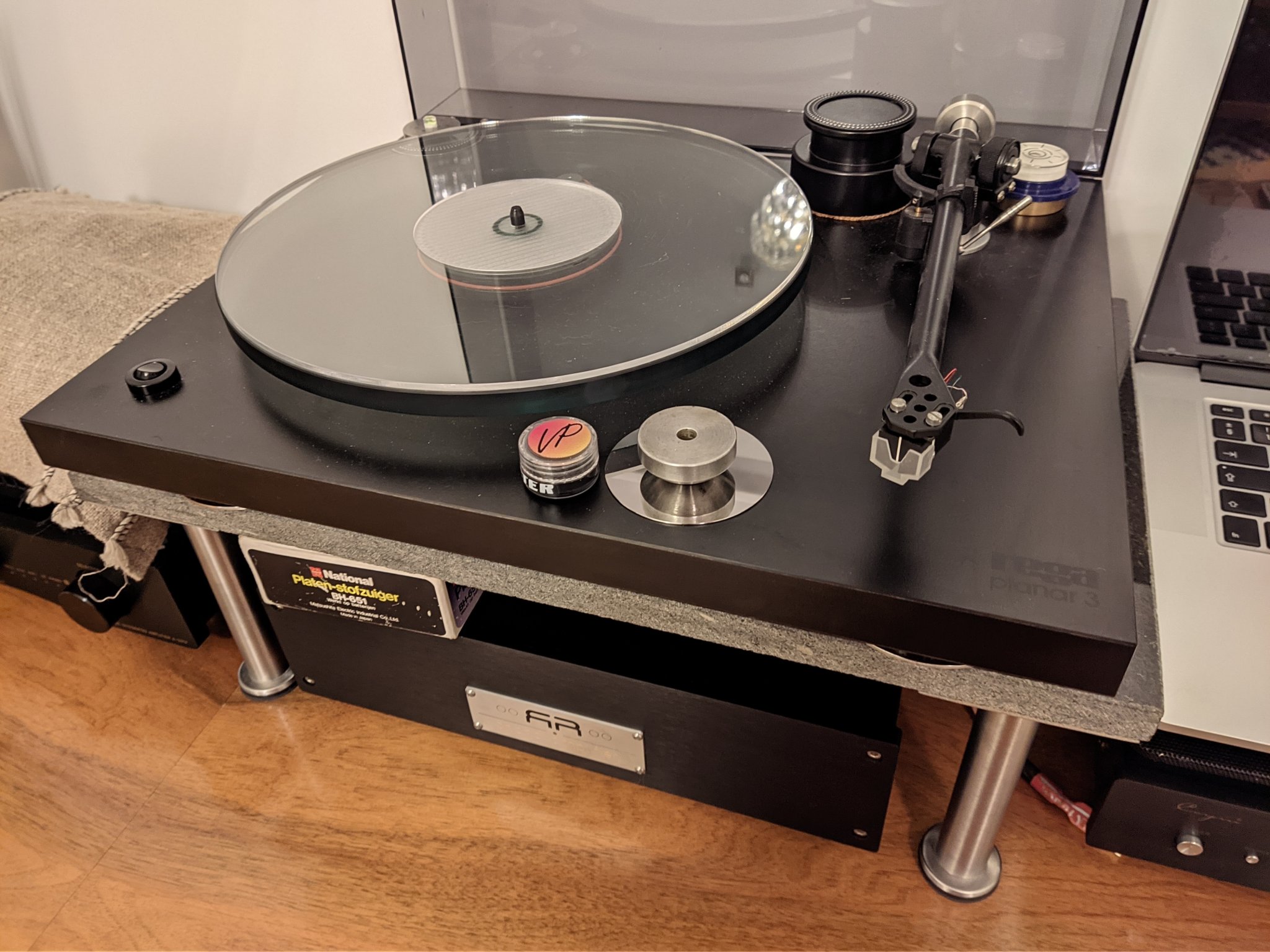

Hello Mr. Salas,
my turntable is modded Rega Planar 3 with motor fitted and separated on a slab of steel, rewired tonearm, main shaft ruby bearing, silicone belt, acryl slipmat and a Denon 103 MC cart. Used regular mic cable to record from Phono pre to Mackbook pro audio input via Audacity software.
Sennheiser HD-600! Impressive! Was about to ask You what kind of speakers are so revealing ;}

Congratulations :up: And thanks.
50V Raw DC from a 0532 TX sounds bit high. Maybe measured before loaded (before connected to the shunt reg)?
That modded Acoustic Research turntable is massive! What are the speakers? Troels inspired?
Hello Mr. Salas,
Sounds clear and rhythmic. The mods must be successful.
To give good opinion on line level captured files from an unknown system I take out my side of speakers-room equation also. Headphones although don't recreate regular stereo recordings space as intended, are more direct for details. Fewer acoustics to interact.
Correct, 50v before being loaded…. The AR is 5” high! I like curly maple 😂…. I have parts for another AR build, but I may end up cannibalizing a Technics SL-Q2 I have instead, which would include an SME 3009 tonearm I have my sights on… The speakers are Troels‘ SBA-761 design. Those speakers have a sweet, wide soundstage in my room (they totally disappear in my room), and I really like them. Having said that, I am looking around for my next speaker build, which will be horns.
How high is your Raw DC if you measure on its connector while running the phono? Want to see if safe in the long term for the reg's J1.
Troels does not advise rounding off the ledge in the tweeter's vicinity or some felt to lessen possible diffraction?
Oh no, I hope it’s not too high - I get 42.3v on the RAW connector with everything wired, on and warmed up: RAW + Shunt + Signal Board…. Troels‘ plan calls for a 15 degree angle cut on the lower baffle perimeter. Odd, I know, but I stuck to his plan and it works well in my room.
