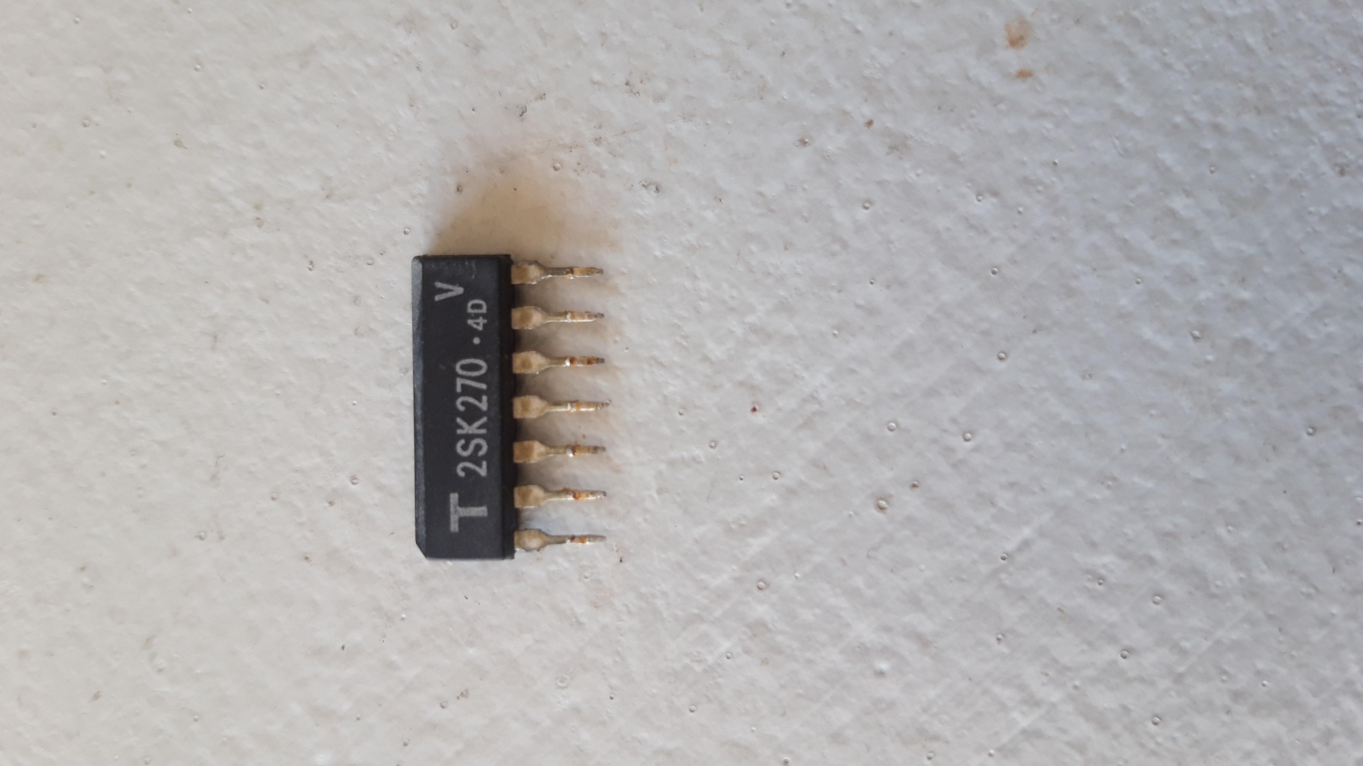

Hi ! I would like to build this pre amp for my turntable, but i only have 2 original 2sk170, but i have 2 2sk270, wich i think it is 2 2sk170 in the same case, and also have 2sk240, 2sk129a,and 2sk389, so wich one of this
ones are better for this MM preamp ?

Hi, I only knew of 2SK389 for monolithic 2SK170 pair with claw like pins until now. This 2SK270 in this flat 7 in line pins package I didn't know about it. Can it be a Japanese only version or a relabeled uPA series NEC? I would use 2SK389 if it was me to be sure. You also need 2SK369 for the better FSP & UFSP schematics input stage. Having to make your own board of course because such dual packages don't fit the official FSP or UFSP boards.

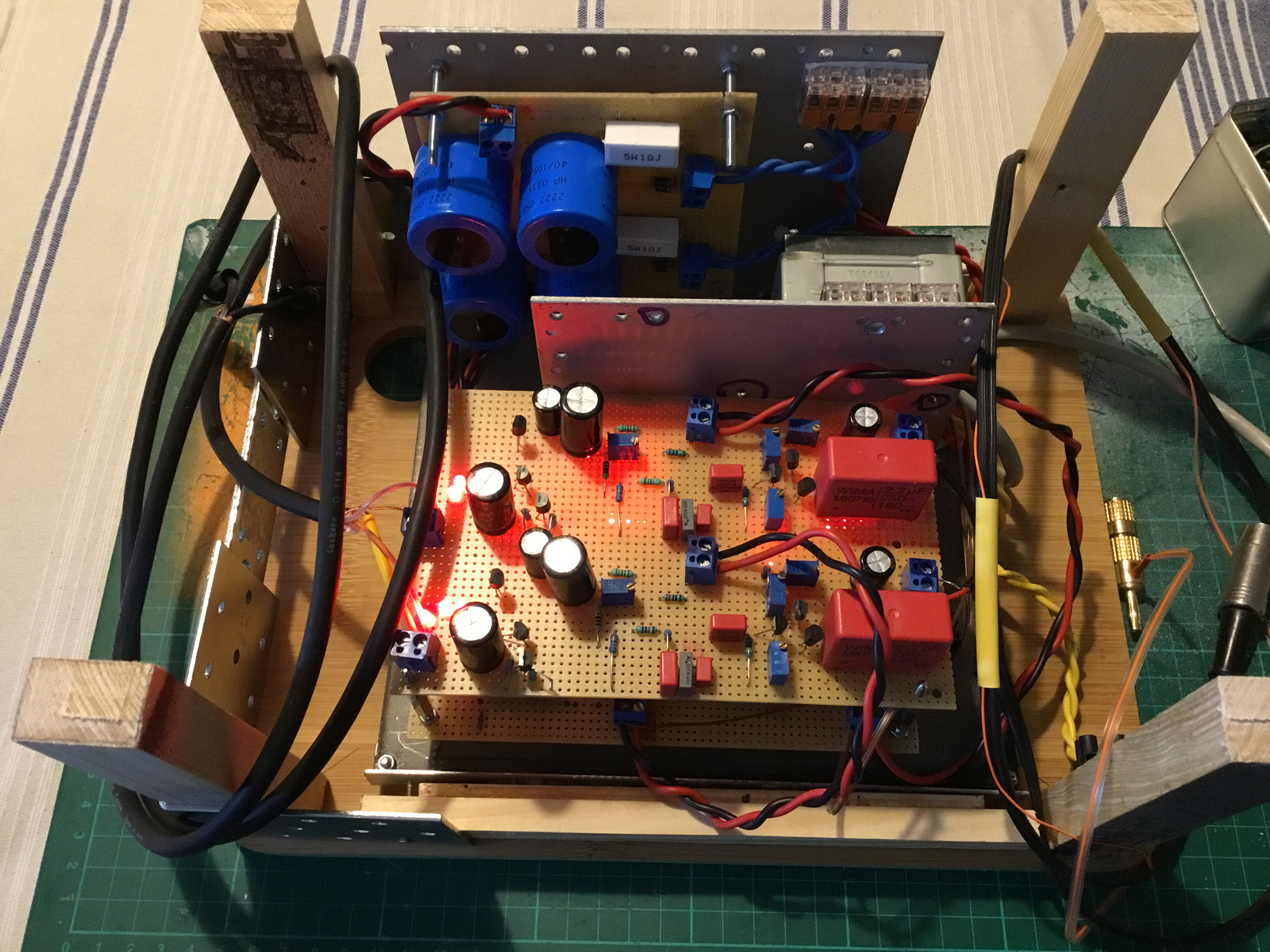

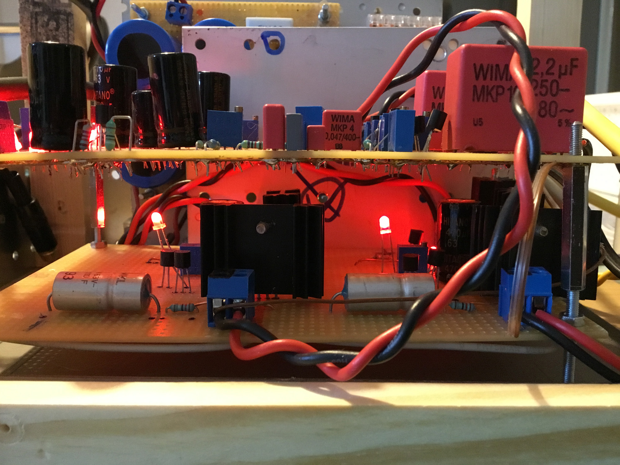

hi.
when I started this project it was March 2013 (post 12265).
I abandoned it several times because I noticed a background noise (grounding noise) that I could not eliminate or at least dampen.
during these many months of "forced closing" I removed all the automatisms of a Dual 1219 that did not work properly (but it has always been my worm to make a Dual completely manual) and on this occasion I rewired the arm: 2 channels + the grounding of the arm.
then separate RCA and grounding.
Nick's NJFET RIAA was pulled out of stock and connected to the modified Dual.
finally it sounds without noise problems.
I always thought that I was wrong or that I was continuing to make mistakes while the ground loop was caused by the wiring of the Dual.
it took me exactly 8 years.

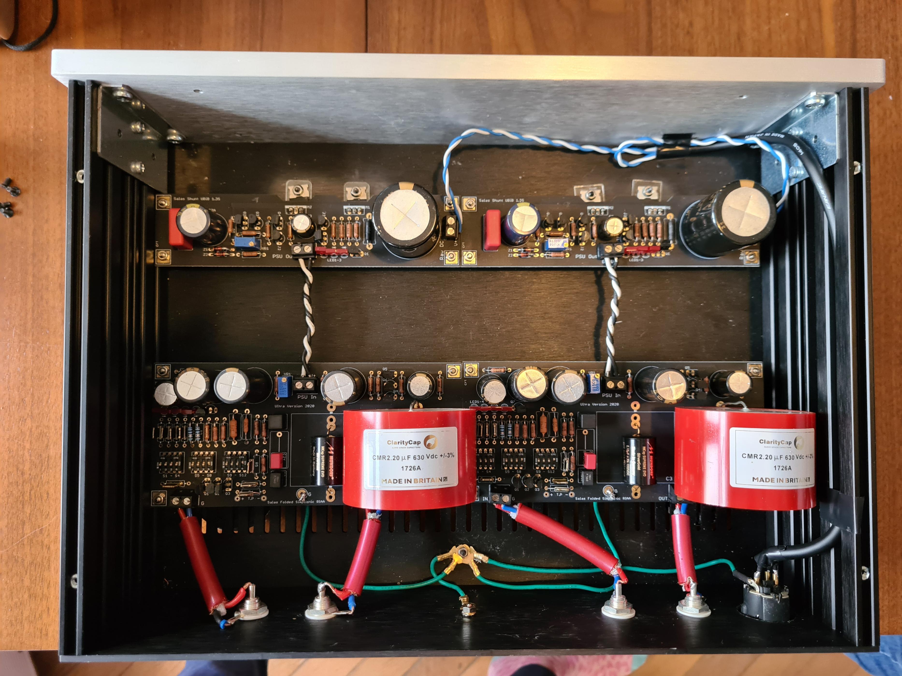

I finished mine a week or two ago now and have been enjoying it ever since, it really does sound very good, night and day stuff to the basic one I had before. I've spent a fair bit of time reading this thread over the last few months, without the information here I'd have really struggled and also without Salas's help as well!
As someone who hasn't soldered a circuit board or built anything which wasn't a speaker in 20 years, pictures were surprisingly helpful. So here's one of my UFSP, and if the picture of the layout helps someone I'm very glad for that. Mine is in a Modushop Galaxy 2U -330 x 230mm and thinner signal cable would have been simpler!
Thanks to all involved guys, it's been a great thing to do while stuck inside recently.
